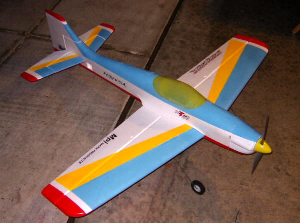

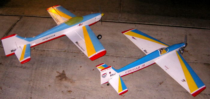

I received a Formosa-II pre-production sample from Mr. Lin (CEO of GWS) in iHobby show, LA in October. I finally got it done during the Thanksgiving weekend. Here are few pictures together with my other engine power airplane just for caomparison. The Formosa-II is designed for aerobatic-3D flight, but Mr. Lin wants me to expolre its pattern flight capability, so I will post my test results later.
The size is about the same as a 30 size glow engine power airplane, I don't expect it will be as sharp as those purpose-designed e-patternship, but I will try how far it can go.
Power is a Himax HC3510 brushless outter runner, Phoenix 25 ESC, 3S Li-Po, APC 10X5E. Any comments are welcome.

Nice finish job! Is that paint or decals? Looking forward to that flight report - with video I hope!

It's Testors spray paint (3 Oz can) for plastic models (also works for styrofoam). It took more than 48 hours before I could apply mask tape for the next color.

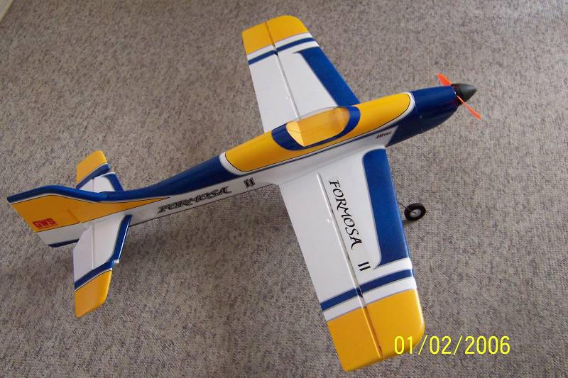

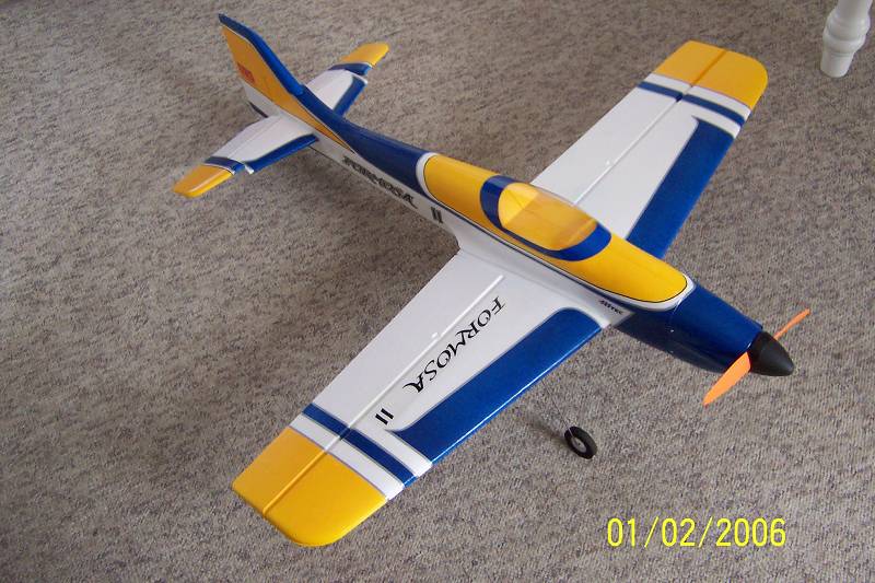

I had to build a Formosa II They look fantastic, and I got it for free from my brother. I am looking forward to better weather to fly it and put it through some paces. The paint job in this thread inspired me to take some time and make mine look good. Is there anyone out there who is using the stock reccomended power set up?
For sports fly, the original twin-350 works fine. However, it is somewhat under power for advanced aerobatics.
