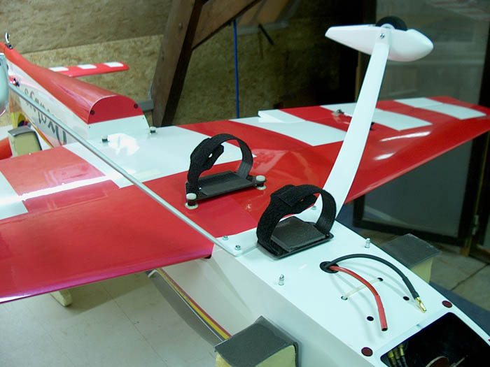

Winfried, this year Chad and I discovered what may be the simplest and most minimal battery mount. The two packs are held together with outer strapping of velcro or tape. The pair of packs has two small pieces of velcro on the outside surface that mates with two small strips of velcro on the mounting plate (permanently installed). Two outer straps of velcro hold the packs down against the plate. This allows lots of freedom to set the packs forward or backward to adjust CofG, but holds them firmly in position once strapped in.
For our Twisters we are going to add a second landing gear brace in front of the real one. Then a wood plate is set and glued on top of those braces, that spans the area between them. The plate will have strips of velcro, the packs will have strips of velcro, and there will be two velcro straps around the plate and pack to hold it down.

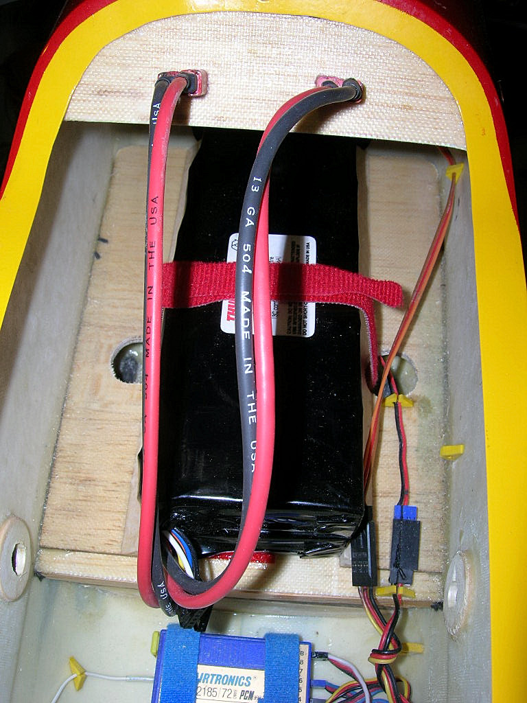

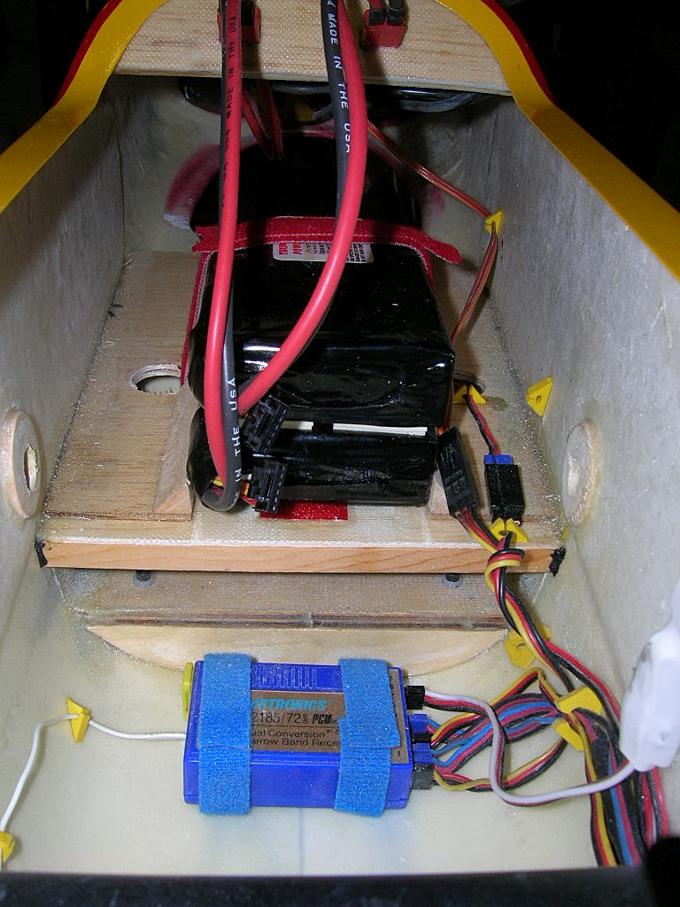

This is actually a good idea for a thread. I couldn't find much about mounting the batteries when I was doing it.
Mine is sort of similar to what Adam is talking about. Here's pics.
Chris
Chris

Winfried
Doesn't it concern you that there will be a lot of weight in the belly of the plane. That IMO would affect knife edge, rolling manuvers, and also verticals.
I found this out flying alot of foamies. As example if you were hovering a plane and had alot of weight in the belly it would want to fall out and would require up elevator to sustain a vertical hover.
I also feel that having to turn the plane over to remove batteries would be uneasy. Although, I don't believe you have a removable canopy. Not sure about the oxalys. If I switch to the 3700's at some point I may have to go in through the chin cowl.
I would be curious to see how it affects flight.
Just giving you something to think about.
Nice plane!!!
Chris
