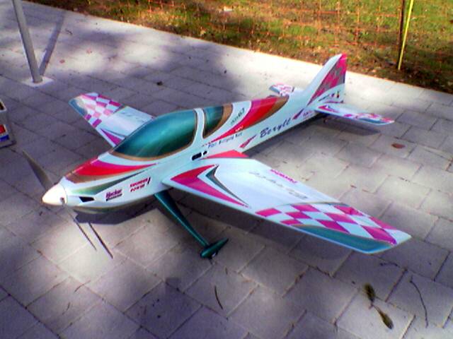

PS: spy shot (lousy handy camera) of the new Liechtenstein weapon...!
