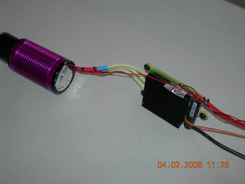

The temp rise after flight is normal, especially for an inrunner, as the thermal conduction path from magnets to outside world is primarily through the shaft and bearings. My AXI 5330/18 when run at 63A WOT lands at less than 15 F (7C) above ambient, with a post-landing dwell of about a minute, and then cooling. That's measured with an IR thremometer aimed at small black plastic tape tags on the motor case and winding, to get a well defined emissivity. Metal, even anodized aluminnum, reads low.

Dean, it sounds like you have it made. I take it the 15F rise was measured after landing. I'm using an EagleTree sensor on the back surface of the motor which probably gets the least airflow. The temp measured on the ESC never went over 71F.

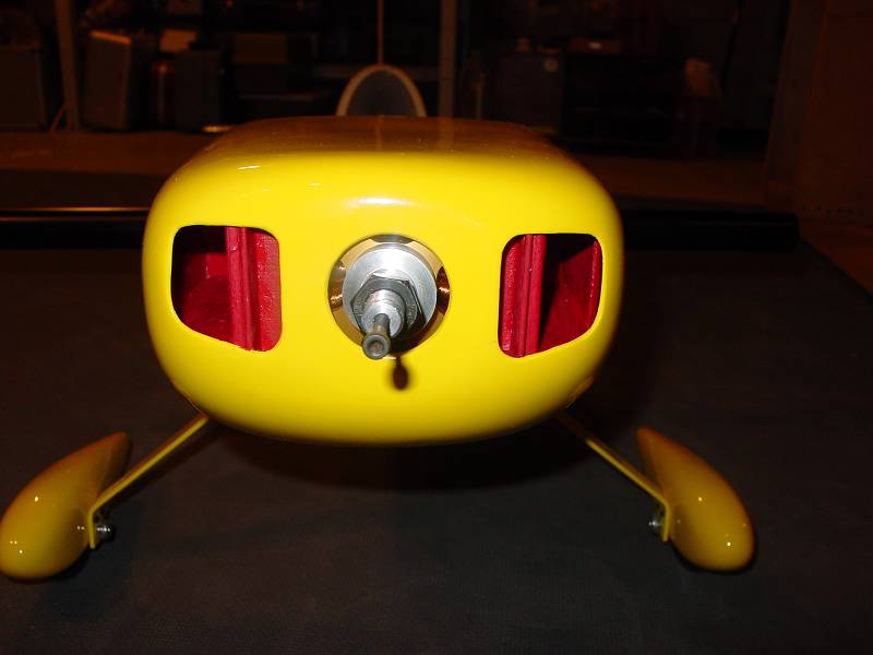

Yes, the ESC temps never seem to be a problem. Even the Castle HV45 handled flying in the mid sixty-amp neighborhood, just fine. It rose maybe 10C, though I have switched to the HV85, and can barely measure temp rises. It's well cooled, too. Have you seen the ductwork I have placed in the cowl of my Funtana testbed? Take a peek.
Dean
