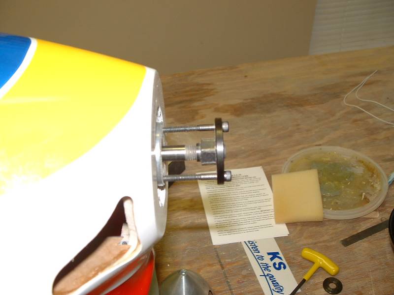

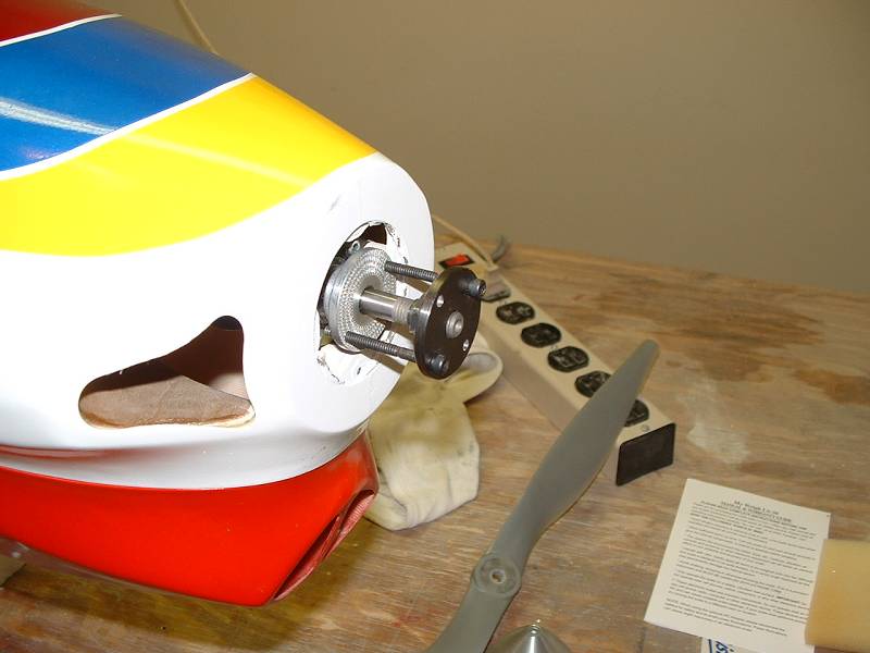

Attached are some photos of a simple to make Hacker C50 drive washer removal tool. I simply drill and tap the drive washer with #6-32 threads. A prop washer is drilled to use #6-32 soc. hd. cap screws.
