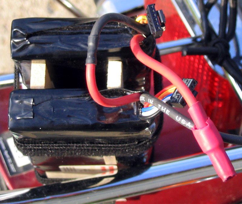

From the looks of your picture it appears that one pack is behind the other. You would need less supporting structure if they were side by side or one on top of the other. I have mine side to side with 1/4 inch balsa pieces glued between them to provide an air gap. A piece of 3mm carbon fiber/honycomg material provides the front support and the landing gear mounts support the rear. 2 pieces of balsa fiberglass composite glued to the bottom of the packs align the packs on the gear mount and prevent the packs from moving once they are snugged down with velcro. I use velcro cinch straps which I cut down in width and length to make them lighter. They provide a very tight mounting. Changing the position of the balsa fiberglass laminate sticks (actually I added a third) allows me to shift the CG.

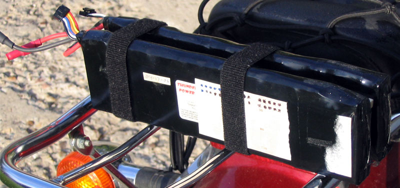

Here are the first batch of pics I took of my Twister, and they include pics of the battery mounting area.
http://homepage.usask.ca/ajg360/Twister%2DAdam.zip
This was as close to copying Nedim Bek's battery mount as possible with materials I had. It is 1/4 balsa making up the two tray pieces, which interlock with light ply squares epoxied onto the inside fuselage wall. The 1/4 balsa is slit for the velcro straps. The 1/4 balsa has adhesive-backed velcro on its surface. The 1/4 balsa has been laminated on both sides with glass (no idea what weight cloth, but pretty light). Nedim used CF cloth, and I suspect it worked better, as I decided after feeling the strength to add a light ply former to the rear 1/4 balsa mount. This former is visible in the pics if you are looking for it. It is on the back edge and goes below the rear 1/4 mount.

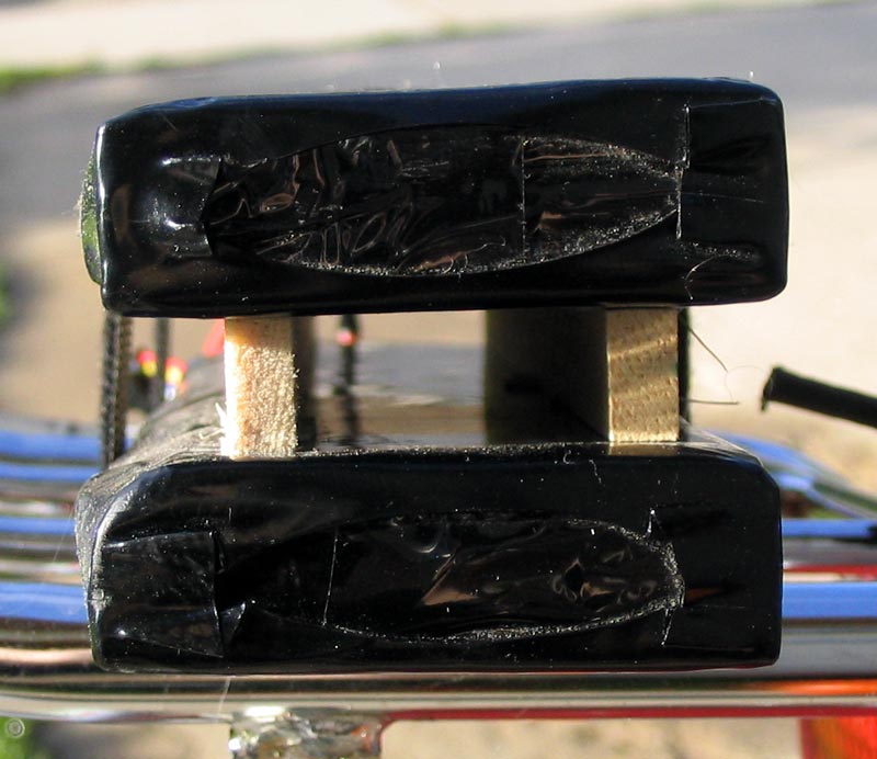

The 5s packs are seperated by 1/2" balsa strips, the strips are held in place by a little bit of doube sided tape, the packs are held together by wrapping velcro (sticky on one side, loopy on the other). Credit for this idea goes to Chad.

Yes Adam, the simplest ideas are the best. I have been baulking at fitting the spacers to the pack instead of the model as I have a hard carry case that I can fit 4 packs in if the 5S,s are side by side but not with the spacers fitted. But I guess the spacers could be velcroed in too.
