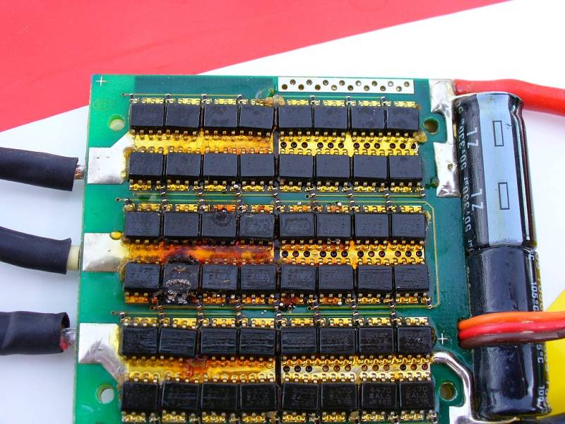

hi today i was flying my genesis witha cyclone engine, and about at the mid of the flight at mid trholtle the engine stop, y land , and the engine was dead, i look the speed controller and i foyun that was blow out, look at the pics
any info about that , wath could be the problem???
the engine with the bateries tp 5000 extreme and apc 20x13 at full throtle is about 74 amp
so wen this hapend the engine was at midle and 5 minutes of flight
thanks ijn advance
marcelo

Assuming that the ESC is spec'd for 75-100 amps,the most likely culpritis a short developing somewhere. Possibly in the motr which is going to be hard to check out.
And, of course, could be a rare malfunctuin within the ESC.
Happy hunting.

Like stated before a short or a over amping issue in a long vertical pull or if poor cooling to the controller. Maybe you can send back and get it covered under warranty.

hi scoot thank for your info but i was in a midle off a verticul up line at half trotle,
but some time wen i was flying the engine stop and i have to gow down with the trim and start again, i look for the esc temp and was about 60 dregers celcius , not bad for summer here in argentina, also the max amp that i have was 74 at full trothle and full charge the batteries
any other suggestion??
thanks
marcelo

I would say the 60c is the problem, did a quick conversion and that is 140F Way to hot !!! I fly a Castle Creations HV85 and it never gets past ambient temp.. I have flown in 100F temps and it does not get any hotter. I would look at better cooling or a different controller..
sounds like the over temp sensor was kicking in and thats why you lost the power and had to throttle back, or a over amp spike.

no i change because cyclone controller blow out like this , so i think that bthe proble could be in the engine??
