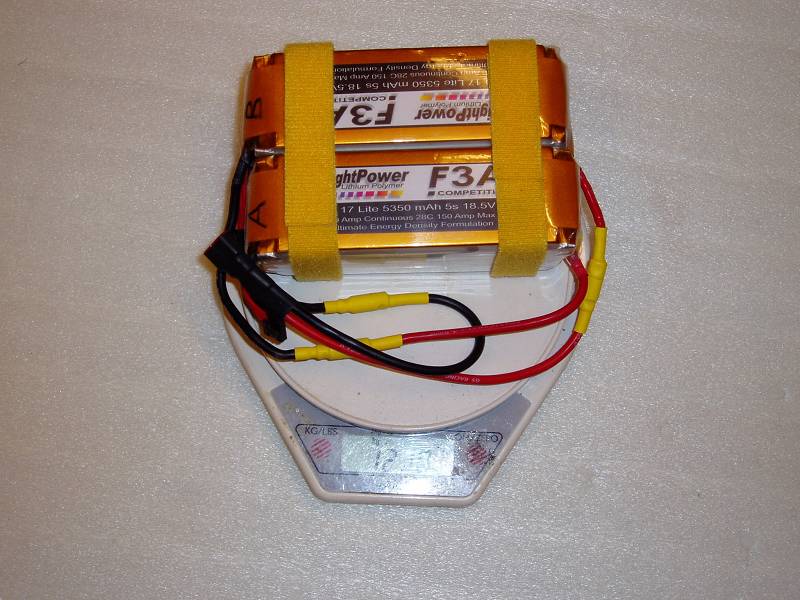

And I just weighed my FP 5350 F3A pack, total weight 1218 grams, with leads and plugs.
(This is how it came when I ordered it.)
