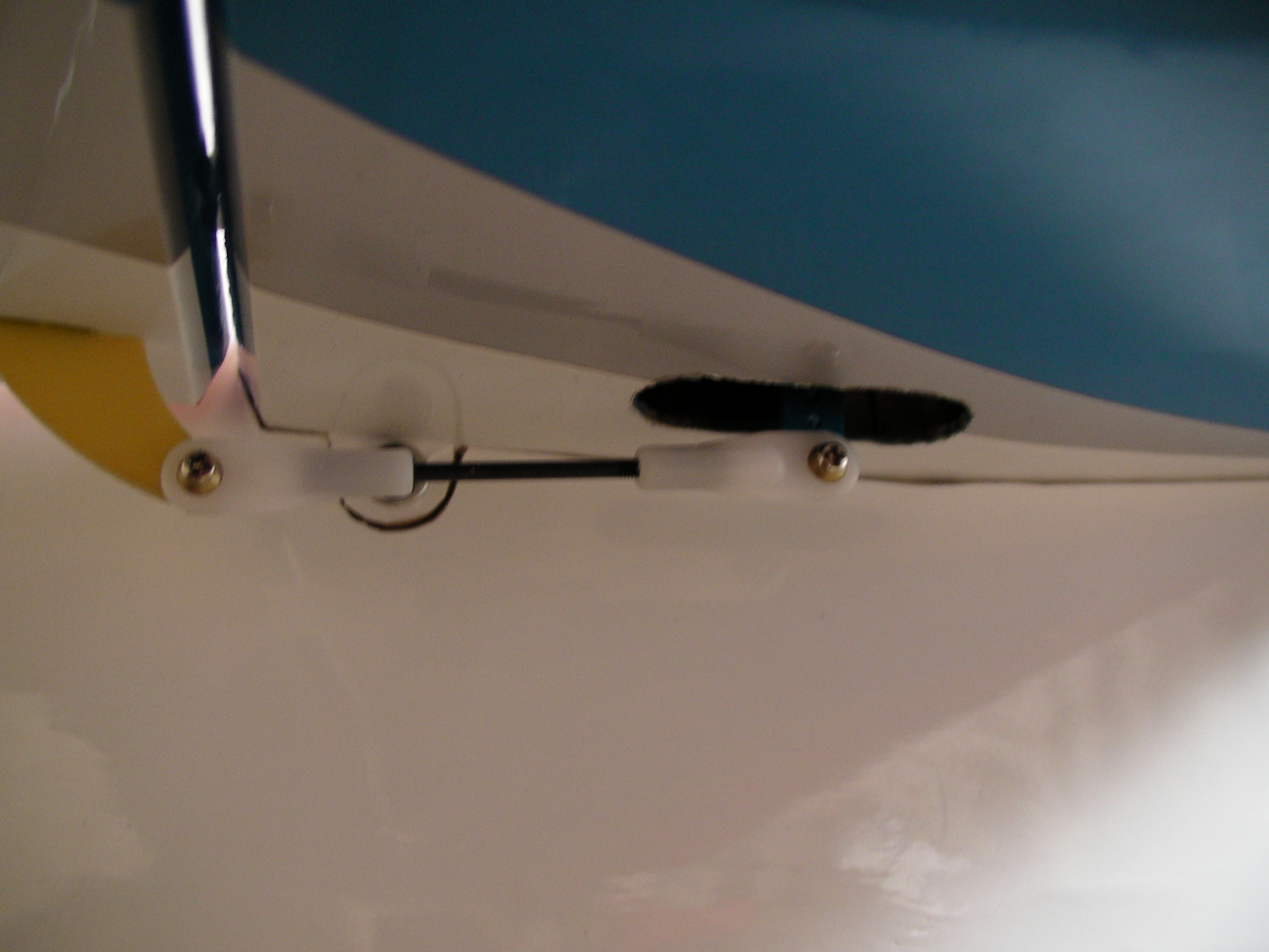

#1132
I use Hitec HS 5245MG's in stabs, openings must be enlarged by about 1,2 milimeters to every side in order to make them fit.
I am really happy in the way they perform @7 volts. They are a little sloppy when they are much used, but pretty good while new though.
For rudder I use 7965 MG and on ailerons- low profiled 7775 MG
I have not finished with the install yet, as it was trial to see how plane flies, I will be adding 2 indoor batteries for receiver power, and put wire mesh on wires to make them look like on my other planes
