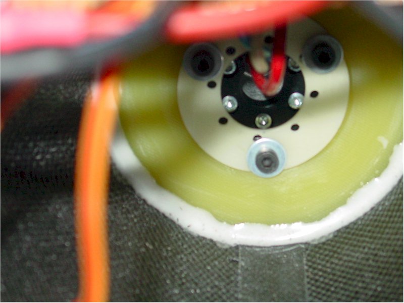

What I haven't found sofar is a clean picture of a install of a Pletty in the spinner. How strong should the nose be to take the load?

Hi Volkert,
One year ago I was in exactly the same situation, bought a Synergy from a fellow F3A flyer as a start with electrics. For me it seemed logical then to use the same mount and use the same engine, a Hacker C50. After one year of experience with the Hacker I am not sure if this was the best decision. You have read about it on the Dutch forum.

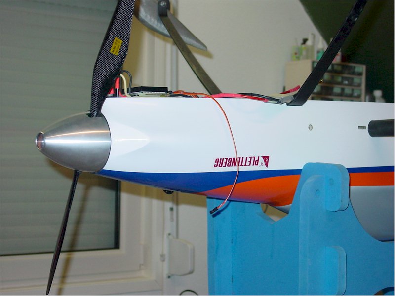

I'm preparing a new model with a Plettenberg for season 2009. Perhaps some picture are of help.
Hans

Hi Hans,
Looks like you may have to be very careful with your fuse length using that spinner/motor set-up. Might be pushing the 2 metre limit with some designs.

Hans, did you specificly strenghten the nose section? If so, in what way? Did you mount the engine on your Abbra or Synergy?

Hi Volkert, the model on the pictures is the ABBRA. The Synergy you have seen me flying with in Son, I was the only electric flyer, was equipped with the Hacker. On the pictures you can see the honycomb-plate to mount the controller. This plate has made the nose less prone to torsion. I hope that will be enough.

If you use a firewall mount like the way I do it then you don't need to add any additional strength. On my Integrals I used 1/4" lite-ply with carbon facing to make it a little more rigid. I have not used the motor in the spinner so I dont know if you need extra strength or not. I think the folding props reduce a lot of the forces on the airframe though, so its probably not as critical.
