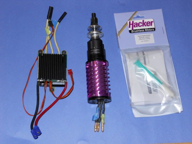

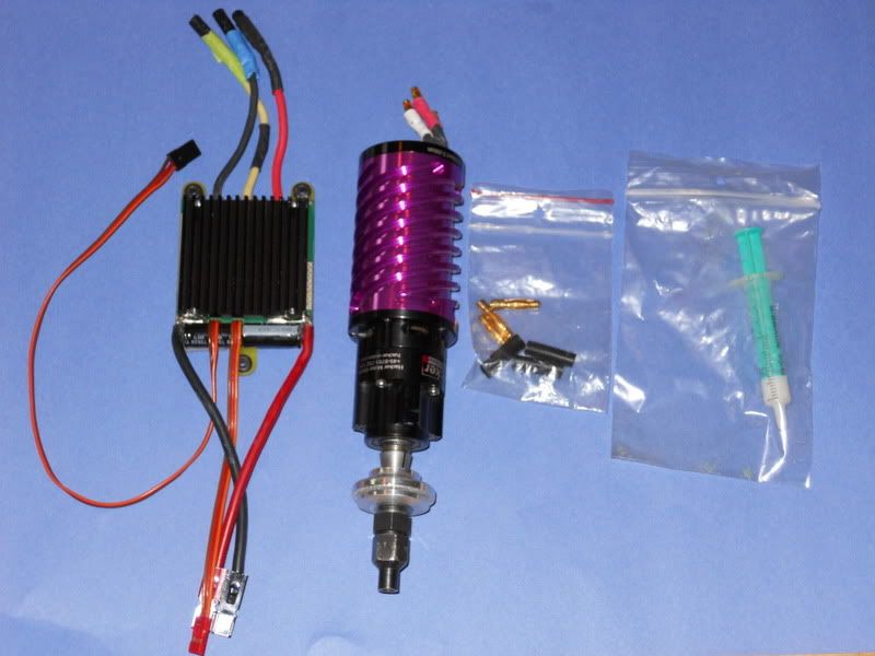

Is anyone still using this motor?
Reviving an old thread to see if folks are still using this motor. I have two C50-13XL Acro Comp motors and two Hacker Master Spin 99 escs that I'd like to turn into some cash, but I wonder if they have any value at all. Anyways just wondering.
Joe
Joe
