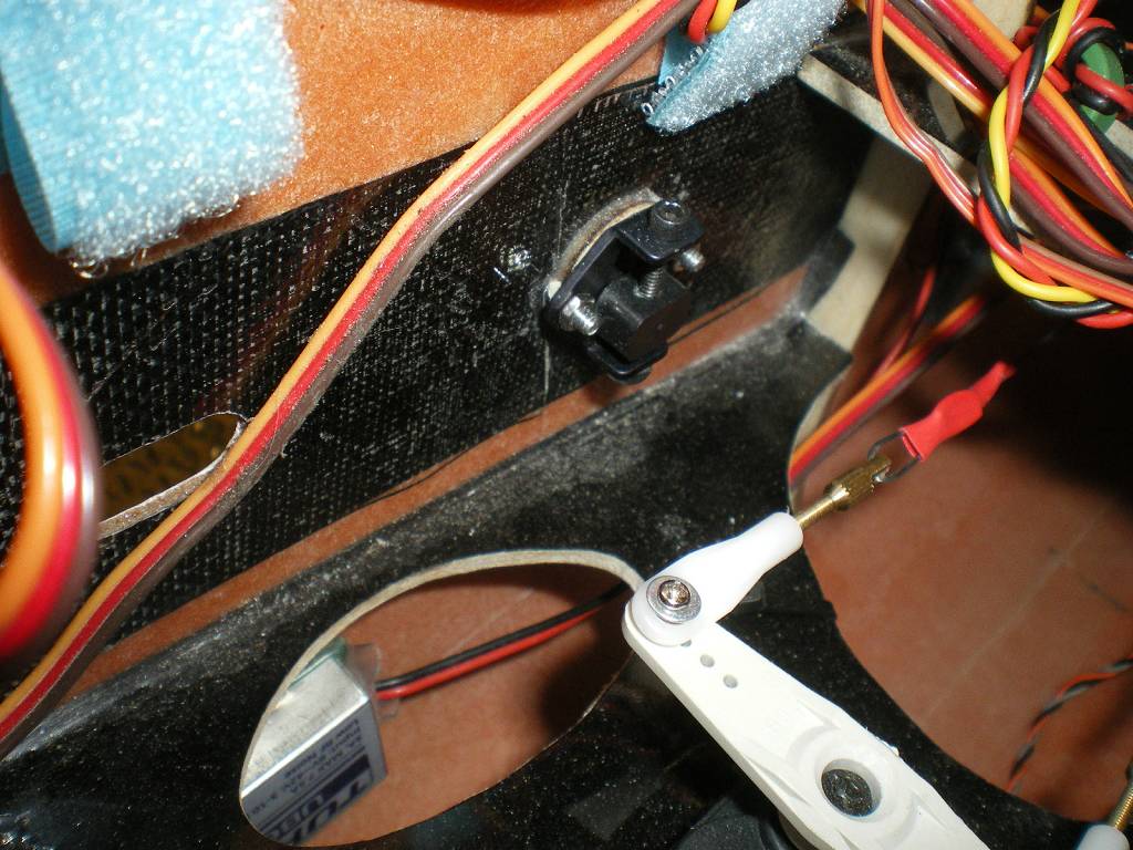

Would someone who has added wing adjusters to the Wind post some description and pictures of how they installed them? Might save some of us from reinventing the wheel.
John

I did mine the easy way, attached the adjusters to where the rear anti-rotation pins were, push out the blind nut in the wing and move it to where the front anti- rotation pin was.
I have them adjusted to 1degree positive, from a factory setting that seemed to be about 0.5 degrees positive. There seems to be an improvement, but it looks like it may need a bit more positive again, love this model though!

ORIGINAL: matt13
