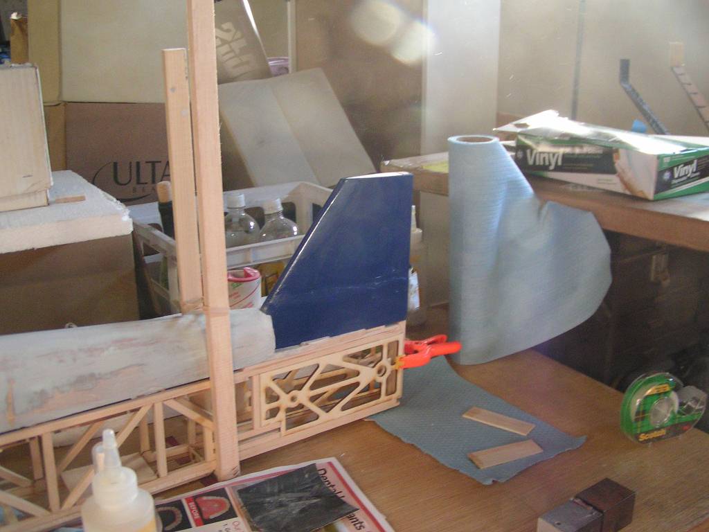

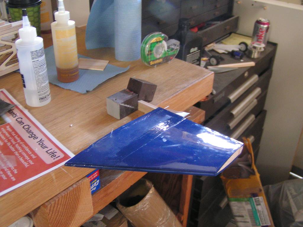

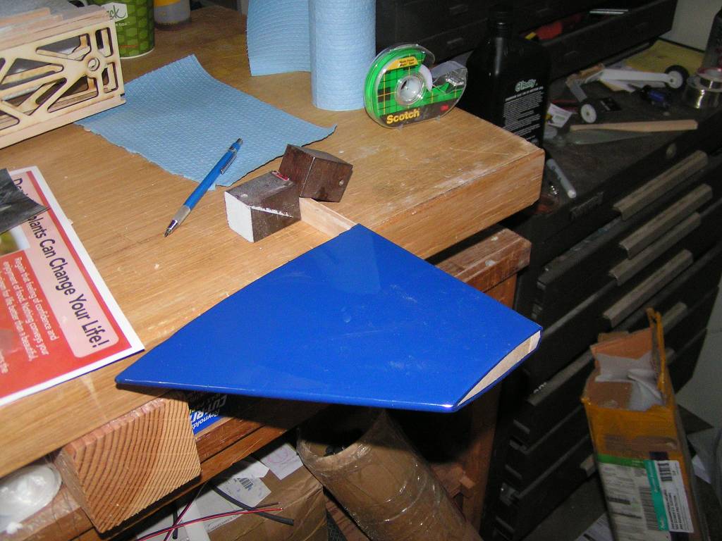

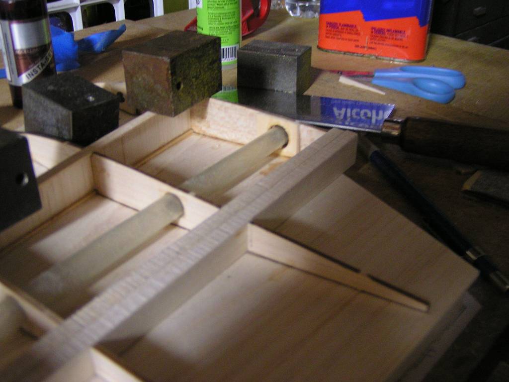

Broke out the hinge line from the ribs, just like I did with the wing, then glued in pre-shaped stab TE/elevator LE.

Pic's for previous post

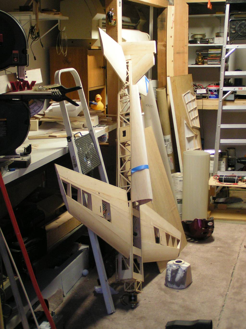

Default RE: Build Thread-Scratch built for 8s

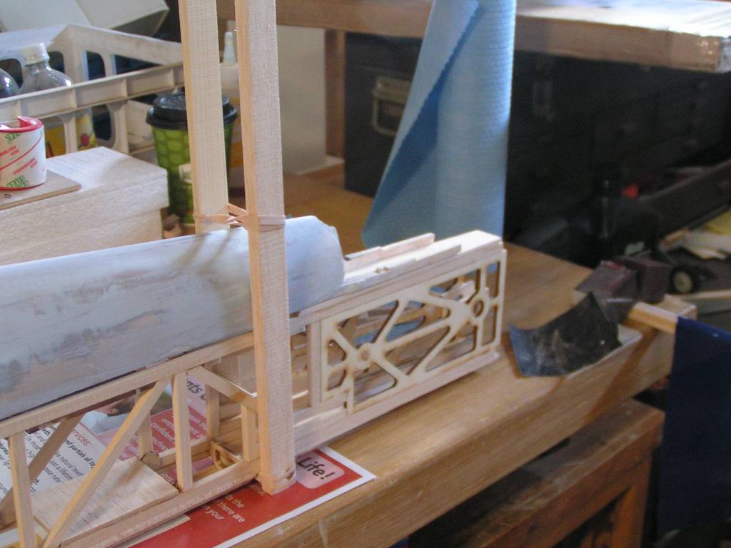

This whole weekend was devoted to finishing the dang thing. (i didn't) But I came close. I was setting the incidences when it started raining and I had to haul it all in. Over the next week I should get the controls hooked up, and get the plugs to the point where I can start pulling molds. I had to rebuild the turtle deck plug. This time I built it up, stringers and all, then sheeted it. It's straighter than the first try, and it was probably faster than trying to get the original to look good. I started on plugs to mold the wing tips from flower shop foam, but decided to rethink that too. I am having my laser guy cut some pieces so I can stack them into a more accurate shape.
The plug for the cowl is sitting on the ground next to it.right now it is plywood, flower shop foam, and light weight Spackle.

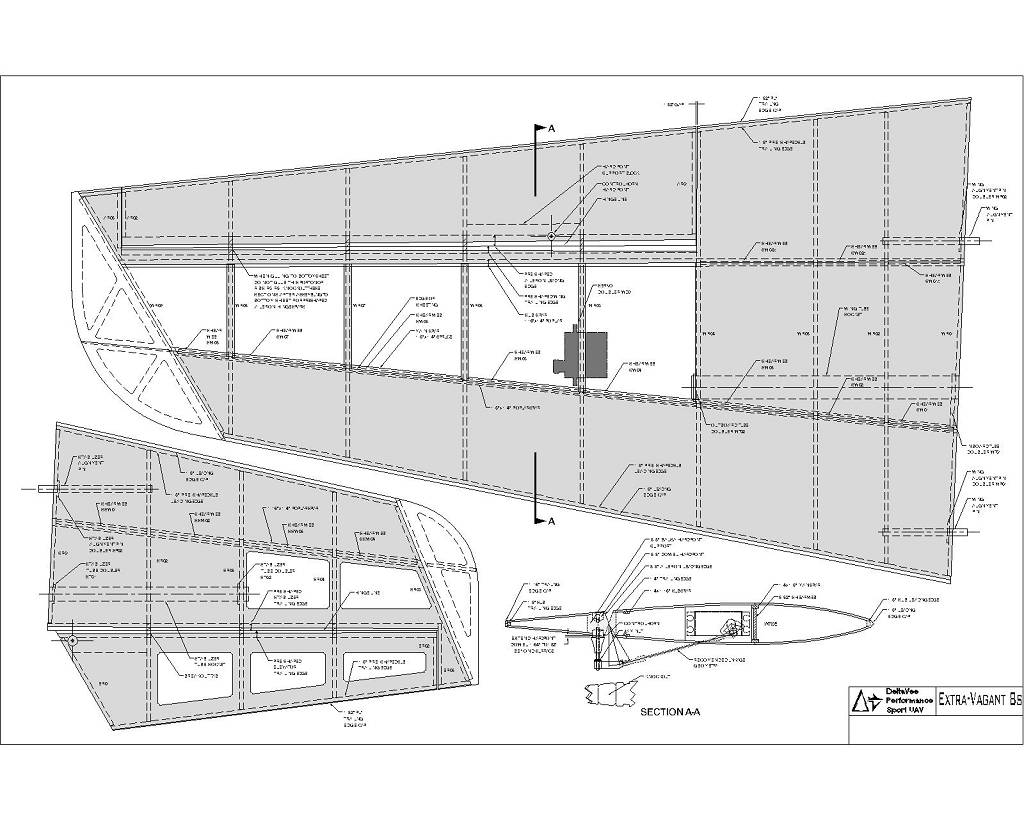

I would be happy to provide plans, and laser cut short kits, but not yet. I have not flown the prototype. I am certain that it will fly; I just do not know exactly how well. As for the plans; the set I have been working on are just line work with no annotation, so are not ready for distribution. I have one sheet, for the wing and stab, in the proof reading stage. The fuse and rudder plan is quite a ways from being finished.

I will have two planes by then. The second is with the laser cuter now, and has some design changes made while framing the first. I call them v0.1, and v0.3. V1.0 is on the drawing board, and is ready except for any aerodynamic adjustments I may need to make. I am now in the process of making plugs for the cowl, turtle deck/canopy, and wing tips. I decided on molded fiberglass tips not just to save weight (I do not think it will save that much), but also to insure dead ***** repeatability of the shape. Also, if I do build a few to sell as ARC, it will be faster than carving them, and I would want a little higher labor rate than a 14 year old in China would require.
The design has morphed a lot from the Gator Giles that inspired it, but the thing that I liked about that design was the simple, fast building fuselage structure. The design has been largely driven by that consideration, and DFM (design for manufacturability) is the big difference between making enough to support my habit, and it not being worth the trouble. Two piece wing and stab make it easier to transport in my small car.

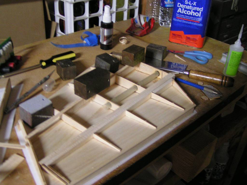

I shaped the canopy and turtle deck back to the vertical stab. Then I positioned it on the fuselage. The two sticks and rubber bands are to maintain proper alignment to the fuse while the fairing is being formed.
I framed up the vertical stab, then Monokoted it. Then I brushed on some PVA and glassed the portion that would become part of the fairing.

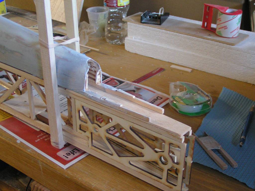

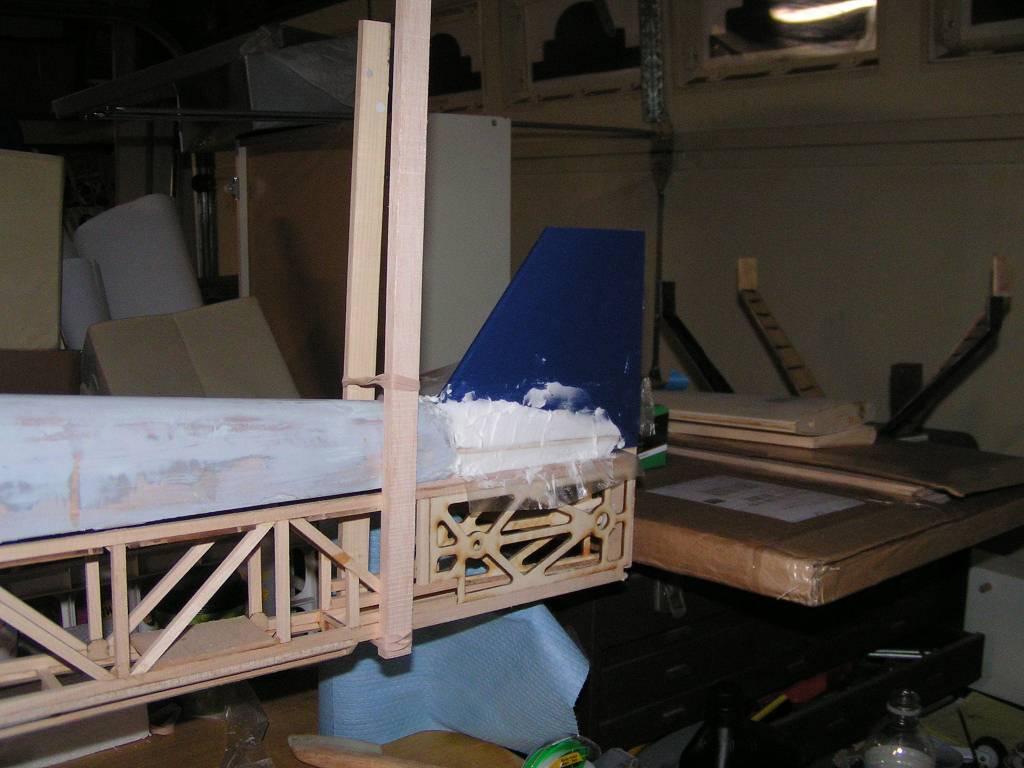

The next step was to position the fin, then lay up some filler. I use a lightweight spackle you can find at a home improvement store.

I just want to know why you didn´t use balsa for " filling" the space in the vertical stab between the rear fuse and vertical stab and you use light filler? Maybe the balsa save you some weight...

rather than using filler for the fairing on the fin I would have used balsa block profiled to the fin and then sanded to shape as you did with the filler. Then you could have removed the balsa block and hollowed in out more.
Just thought that would have been lighter/

I just want to know why you didn´t use balsa for '' filling'' the space in the vertical stab between the rear fuse and vertical stab and you use light filler? Maybe the balsa save you some weight...
The two steps here were; first use the fin to cast a thin fiberglass shell that would become the inside surface of the fairing-second, build up the fairing to match the contour of the turtle deck. I used the lightweight filler for this because it is very easy to shape, and it becomes pretty hard when you apply resin and fiberglass.
This is not the actual turtle deck that will go on the flying model. It weighs about four pounds so far. It is a plug that will be used to make a female mold (mould for our friends across the pond)
Thanks for the comments I hope to have more pictures up by tomorrow that will make it clearer what I am doing.

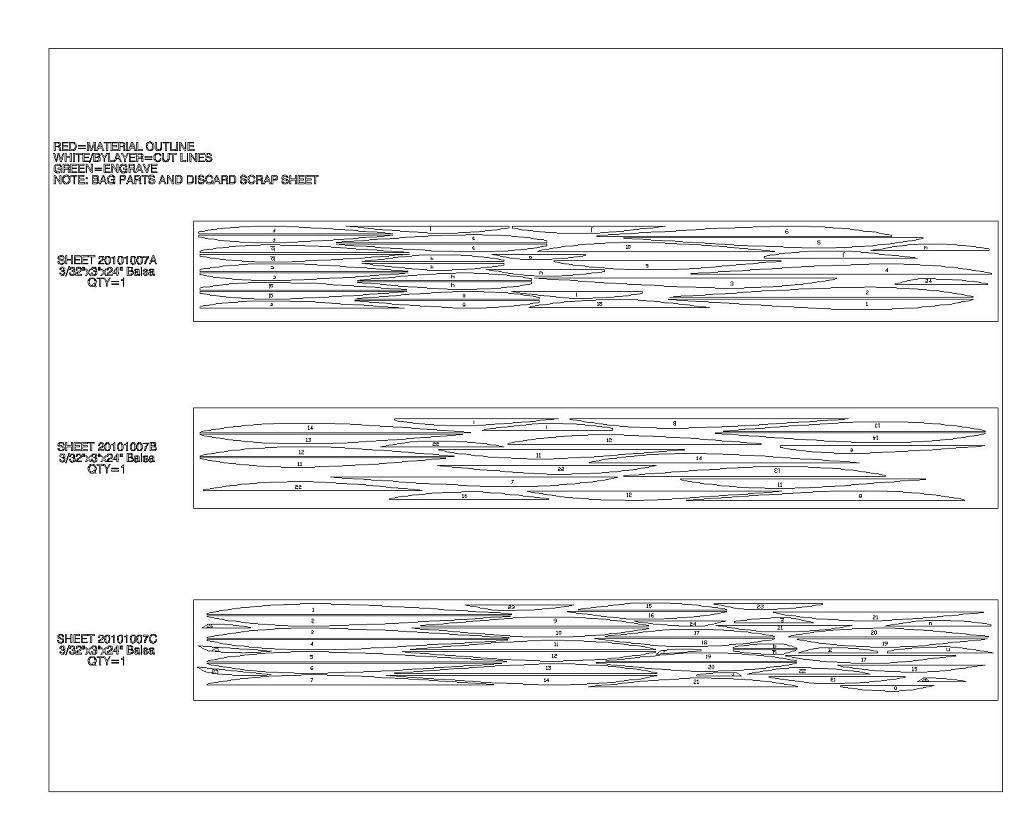

I will offer it a a short kit that will include laser cut wood sheets, machine cut wood for ruder, aileron and elevator hinges, spars and stringers. I may or may not offer sheet wood for the wing, stab and rudder sheeting. It will also include fiberglass cowl, canopy turtle deck, and wing/stab tips. CF wing and stab tubes with FG sleeves. and CF landing gear. As short kits go, it is not that short.
You need to be a little patient. Test flights are revealing small changes that need to be made. The plans and laser cut files will need to be finalized. I also need to make a few more of the FG parts to be confident I can produce them at a good level of quality. For example, I got a canopy I could use on the third try. I am very happy with the finish and weight. (The first was 90g. The third was a FG/foam/FG vacuum sandwich that came out much stiffer at about 60 g). The quality is still not at the level I would be happy to sell. Each one is a learning experience for me.
