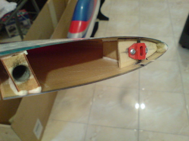

After that i started putting on the stab adjusters and for doing that i had to cut the front tube with all the material round it to make enough room to glue a light ply and screw on the Gator stab adjusters.
Here are some pictures of the stab with the front tube cutted down

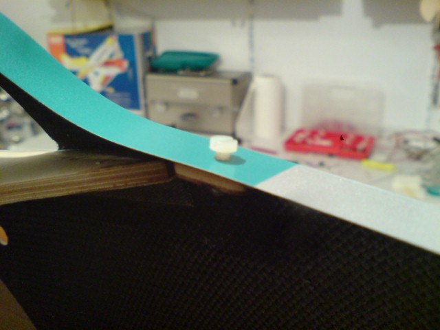

Yes i opened the inlet on the chin cowl so i can put in the nose one plastic m3 screw to secure it
Here are two photos of the two screws that hold the chin cowl in place and if you need i can take some with more details.

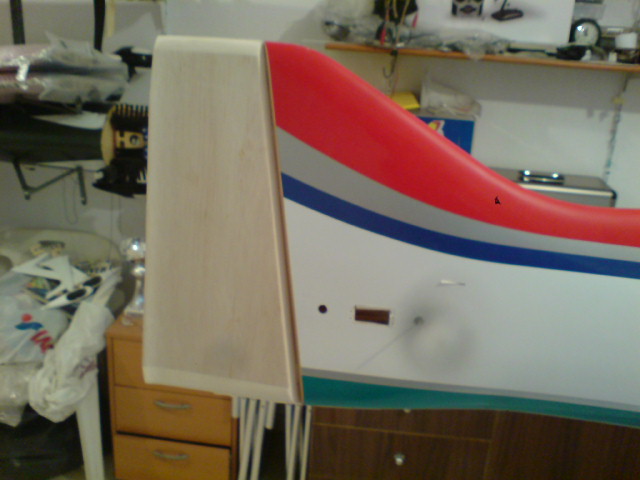

After ten days i was too busy with my work i found some time to make a little work on the stabs.
I decide to put two mini servos in the tail and i screw them on the fuse.
I wanted to be hidden in the stab and only the servo horn be visible outside.

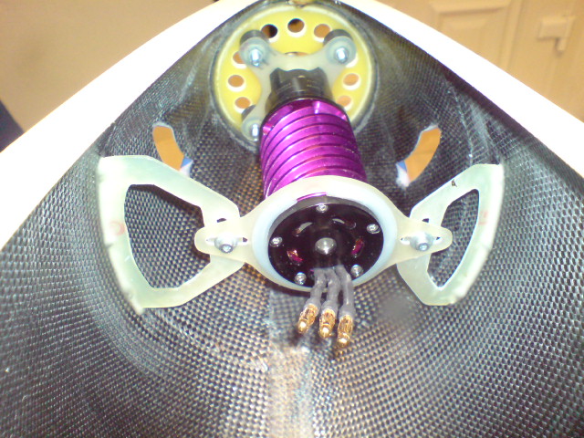

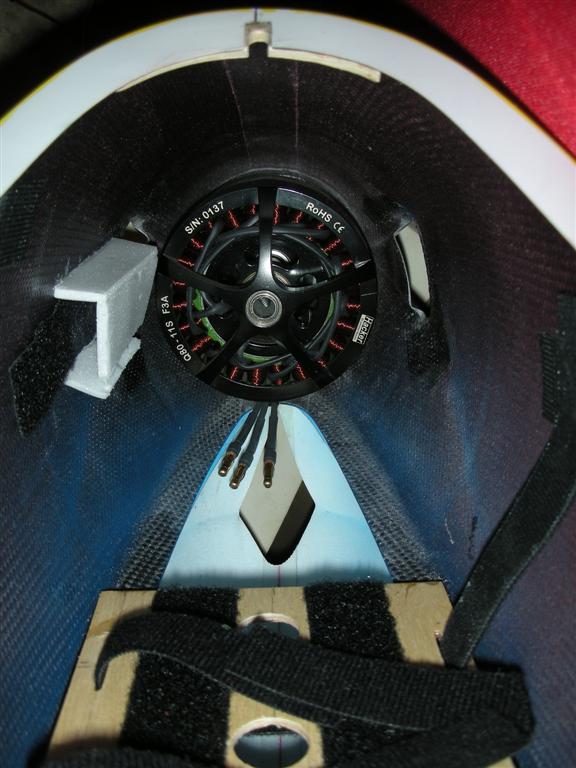

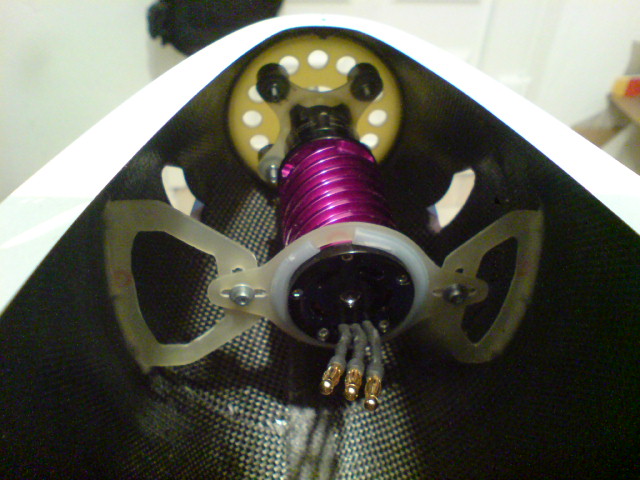

I am building a Gaudious right now, and running the Hacker Q80.. Anyway you can post some pics or PM some, having an issue with that install..
Thanks! Charlie Rock

hi Charlie - I'm the lucky one who has Larry's Gaudius, I would be happy to take a few pics if you would like. Please PM me and let me know what you would like photos of. One thing Larry didn't do is support the back of the motor inside the fuse like some have done. Since weight isn't a problem, I plan to do this with a 5mm CF tube that fits in the ball bearing on the back of the motor.
Steve

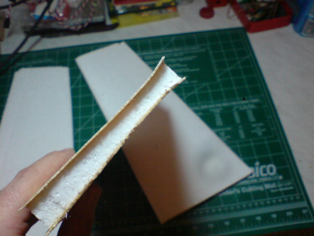

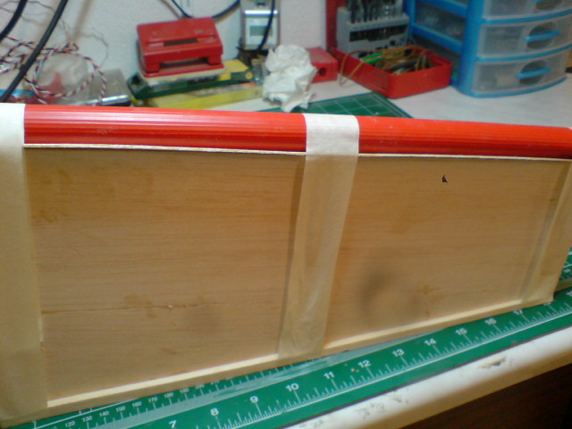

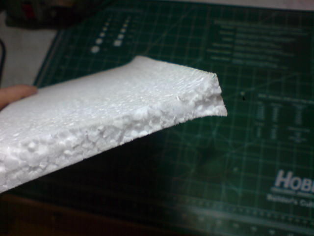

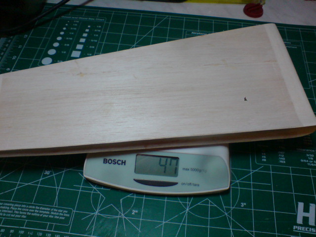

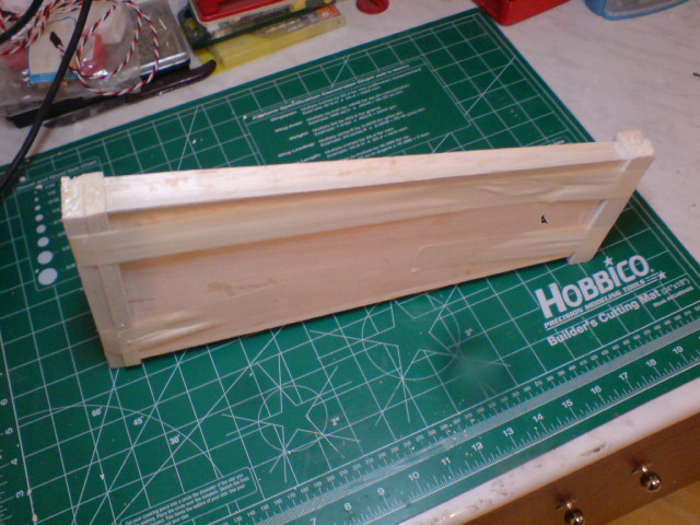

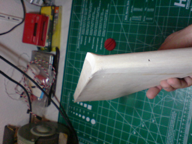

Until my stuff come from Lorenz i decide to make a rudder and give it new shape.... also my thought is to be removable so i can change it and see any differences in flight between mine and the original and also i can take it off when i want to transport my plane.
So i start again to Drawing and cutting and sanding......

Charlie - Attached are a few pics that I hope help. One you will see the Hacker Q80 front mounted. I do plan to add a rear brace to help provide some additional support. There is no internal firewall with this setup. The aileron servos mount from the inside of the wing using hex servo screws fastened with an allen key secured to the end of a long dowel. Since the slot in the wing is just for the servo arm, you have to install the servo arm onto the servo before putting it into the wing (you have to rotate the arm so it fits through the hole). Be sure to turn your brass screw bushings around so the flat spot is on the top of the servo, otherwise they'll dig into the mounting plate. Larry cut the slots in this plane, so I can't really recommend how to determine where to cut, but I can say that you need to figure out which servos you want to use because the height from mounting tab to servo arm differs between servos. I was hoping to use my DS9411s in there, but the control arm wouldn't line up with the slot since they are not as high as a DS8411. In addition, I would have had to add a spacer in the mounting plate since the servo mounting tabs are not as wide. Hope this helps.
Steve
Steve
