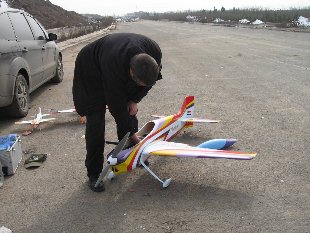

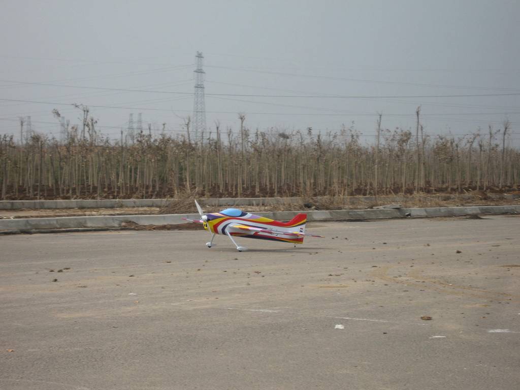

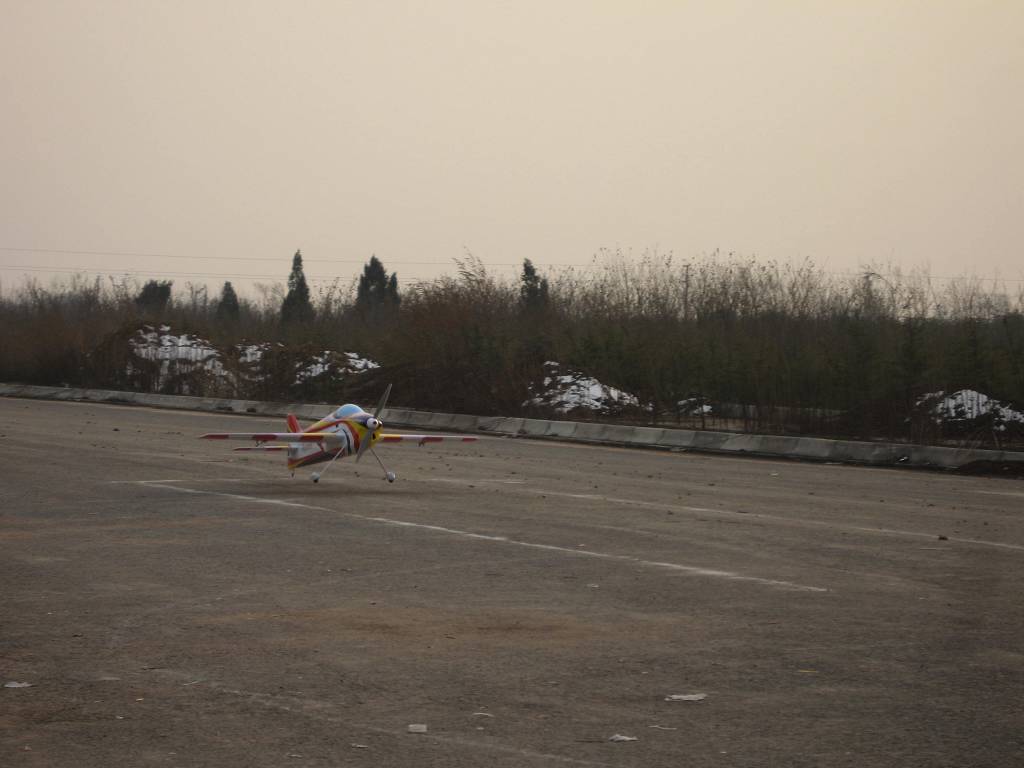

Well, it finally happened. The maiden flight of my e-Neptuno. (and my first step into e-power pattern flying)
After days of waiting till the snowing would stop, we went out today to see how it would do.
I used the settings from my Altair, instead of the glow Neptuno as that one has only one elevator servo and when changing the model type to two elevator servo’s, all settings were erased……
The specifications of my e-Nep are:
- Hacker C50-14XL
- APC 22 x12
- Jeti Opto 99
- 2x Hyperion 5S 5000 and 2x Top Gun 5S 5000 (local brand)
- Futaba 6008HS receiver
- Futaba BLS servo’s
- Powerbox digiswitch
- 2S800 Dualsky receiver battery
- total weight 4884 to 4909, depending on battery pack
The first flight was uneventful. Just some passes to get used to the plane and do some trimming. It needed a few clicks up elevator and left aileron. First impression was good and the plane felt very stable and soooo slow to fly. I only had to get used to the throttle control as the feeling is significant different compared to a YS170 CDI.
Also landing went well, but again a bit different feeling of the throttle, but no problem for the rest.
After making some changes on the settings (more rudder and elevator throw) I used the second flight to check knife edge flight and up and down lines. It did not need much mixing for knife edge and up line was perfect. Only for the down line a little throttle to elevator mix will be needed as it started to level out after a while.
The third flight was with a battery pack made by a local LiPo factory, which I got for testing. After making several passes to check again the knife edge, I started to get the feeling that I was already flying for quite some time when I suddenly lost power…..! Quick landing and then to find out I was already flying for 16 minutes..!!! Turned out that I did not hear the timer at all because of some other (noisy) flyers around.
Fourth and fifth flight I used for flying the P11 schedule which it does with no problem at all.
All in all it was a very nice afternoon and I am very happy with how it went.
Some observations:
- flight characteristics are comparable to glow Neptuno, i.e. very stable, straight and neutral and in some areas a bit better.
- electric drive seems to make it more stable and easier to fly slowly
- due to the slower speeds more throw on the control surfaces is needed, especially on rudder I ran out of travel. I think that the control horns on the rudder are a bit too long, as was also the case on the glow version
- snaps are good and a bit slower compared to the glow version, which makes them easier to control. The snaps on the glow version tend to over rotate a bit, which the electric does not do at all.
- the opposite spins were already very acceptable, but could improve from some small changes
Tomorrow I will try to make some more flights and I will keep you posted

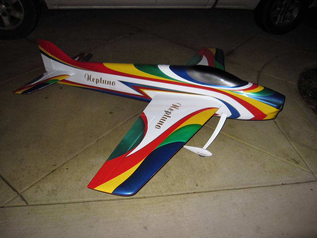

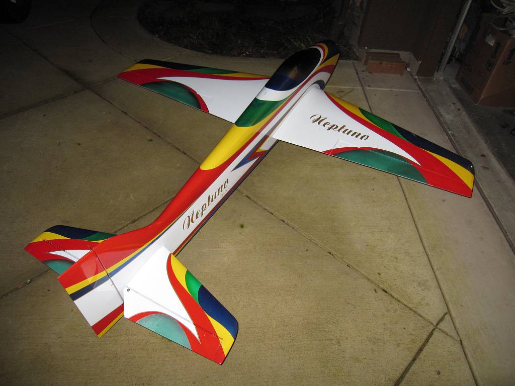

Thanks for posting those Luke! Glad you brought a camera!
I was amazed at how nice and bright the colors are in the sunlight! It made me even more stoked that I got it! I will buy another for sure! What a deal IMO.. I'm really happy with the look with the canopy in this color.. Seems as all the pattern guys at the field liked it better also..
Kevin, did you order one yet? haha We were taking bets after you left that you'd have one at your house in 3 weeks.. lol
C

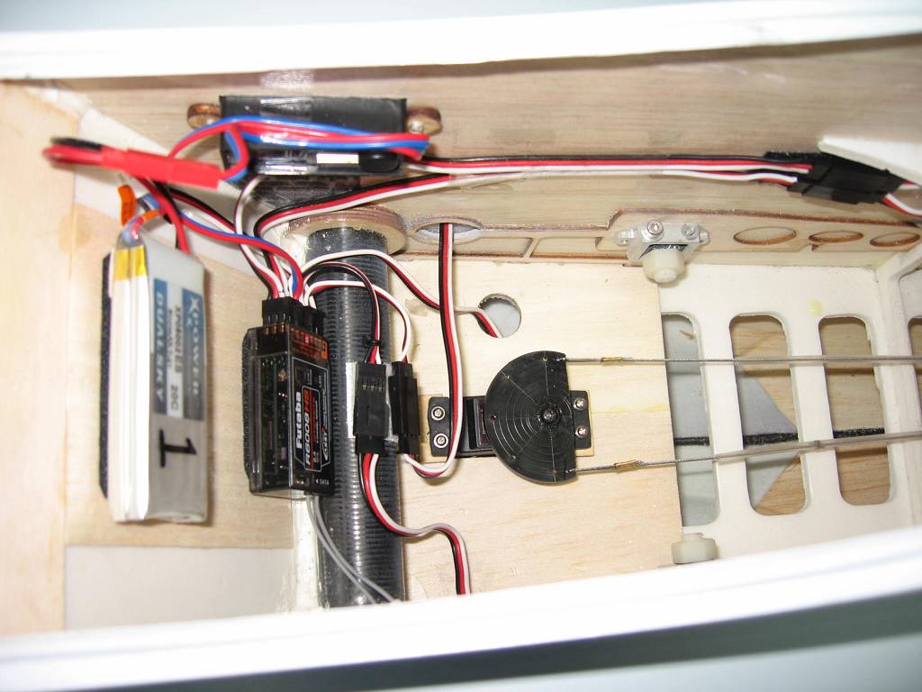

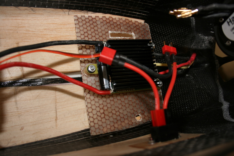

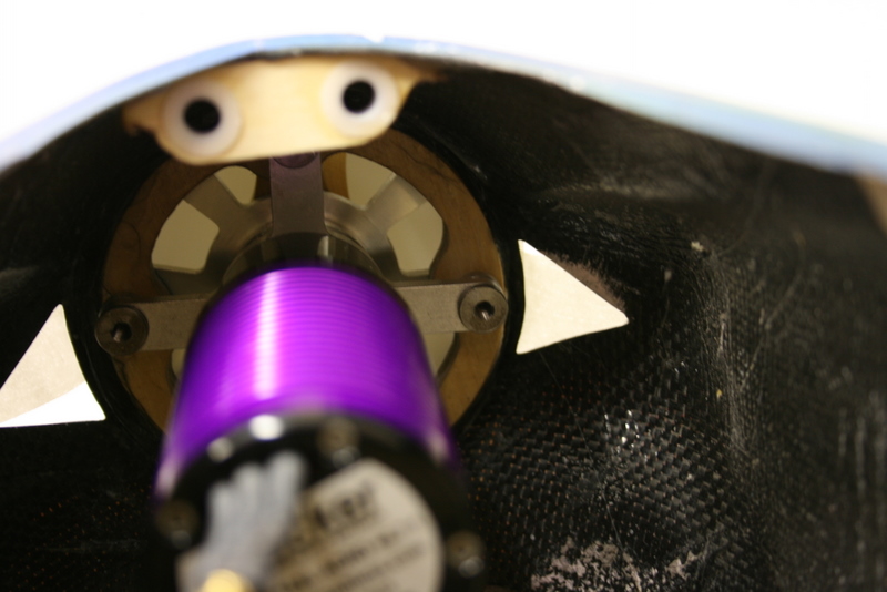

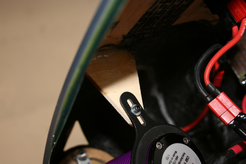

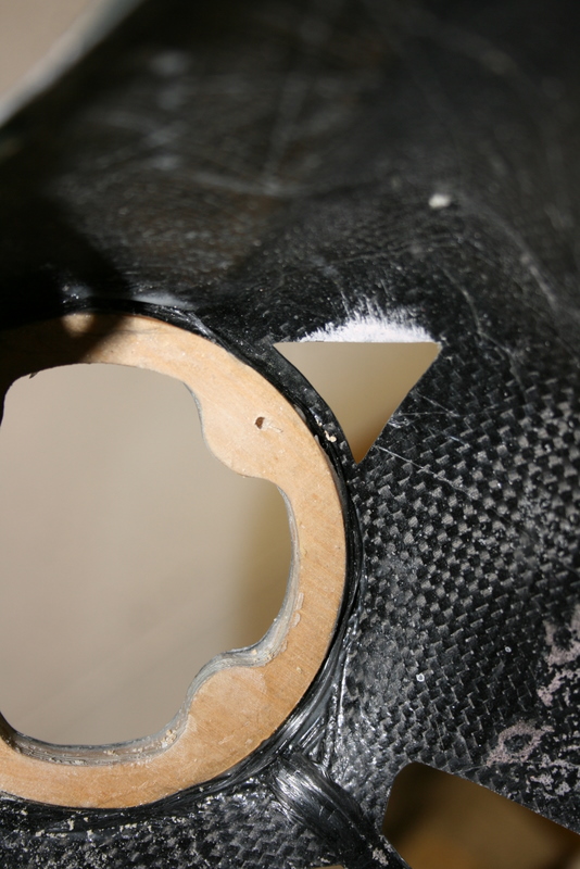

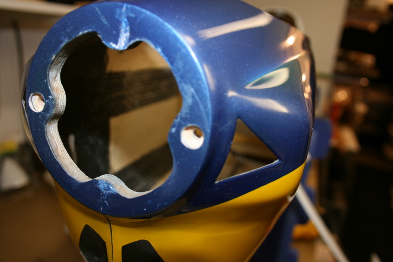

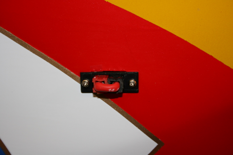

Mounting the motor...
I apologize for not finishing up this thread and posting the motor and battery tray/equipment installation but life and work got in the way. Let me finish up the thread now.
The kit comes with a standard mount for the Hacker C50 motor which I used. It also came with the rear support mounts for the Hacker but I chose to use Jerry Budd's rear support mount. I wanted to use Jerry's soft mount for the Hacker as well but it is slightly smaller than the supplied mount and doesn't match up to the alignment holes. I've since received another faceplate from Jerry that is larger than the current one and will try it later. From the pictures you can see the supplied mount and bolts and how I taped the motor to the plane and marked holes for the bolts, drilled the pilot holes and then enlarged them for the bolts. I had to countersink the front to accommodate the flush bolts.
1. Mount attached to the motor with the mounting bolts
2. Motor on the front but hanging loose
3. Motor taped to the nose so that it can't move and is stable
4. Plane hanging from the wall after I finished the taping
5. Motor/mount aligned with the nose plate
6. Marking the holes so that I can drill a pilot hole
7. Drilling the pilot holes
8. Pilot hole drilled out
9. Countersinking the front to accommodate the bolts
10. Two horizontal holes have been countersunk
I mounted the motor first with these two holes first before marking and drilling the final two holes.

The final step in mounting the motor was to drill out the remaining two mounting holes, countersink them and then mount the motor and the rear motor mount support bracket. Here are the pics...
1. The motor mount is now bolted to the nose of the plane with all 4 bolts installed.
2. Motor is installed now with the rear mount in place. I used light ply for the brackets that attach to the fuselage and these were reinforced with fiberglass where they attach to the fuselage.
3. The other side of the mounting bracket.

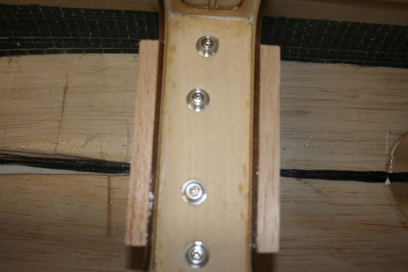

Next step is to mount the shorting plug, ESC and the battery tray. I glued a piece of 1/32 ply to the fuse and cut out the shorting plug hole. I then glued two pieces of balsa triangle stock to the fuse sides to act as a support for the ESC tray which is made out of honeycomb. I glued 3 dowels to the tray to act as supports for the screws that hold the ESC down. I've since changed the ESC to the Jeti 77 which is half the weight of the 90. I wasn't sure where the CG would end up so instead of gluing the battery tray to the fuse sides I decided to make it removable and to mount it to the gear plate. I used a 4/40 bolt and blind nut to hold the battery tray in place. I also put in a light ply brace in the front/rear which I then used to zip tie the battery to so that the tray wouldn't move up and down. I started off with the rearward CG (190mm from the leading edge) and have ended up with the tray more forward now and the CG is at 170mm. I've removed the rear brace and have only the front one in place now as well. I've also slimmed down the battery tray (made it narrower) and drilled lightening holes in it as well. Here are the pictures...
1. Shorting plug mounted showing the inside
2. Shorting plug from the outside
3. Triangle stock bracing for the ESC tray
4. ESC tray mounted using honeycomb
5. Landing gear plate - I added the triangle stock to give a larger surface for the tray to sit on
6. Hole drilled through the landing gear plate
7. The battery tray bolted to the gear plate - you can see the slots I cut in the gear plate so that I could move it forward/backward easily
8. The battery plate with tape on it so that I can mark the CG position - you can see the rear brace which I've since removed - the front brace is under the left hand side of the plate
9. RX battery and RX installation
10. The completed plane ready for flight
11. Another shot of the plane
12. The group at Tomcats in San Jose and 3 Neptuno's - my two on the ground (GP on the left and EP on the right) and Riot3D's GP Neptuno that he is holding
