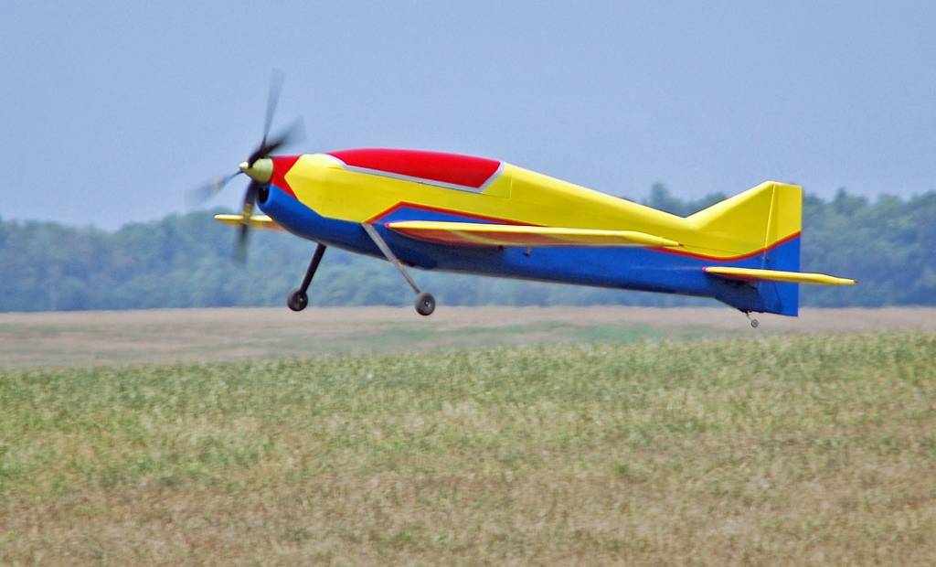

ORIGINAL: Spark09
Nice Br@m
My dad did a nice Job covering the plane in the Spark scheme.
This plane called the Indira is actually based on the little Miss Wind 50 wich I liked a lot but it's to small for serious F3A flying.
We can't afford the big Oxai Miss Wind so we scaled up the 50 size Miss Wind.
And after a few version this is the latest one.
It is completely wood built with foam wings and a carbon motor cowl.
Sorry there are no plans available.
This design flies very well with the contra drive, it seems that the small fuselage works very well with the contra drive.
I flew mine at the 2012 EC at Chateroux France and finished 47 this was my first EC.
I modified my wings with winglets like the Wind S Pro GFK version the bubble tips these seem to work better than the flat ones used on the Oxai Citrin. I also have them on the tips of the stabilizer for rock solid flight in windy conditions.
I also widened the TE of the rudder by almost 2 cm.
This was a very nice project and we had lots of fun !
The project started in the winter of 2010 there where 7 planes buildt. 1 crashed by a Emcotec DPSI switch failure.
Building and designing was done by Harry Wever, me and my dad. I've done the test flights and tweaking until it was at it's best.
The contra drive was the last and best upgrade for this plane it is a match made in heaven
Hope Br@m will enjoy the plane as much as I do.
I will post some nice pictures from the EC plane I took to France.

What's your ready to fly weight?
Regards,
Jason.

Hi Jason,
It is 4950 grams weighted on the FAI scale at the EC.
I use TP 4400 batteries wich are 1010 grams.
Wolfgang Matt was flying the new TP 4700 packs and they where 150 gram lighter than the TP 5000 batteries as he told us.

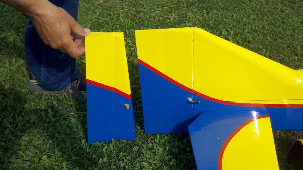

Hi Spark09,
You wrote ;
Quote;
' I modified my wings with winglets like the Wind S Pro GFK version the bubble tips these seem to work better than the flat ones used on the Oxai Citrin. I also have them on the tips of the stabilizer for rock solid flight in windy conditions.
I also widened the TE of the rudder by almost 2 cm. '
I wonder is the 'bubble' actually giving a subtle 'toe in' effect ??
It is the only reason that I can see for it being noticeably better.
Interesting !!?
Brian

Yes the bubble version of the winglets give me a steadier flight.
I personally think that it has something to do with the aerodynamics since the bubble version is smoother compared to the regular thin fins wich are noticable nervous during turbulent weather.
I tried different styles with the thin fins, toe in and out and straight.
Also experimented with height and dept.
Because I fly a bipe it is more work and harder to notice the differences.
The bubbles on the stabilizer give me a big difference in loops the tail of the plane tracks better.
I would also like to try a bunch of small fins all over the wing.
The Mitsubishi Evo 9 inspired me, they say the car is more stable at high speeds.
Another experiment i would like to try is make a 2m F3A plane fly like a indoor F3P plane by creating more drag with brakes on the wings.
Just some thoughts

Hi Spark,
I see a bigger rudder flair in the pic,, with the bubbles.
Which did you do first.
Did you try toe in on the tail with no flair.
Do you have a record of the sequence of changes and the effects they had - or - maybe you made several changes at the same time.
Brian

I made changes time by time, i started with the winglets the thin ones tries toe in, toe out and straight.
After several flights i made the bubble version for better handling in windy conditions.
When that was right i added the rudder flair for more drag and the plane heads better.
It is always better to make a few flights with a new modification with different wind conditions.
I'm currently trying the "zero gravity" flying method but that takes a few flights to get used to.
The first flight where terrible !

Hey Domink,
Thanks for sharing information about your unique setup. Your setup is the only one that I know of that uses an 8s pack, but Dave Snow tells me that you have inspired him to try this setup as well, so hopefully we will see another 8s setup here in the Chicago area in the near future.
On another matter, Mike Gaishin has been doing some experimentation with his Contra powered Integer. (Mike's version of the Integral..) Mike originally designed this plane with significantly more fuselage side area than is typical, but he left the area of the rudder fin similar to existing designs, and with the Contra Drive, this resulted in significant yaw instability during high speed flight.
Mike solved this stability problem by flairing his rudder. This was a very effective fix, but now he is planning for the next version that he will build this winter, and so he has done some experimentation to see how much area he needs to add to the rudder fin so that he can stop using the flared rudder. (which adds parasitic drag ..)
What he has done was progressively increase the width of his original rudder until the plane was completely stable in yaw without having to use the flaired rudder. The attached pictures show how much he had to increase the rudder size. The flaired rudder is also show for comparision purposes.
Mike now reports that the wider, unflaired rudder is actually more stable than the flaired rudder, so when redesigns his plane he will take the extra area and add it to the front of the rudder fin. He's going to add about 15 square inches to a rudder fin that has the same area now as the current integral rudder fin.

Hi Brenner,
I think replacing the flare with more area amounts to the same thing both in terms of the effectiveness and the resulting drag.
Relative placement of side area needs to be considered in this.
eg; if one likes a 27% CG it should also be at 27% of the side area or as close as is possible. The fuz,, is the flying surface in knife=edge and during rolls etc.
Also I think the blunt fin LE in the pic,, may be playing a negative role.
I'm not saying it should be razor sharp - just a nice section in proportion to it's size.

The flare of the rudder actually enhances the effectiveness of the surface by helping to keep flow attached when deflected. It also creates a drag rise aft of the trailing edge of the rudder, creating a stabilizing force moment.

Hi Doug,
I have to say that I agree completely - based on observation (I'm not up on aerodynamics).
I have just increased ,slightly, the flair on my Midrex. I removed a small area at the rear bottom of the rudder while doing so. I did this to get a more perpendicular TE as with a pronounced flair there is a pitch input if the rudder TE is is not square to the datum. Hinge line may also be an issue. A big flair will show these issues.
Anyway the result of the bigger flair is all good.
Great yaw stability and incredible rudder power.
I am also playing with turbulator strips- just started to do so - we'll see.
I'm sure that with enough area added to the rudder instead of flair a similar result can be attained for straight line flying.
The other requirements of the fin/rudder need to be considered though.
