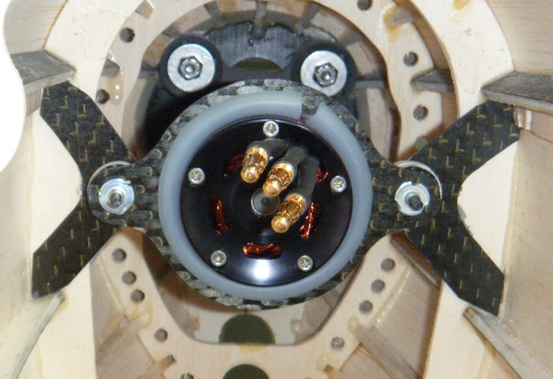

The only question I still have is how/when do I install my soft motor mount for my inrunner motor.
Bob
Bob
Hi Bob,
I will be fitting an outrunner but the drawing also includes a special bracket for an inrunner motor.
Once this bracket is glued in place you can easily mount your inrunner.
See attached pic from Jeff's build below.
