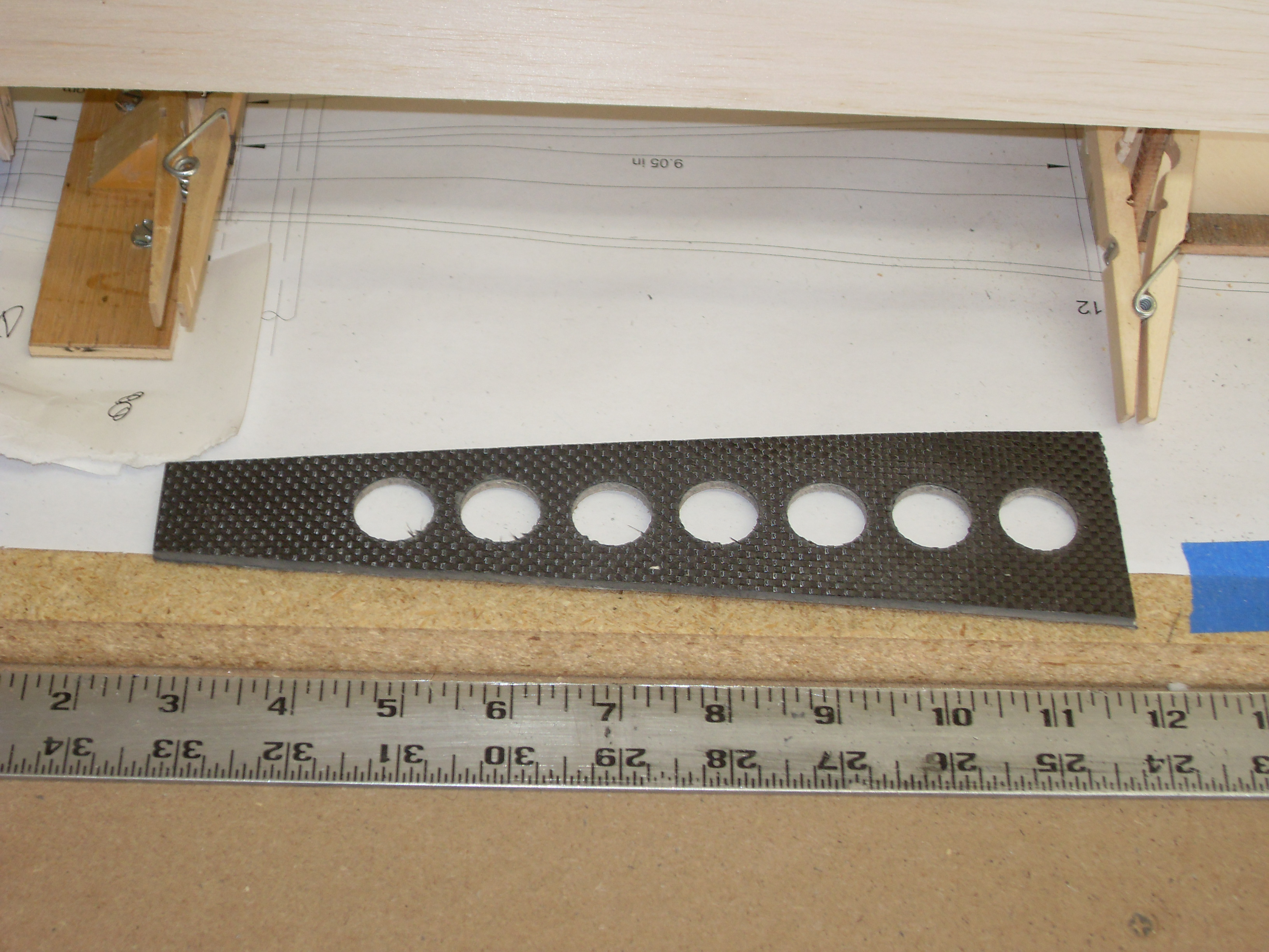

To stiffen the tail, I use a piece of 1/8" balsa laminated on one side with carbon fiber. This web with run from the former aft of the stab tube to the former forward of the stab incidence pin. It runs length wise slightly above the stab tube. The piece came in at 5 grams.

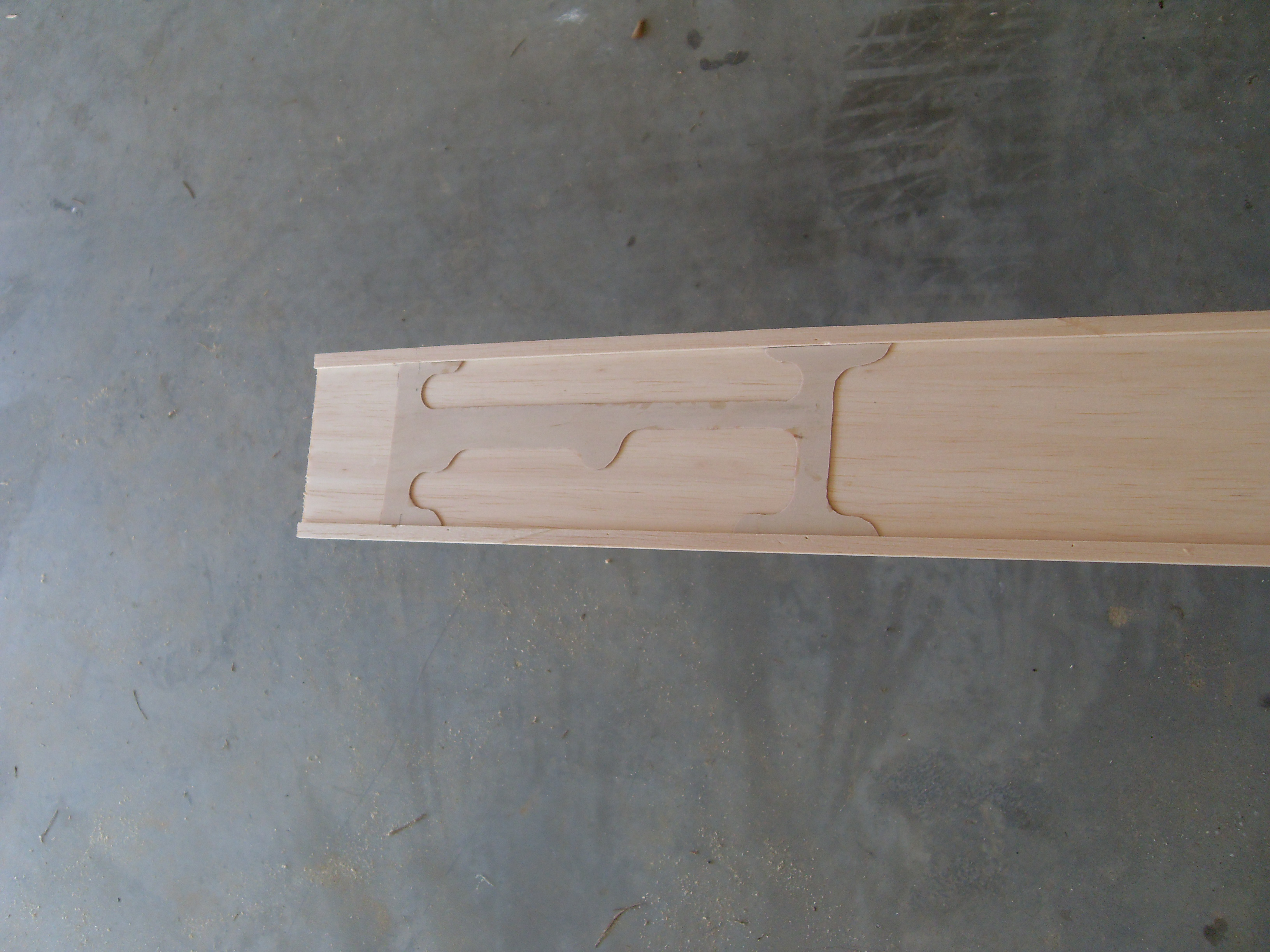

Now it is time to finish up the fuselage sides and get some skin on those bones. The 1/8" balsa sides are reinforced with 1/32 ply doubler around the wing mounting area and around the stab mounting area. There is a 1/8" by 5/16" balsa stick that runs the length of the side, both top and bottom. Why a crazy size like 5/16" you ask? That is so I get a full 1/4" bond to the fuselage side, and also a 1/16" lip sticking up to act as a guide for the top and bottom sheeting when it is applied.

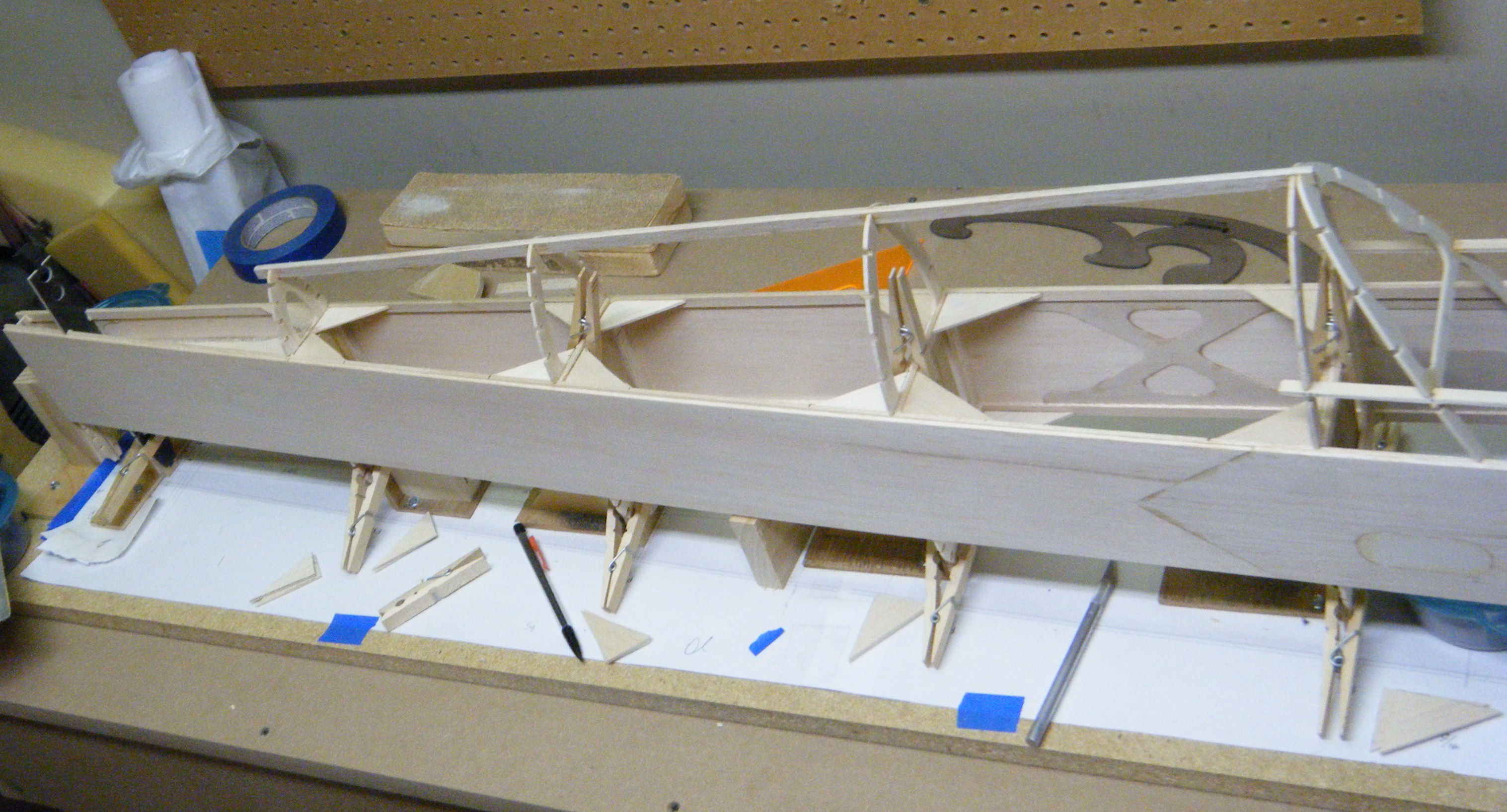

Putting the sides on is a bit of a chore as they extend all the way up to the nose ring which gets into some serious compound curves. One note is that sub 6 pound per cubic foot balsa forms very nice, almost to nice. If you wet it, and then throw it on the formers, it with ripple between the formers (lesson learned on the first build!). The sides bend enough while dry, but it is a pain to glue and tack everything down at the same time with the sides attempting to spring back flat. My solution was to dry fit everything, running tape around the nose to hold it in place. I then misted the front section with water, taking care not to soak the wood. Once it was dry, I removed the sides leaving a near perfect curve in the wood, and no rippling. Now all that is left is to put glue on everthing and clamp it all in place.
Starting to look like an airplane!

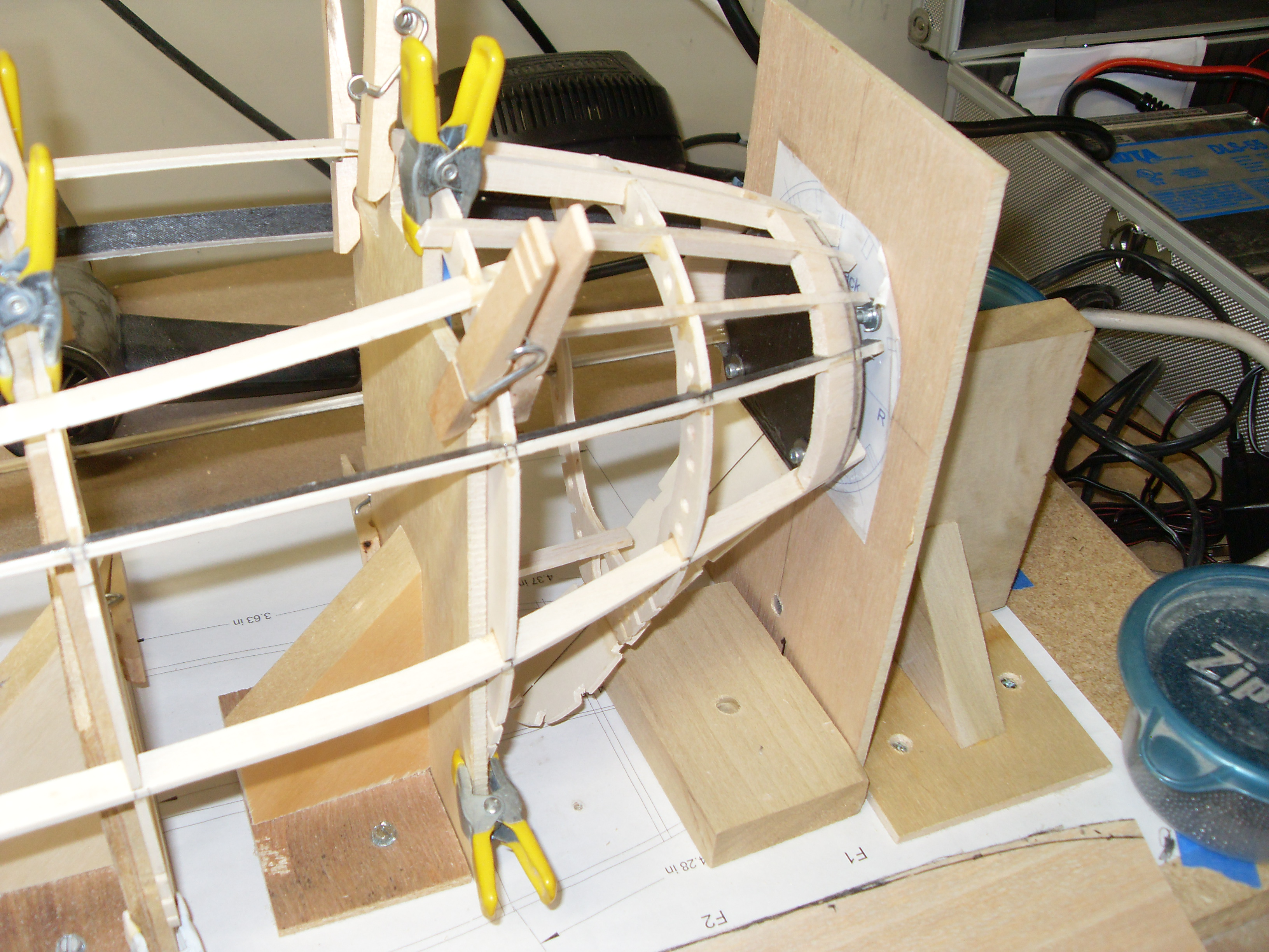

Here is a closer picture of the nose structure/cowl that I thought might interest you. The stringers on the bottom half will be added after the fuselage is removed from the jig.
