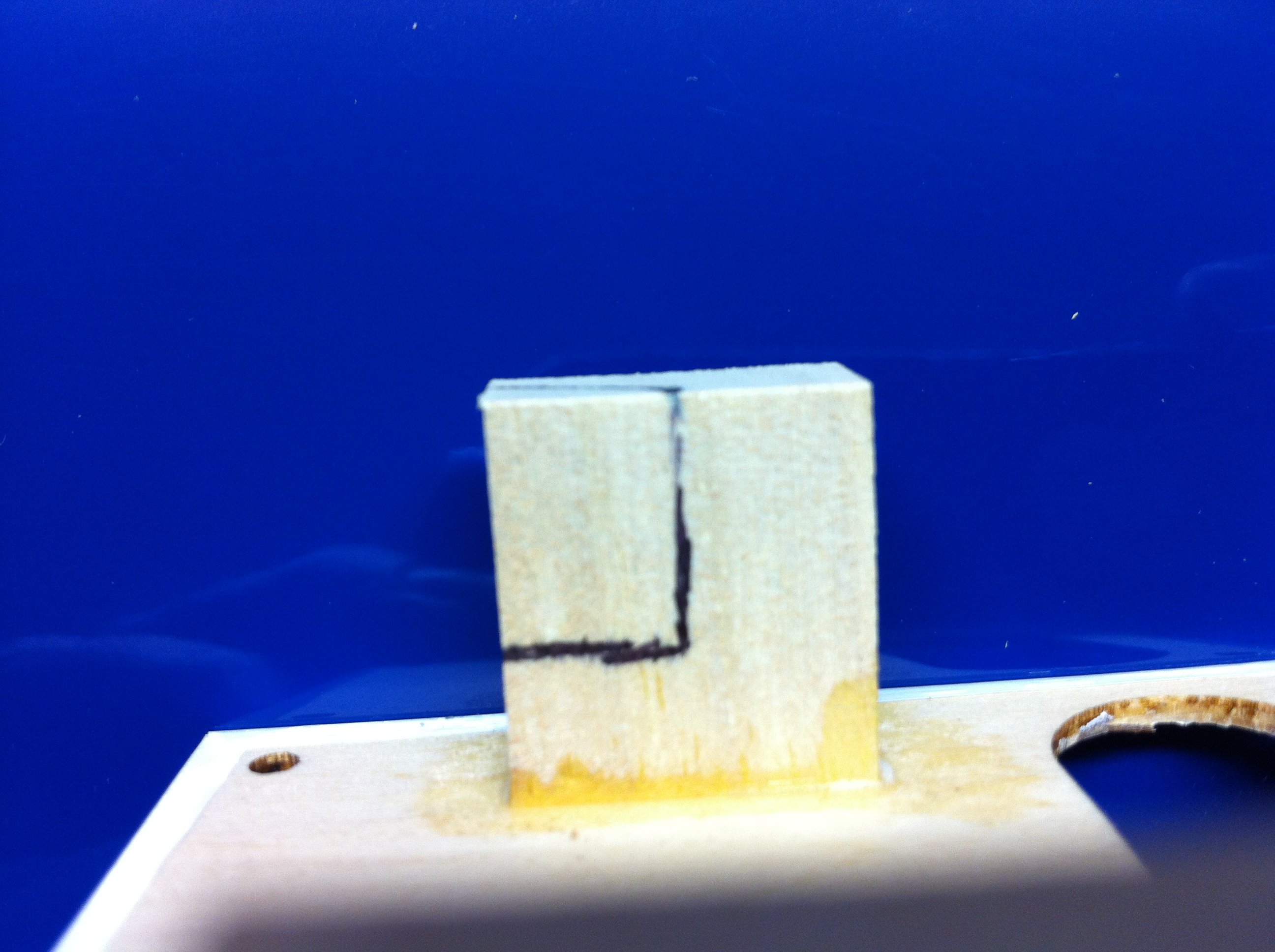

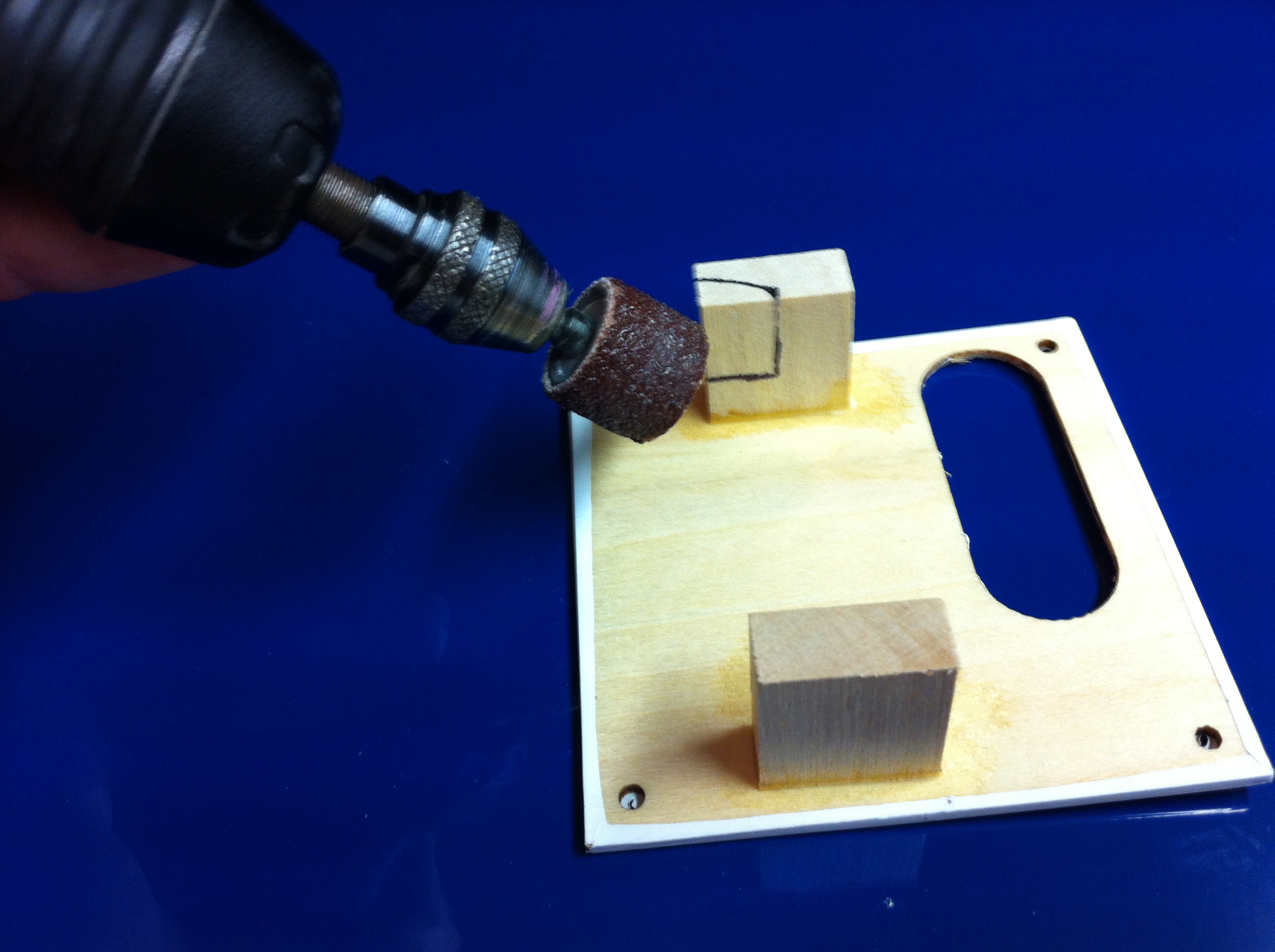

JAS 02-27-2015 10:10 AM
10 Attachment(s)
Aileron servos. This took a little bit more work, but nothing major.
First thing I did was reverse the covers. This allows for a shorter pushrod.
http://www.rcuniverse.com/forum/atta...mentid=2076971
Then, seeing as there was a wider gap than I am comfortable with for the servo blocks...
http://www.rcuniverse.com/forum/atta...mentid=2076973
I took some scrap 1/8 Lite-Ply and made a filler plate for a block on each cover.
http://www.rcuniverse.com/forum/atta...mentid=2076972
The 9551 servo is a low-profile servo, so the wire was inline with the block. I marked the block to remove some of it.
http://www.rcuniverse.com/forum/atta...mentid=2076969
http://www.rcuniverse.com/forum/atta...mentid=2076968
Using a large sanding drum, I removed the material.
http://www.rcuniverse.com/forum/atta...mentid=2076967
http://www.rcuniverse.com/forum/atta...mentid=2076966
I matched the cutout to the lite-ply and cut it to shape.
http://www.rcuniverse.com/forum/atta...mentid=2076965
Once sanded to fit, I used Medium Zap and a clamp until it dried.
http://www.rcuniverse.com/forum/atta...mentid=2076964
Side note: I have seen this a few times on some planes, even pattern planes. The brass grommets go in from the bottom of the servo so it acts as a stop for the servo screw. If installed from the top it will just dig into the wood until the screw is 'crushed' down to the servo tab.
http://www.rcuniverse.com/forum/atta...mentid=2076970

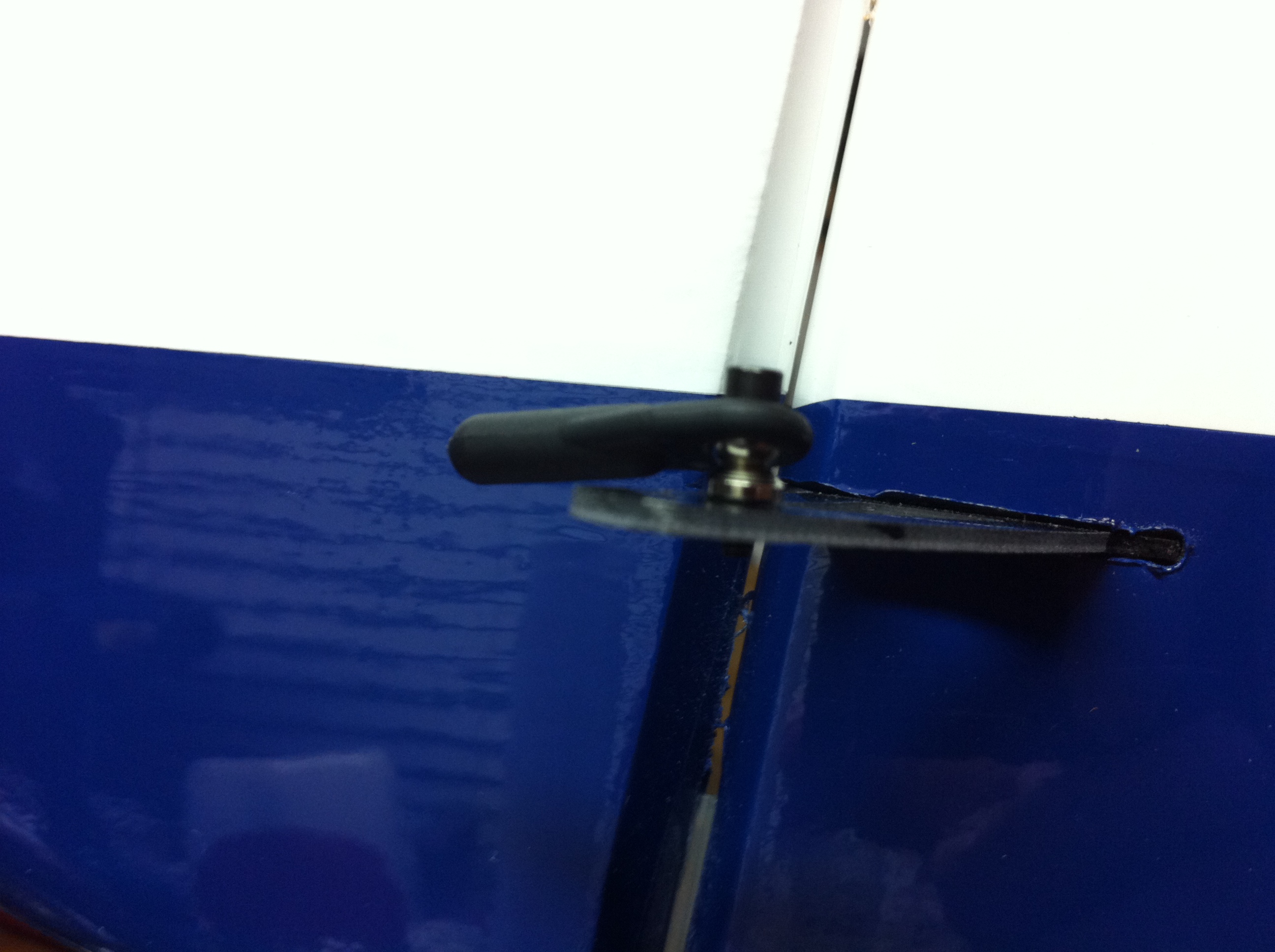

JAS 02-27-2015 10:44 AM
7 Attachment(s)
Now I aligned the servo arms (radio on). Using the plastic jig I lined up the aileron servo arms.
http://www.rcuniverse.com/forum/atta...mentid=2077012
Then trimmed off the extra arms.
http://www.rcuniverse.com/forum/atta...mentid=2077013
This is how I align my stab servo arms. Slide the stabs on the tube and push them together. With the radio on, rotate the arms until they line up with the ruler from one side to the other. Now you know the servo arms are starting straight to each other. You do not need any sub-trim to do this.
http://www.rcuniverse.com/forum/atta...mentid=2077011
Once you have them aligned, remove the extra arms.
http://www.rcuniverse.com/forum/atta...mentid=2077015
http://www.rcuniverse.com/forum/atta...mentid=2077014
Just for fun I put the links on. Pushrods will be made later.
http://www.rcuniverse.com/forum/atta...mentid=2077016
Yes the elevator pushrods will be at an angle when at neutral. Once the servo moves, the pushrod will become straighter, providing more leverage over a pushrod that starts straight then goes out as the servo rotates. At least that's how it works when I think of it.
http://www.rcuniverse.com/forum/atta...mentid=2077017

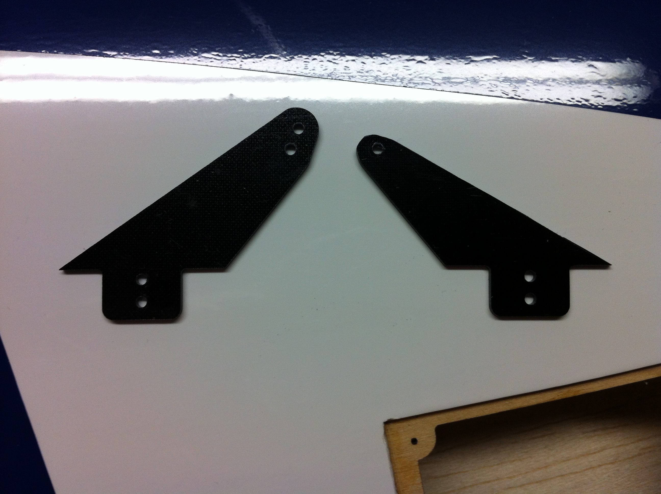

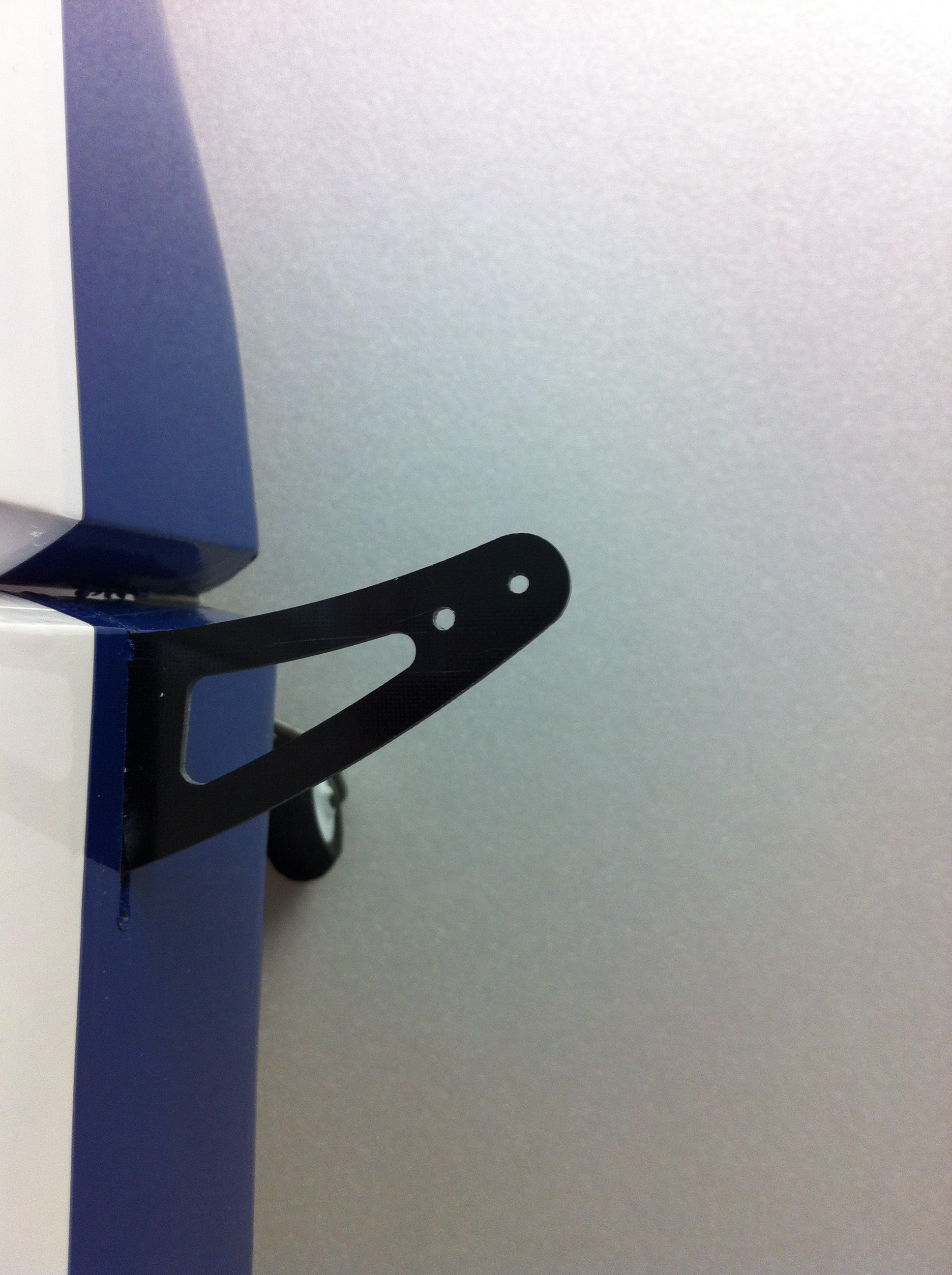

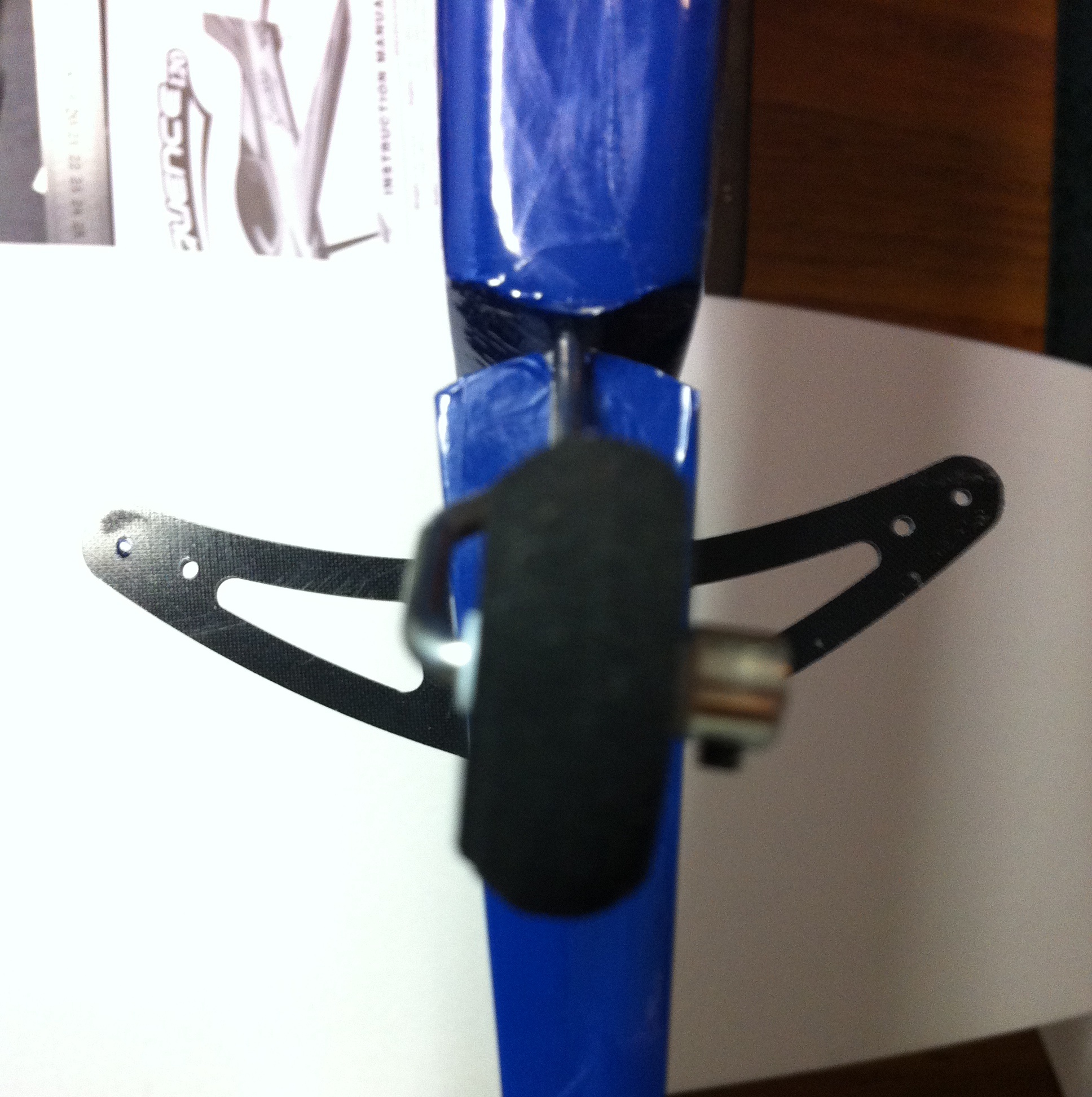

JAS 02-27-2015 10:57 AM
8 Attachment(s)
*** THIS IS SOMETHING I DO NOT RECOMMEND DOING AS IT WILL VOID ANY WARRANTY!!!!!
The first thing that jumped out at me when I looked at the fuselage was the broken top cap to the rudder. The second was OMG that rudder horn is huge. Since it was already glued in, I didn't feel like removing it. So thankfully they left enough of the horn not lightened that I could move the hole in a bit. Only bad part is that this would now put my pivot point behind the hingeline. For me, it's not a big deal. As long as my cables are tight at neutral, I'm happy.
http://www.rcuniverse.com/forum/atta...mentid=2077025
First I centered my servo arm. I am not using the recommended metal arm as it weighs 9g. The Du-Bro HD nylon arm I normally use is only 2g.
http://www.rcuniverse.com/forum/atta...mentid=2077019
I marked the current hole and figured out the proper spacing to allow enough material around the new hole.
http://www.rcuniverse.com/forum/atta...mentid=2077024
Once marked, I drilled the new hole using a .82 drill bit.
http://www.rcuniverse.com/forum/atta...mentid=2077023
Then I flipped the tape to the other horn, lining up the stock hole and the LE of the horn to the tap template.
http://www.rcuniverse.com/forum/atta...mentid=2077022
Drilled the second hole and now I have the inner holes. I am not going to remove the extra horn material until after I fly it and see how it works. If it doesn't work, I will use the stock set-up, including the servo arm. (I'll straighten the tailwheel wire out later)
http://www.rcuniverse.com/forum/atta...mentid=2077021
These swivel links will require the standoff's in order to clear the horn.
http://www.rcuniverse.com/forum/atta...mentid=2077018
Using the same .82 drill bit, I drilled out the aileron and elevator horns. (actually did this the step before this)
http://www.rcuniverse.com/forum/atta...mentid=2077020

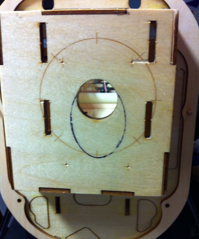

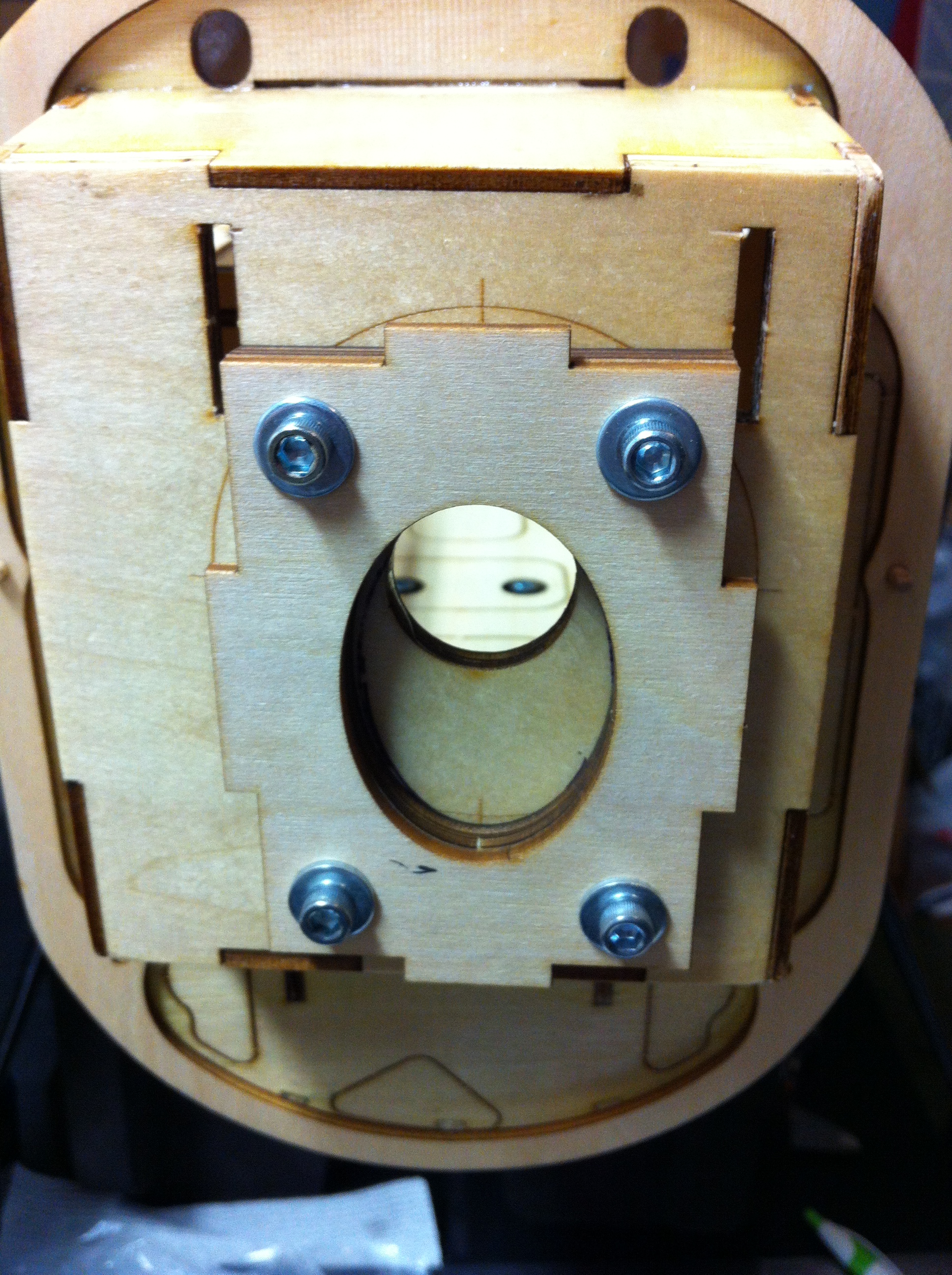

JAS 02-28-2015 09:14 AM
8 Attachment(s)
Motor install using the front mount method. This requires the wood motor mount box, which has to be purchased separately. I can see both sides to having to buy this and it being included in the kit. But working at Shulman Aviation, I see first hand that not everyone uses the 'factory set-up' so not including it makes sense to me.
First thing I did was remove the safety collar. A 2mm machine wrench is perfect for this so you don't round out the set screw head. I also found my collar to be stuck and needed a pair of pliers to rotate it free (some thread lock was between the shaft and collar).
http://www.rcuniverse.com/forum/atta...mentid=2077358
Here are the parts, minus the screws, that I would have had to use for a rear mounting set-up.
http://www.rcuniverse.com/forum/atta...mentid=2077357
Here's the part used for this front mounting method. Almost an ounce lighter. I weighed the wood kit and I think it was 126g, but I don't have a metal mount to compare to, but I'm guessing the wood box is lighter. I haven't weighed the re-cut box with carbon parts, but it is lighter.
http://www.rcuniverse.com/forum/atta...mentid=2077356
I used a center punch to mark my centers to drill the 4 mounting holes.
http://www.rcuniverse.com/forum/atta...mentid=2077351
Since I'm looking to save weight everywhere, and work when I can, I noticed that the stock 8/32 blind-nuts were pretty big. I think I would have had to trim some of the flanges so they wouldn't interfere with the mount sliding in the firewall, so I opted for the smaller, lighter Du-Bro 8/32 blind-nuts. This saved 4g if I remember correctly.
http://www.rcuniverse.com/forum/atta...mentid=2077354
Using a .221 drill bit, I drilled the 4 holes. If you're using the stock blind-nuts, use a .202 drill bit.
http://www.rcuniverse.com/forum/atta...mentid=2077355
Then with the supplied 8/32 screws and flat washers, I pulled the blind-nuts into the firewall.
http://www.rcuniverse.com/forum/atta...mentid=2077353
Double checked it with the plywood rear mounts to make sure everything lined up well, and it did.
http://www.rcuniverse.com/forum/atta...mentid=2077352

Then I glued in the middle former.
http://www.rcuniverse.com/forum/atta...mentid=2077365
Make sure that you have the double for the front (without tabs) glued to the front Fiberglass piece, then install it.
http://www.rcuniverse.com/forum/atta...mentid=2077364
Glue in the top 1" Tristock before putting on the other side of the box. Then glue on the other side of the box.
http://www.rcuniverse.com/forum/atta...mentid=2077363
I didn't get to the bottom last night, but I did put the motor on just for fun to see it with the cowling on.
http://www.rcuniverse.com/forum/atta...mentid=2077362
http://www.rcuniverse.com/forum/atta...mentid=2077361
Should have the motor and cowl done tonight, then pushrods and wheels/pants.

Using the plastic jig, factory supplied , in the manual it states-use the plastic servo arm gauge to find the servo arms that will align with the gauge as shown. (This will allow the servo arm to be perpendicular to the pushrods.)
To me it looks like they are having you use Aileron differential, and just not telling you.

JAS 03-02-2015 11:47 AM
Mark,
Glad to hear that the linkages worked out for you. I don't know how the CA will hold up under fuel, so you might want to use JB Weld instead (assuming your Classic is glow powered).
Ramp,
It could also be what they found during testing was that this setting made the plane roll straight. I will do a test with some wire and see if the stock set-up gives any differential. I usually fly with 1-2mm more up than down anyway, so if it turns out close to that I'll leave it and adjust in the radio if needed.

2 Attachment(s)
Getting close to finishing my Sequence 1.20.
But I ordered a carbon tail tube and wing tube from Graph Tech a while ago. I inquired about the order with an email via their contact information on their site, but no reply. I also telephoned them, but a message says the number is disconnected. Anybody deal with Graph Tech much and heard anything?
Thanks.
Tim
Edit: Cool. One of my orders showed up with my CF tail tube. Hopefully the other with the wing tube won't be far behind.
Edit again!: 'Nother package showed up at my doorstep today...the large wing tube I ordered from Graph Tech! Fits PERFECT too, just need to cut it down. Kinda annoying not to be able to be able to contact the company, but they did come through with my tubes! It's all good! :o
