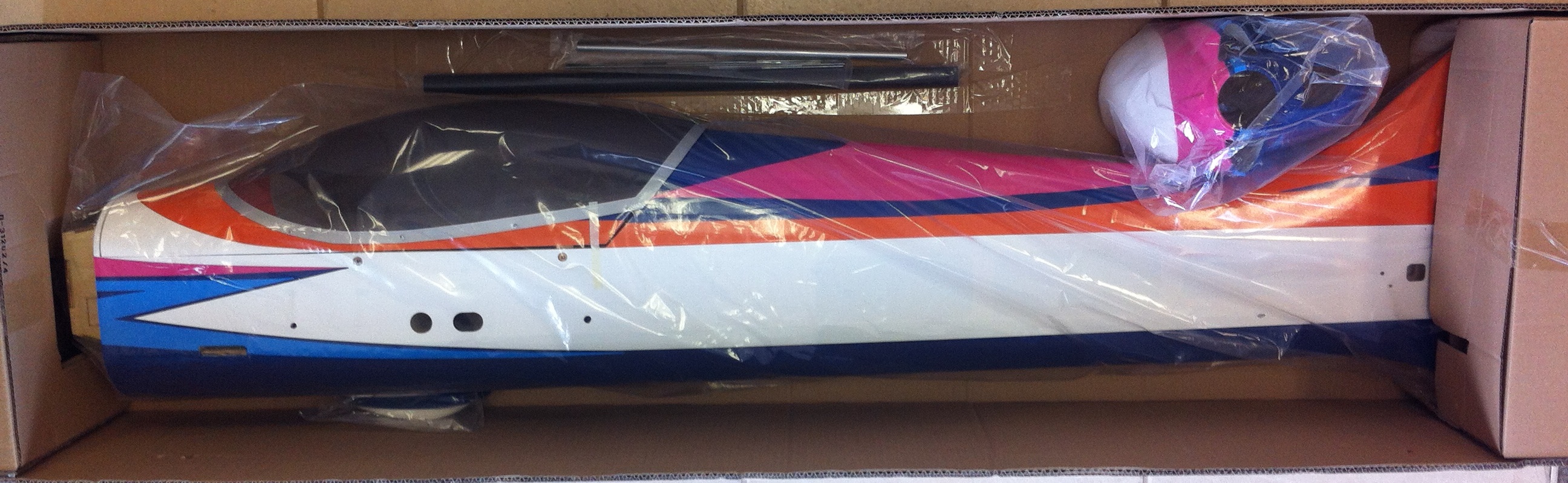

Opening it up, the airplane box was undamaged. Not bad considering my last plane delivery from UPS.

Here you can see the parts bags in the larger end box, the fuse, cowl, wheel pants and tubes in the center and the landing gear legs in the small end box.
