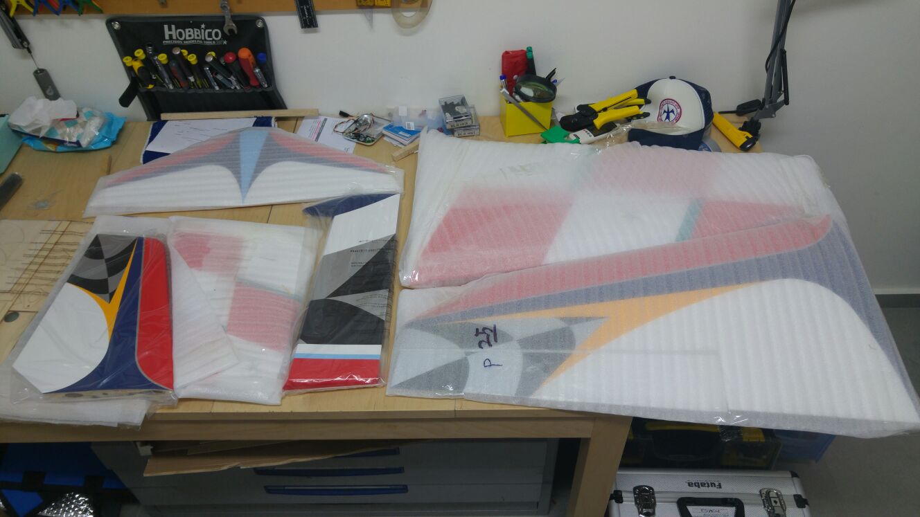

Hi Paul,
According to Ken Moss in the UK the recomanded CG is to back, he took it about 2 cm forward for better control.
I am curntly assmbling my Agenda and will go with 171sv all the way. drive setup I want to install is V4, I hope it will soon be produce :)
Here are some pic's of what I did so far. (not too much)

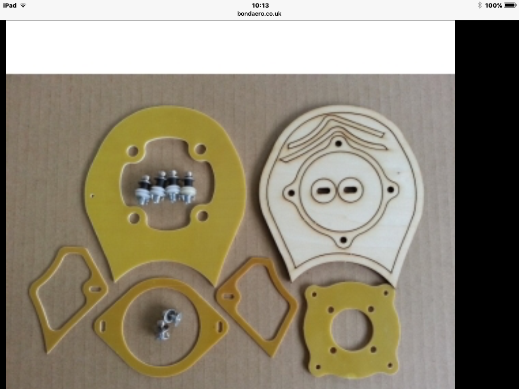

Thanks Ram. I see you have a removable rudder? I think you might get a V4 in January maybe! I will stick to the V3 for a while. I've a firewall/ motor mount the same as for the Inspire on the way to me.

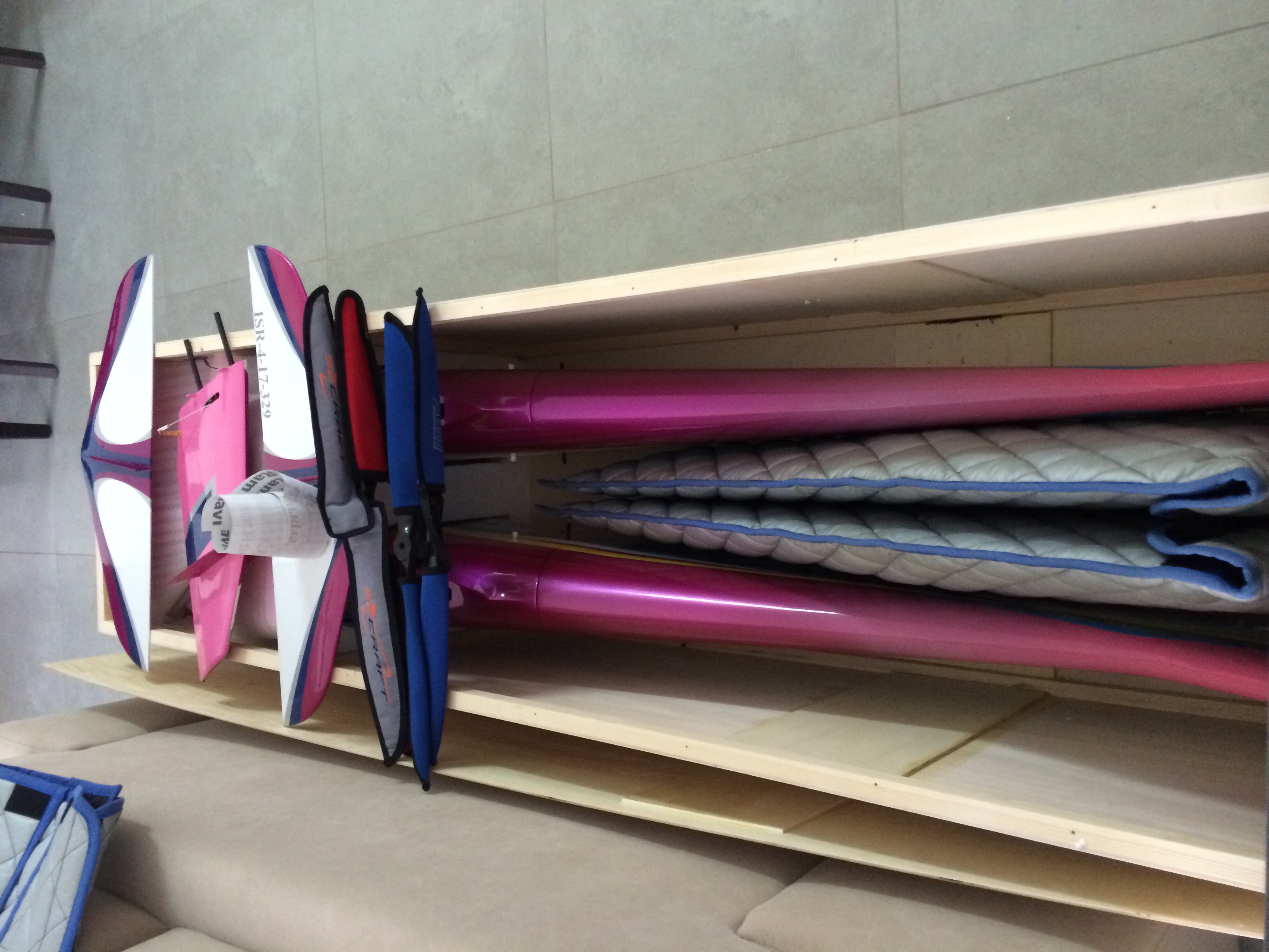

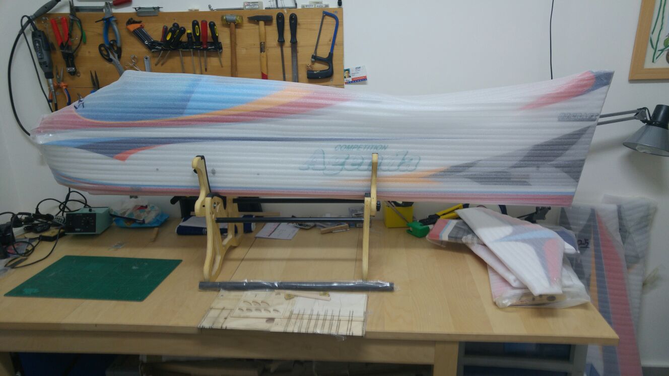

As I live in Israel and fly often to world cup events in Europe, I need to have a transporting model box.
A removable rudder saves about 15cm from the box length and help me go easy in to hotels lift's.
The total length of my box is about 190cm. Attached is some photos of the box. (the best I could find this morning):p

I am not familiar with your firewall on the inspire. a photo will be great.
As I have never had weight problems with BJcraft models I stoped weighing them before assembling.

Very neat packing. I used to travel with a plane box also but I had 2m one.
The motor mount/ firewall has rubber grommets which give the soft effect. I think it works very well and was so easy to install.

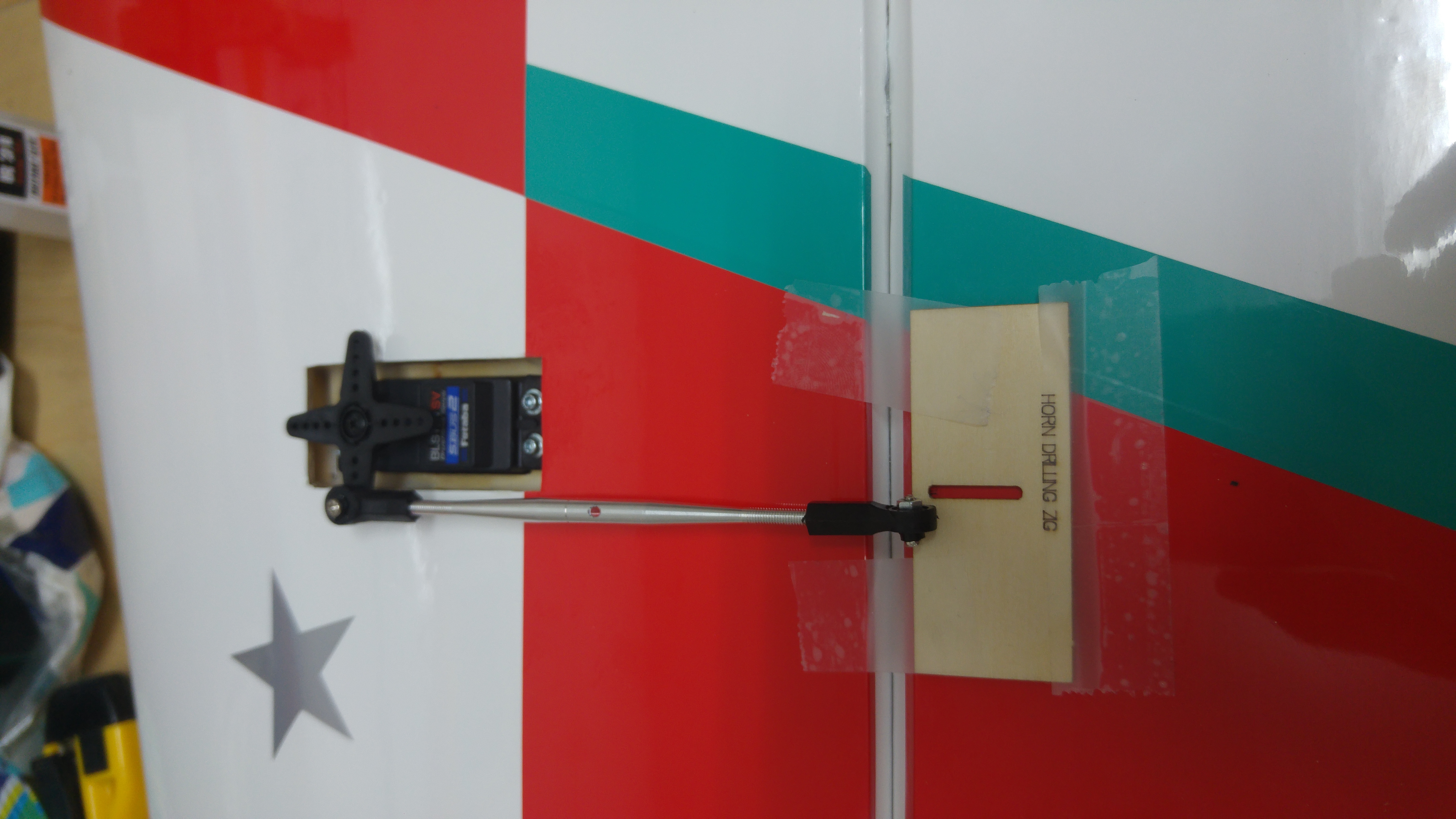

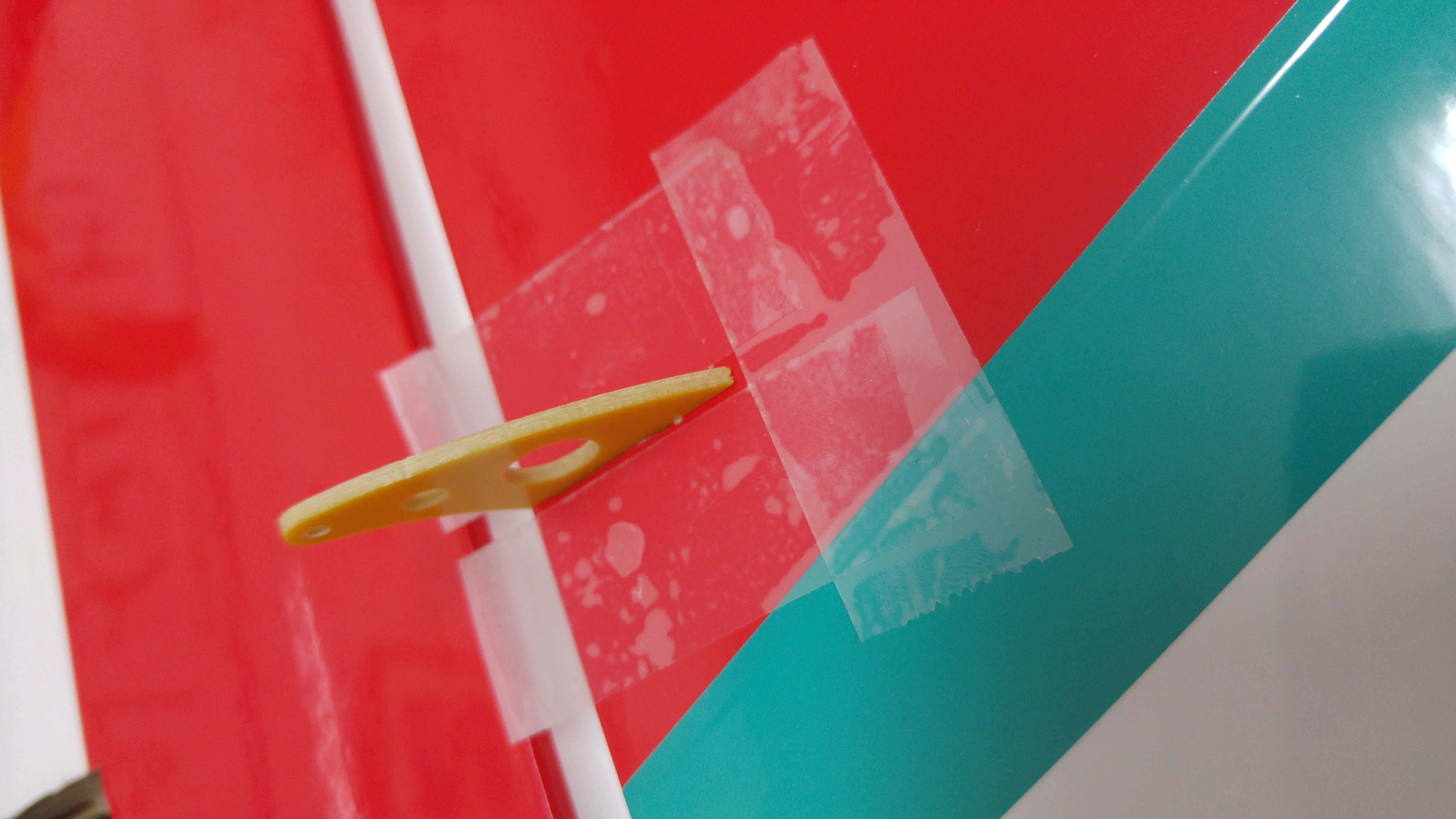

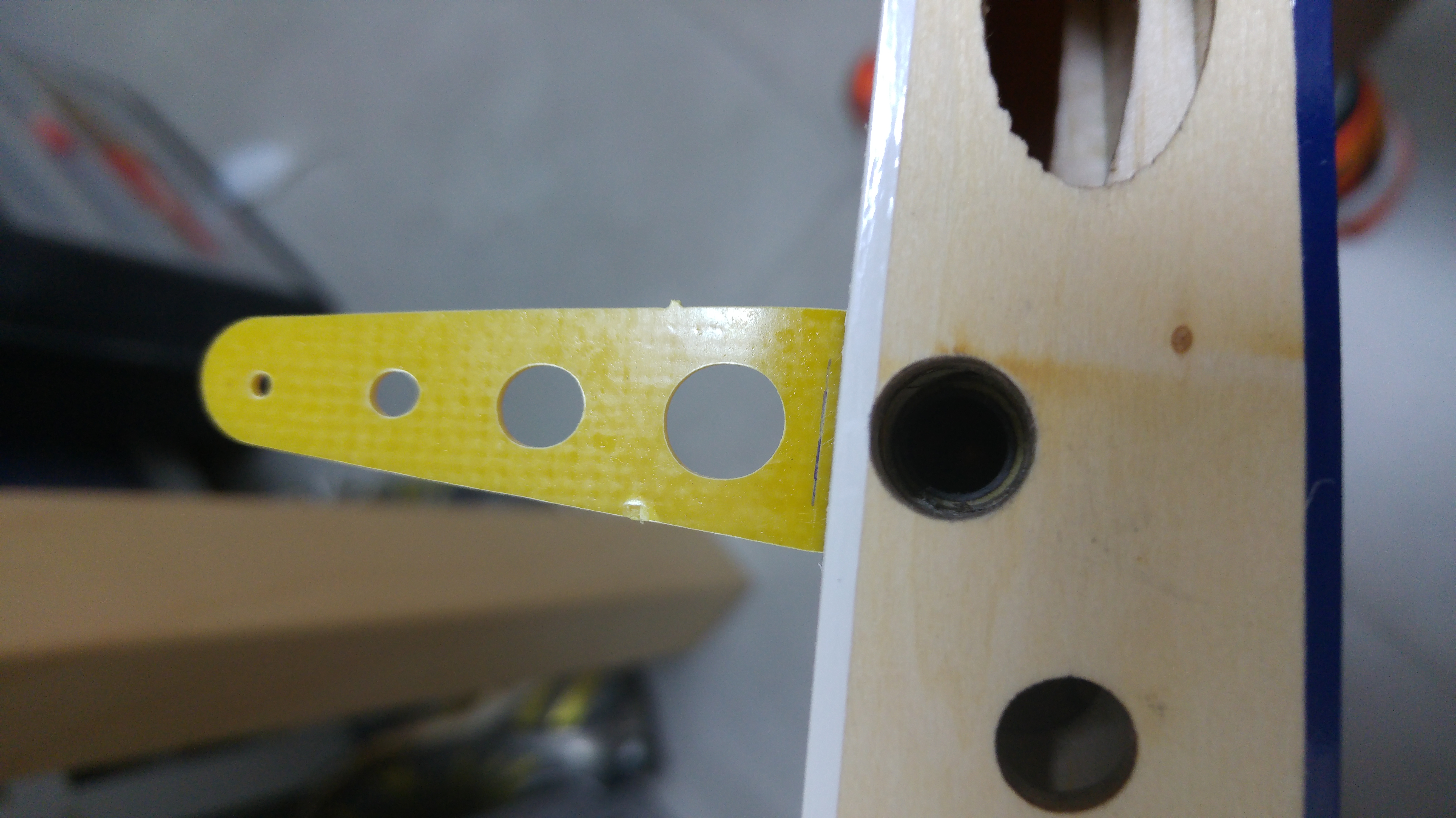

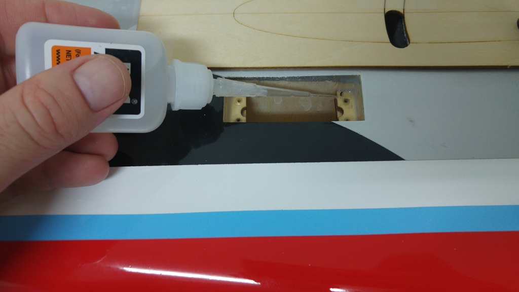

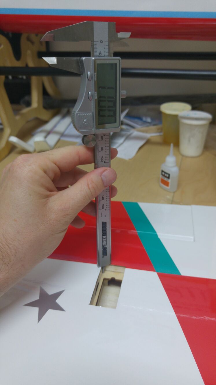

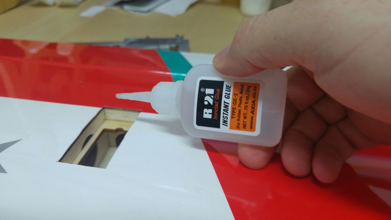

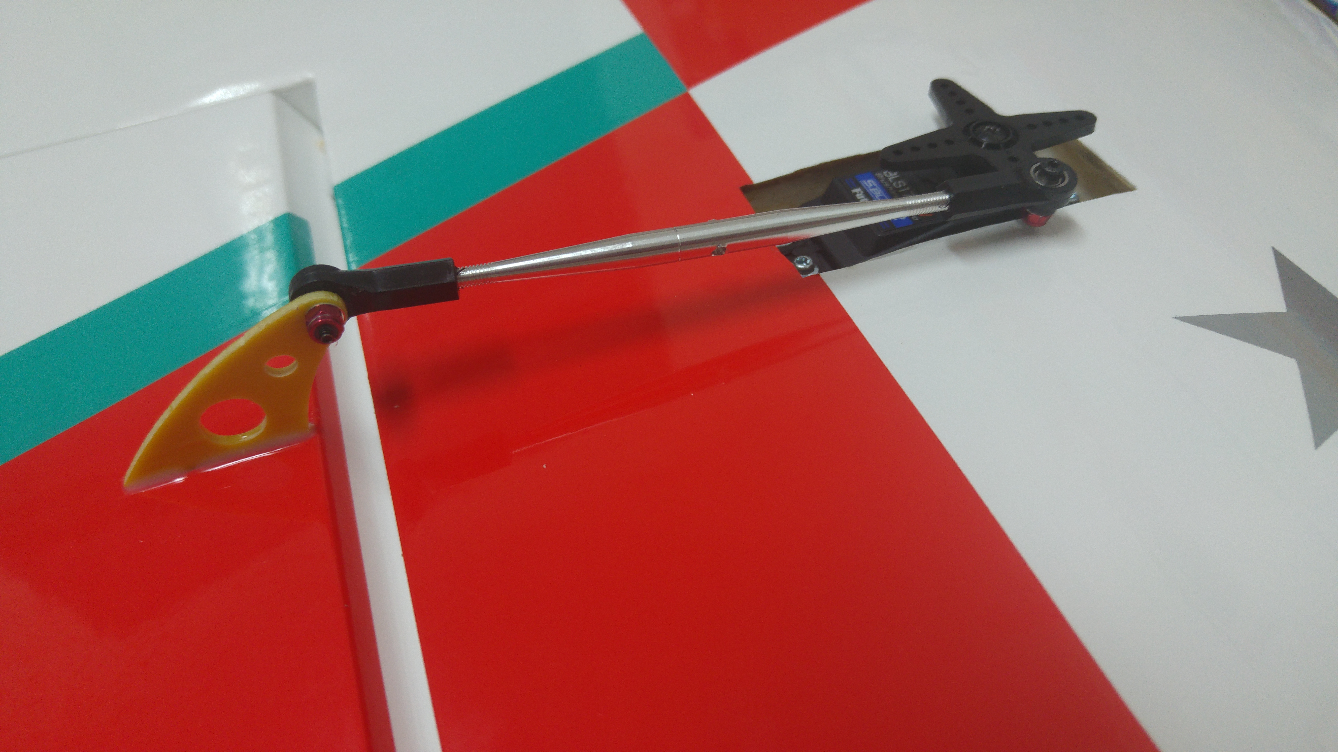

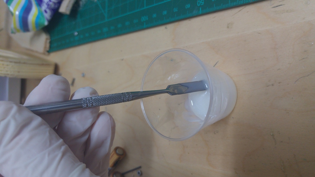

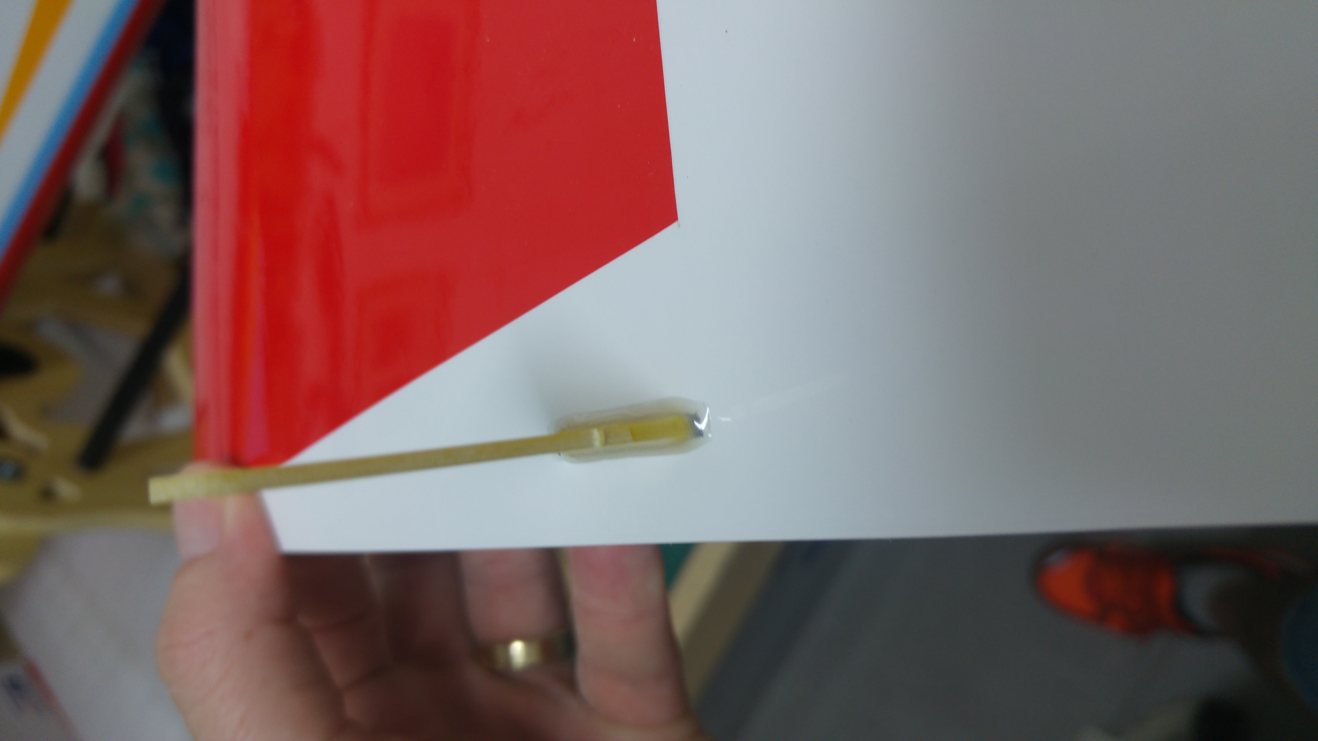

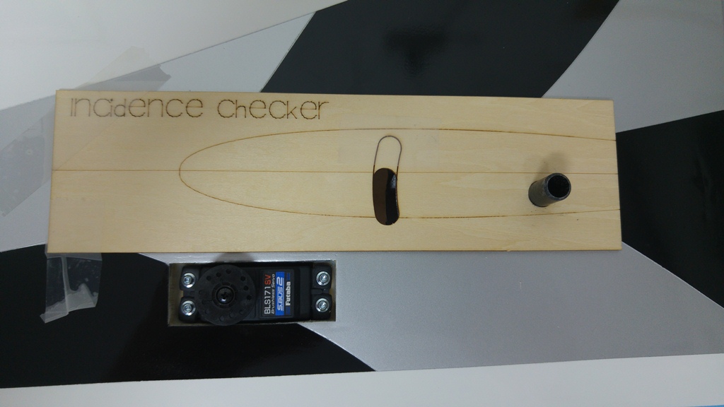

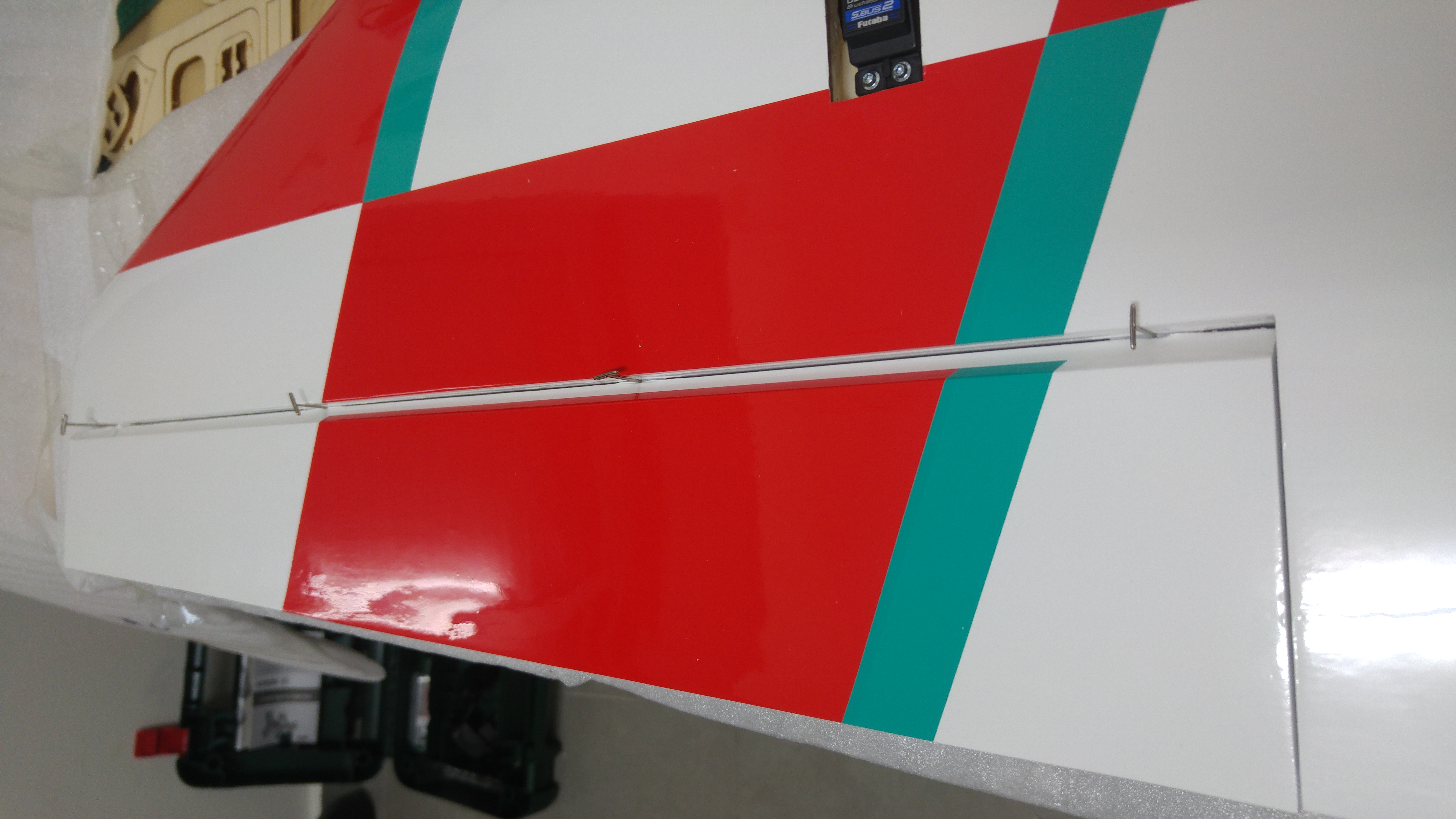

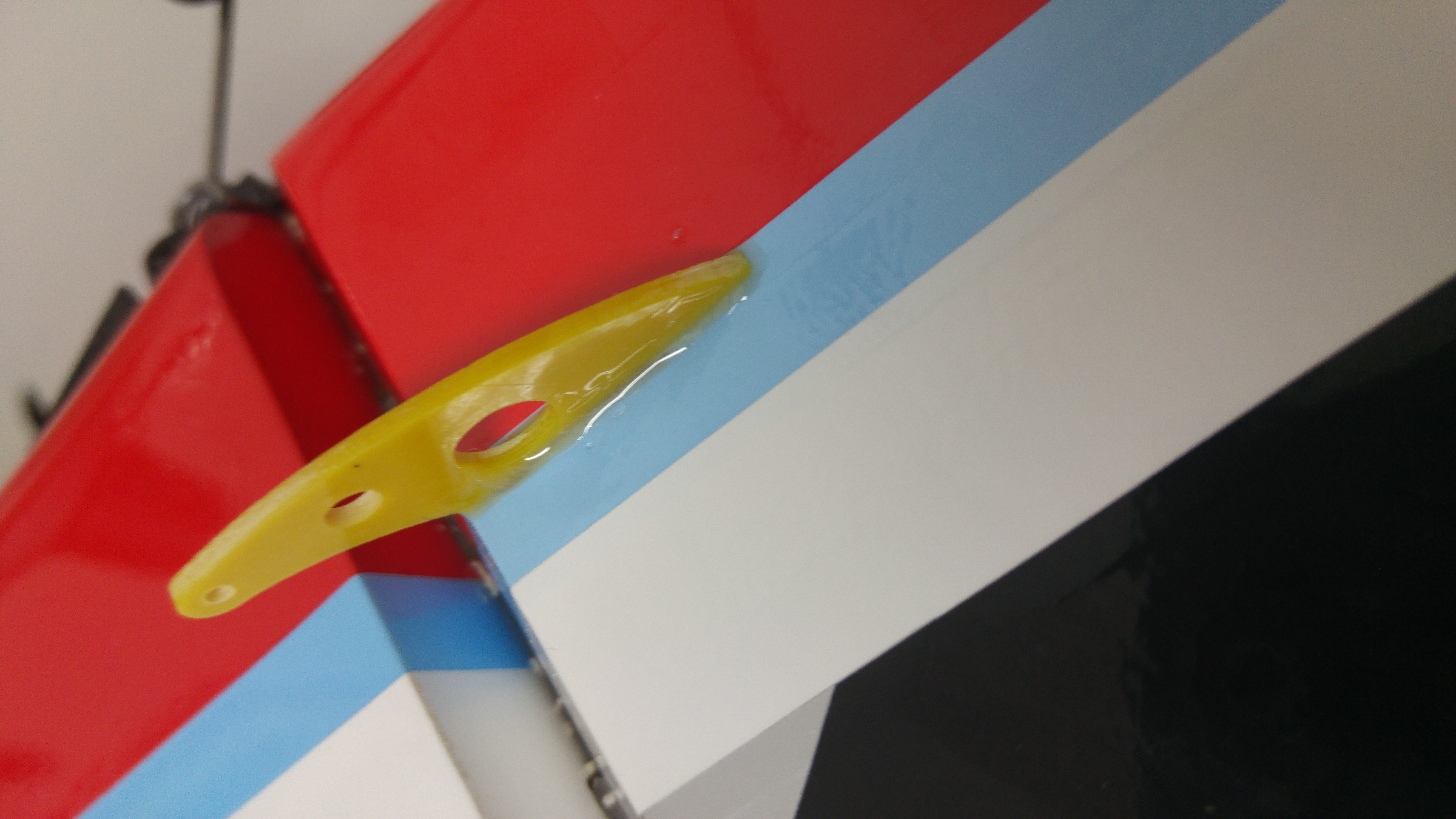

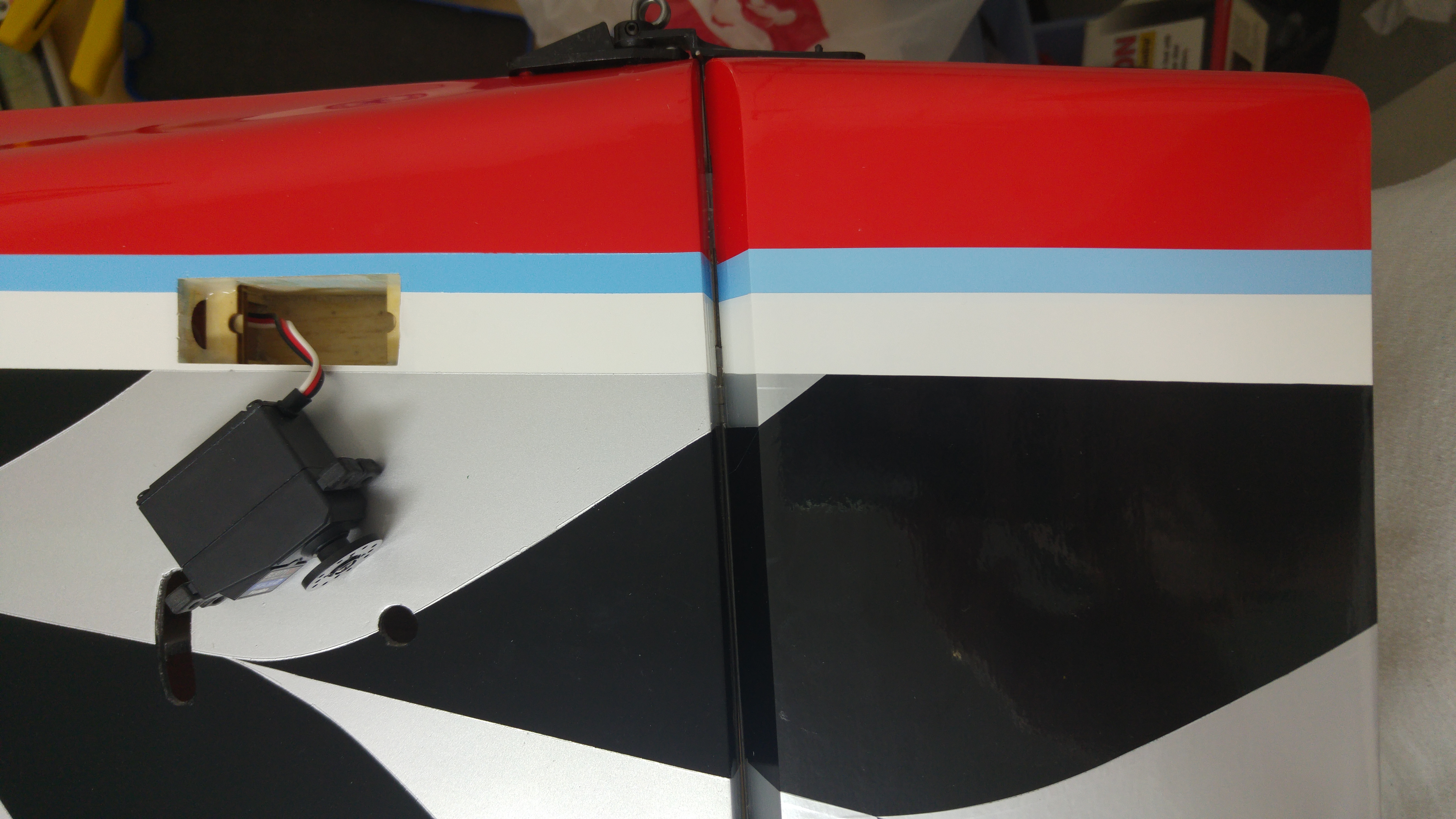

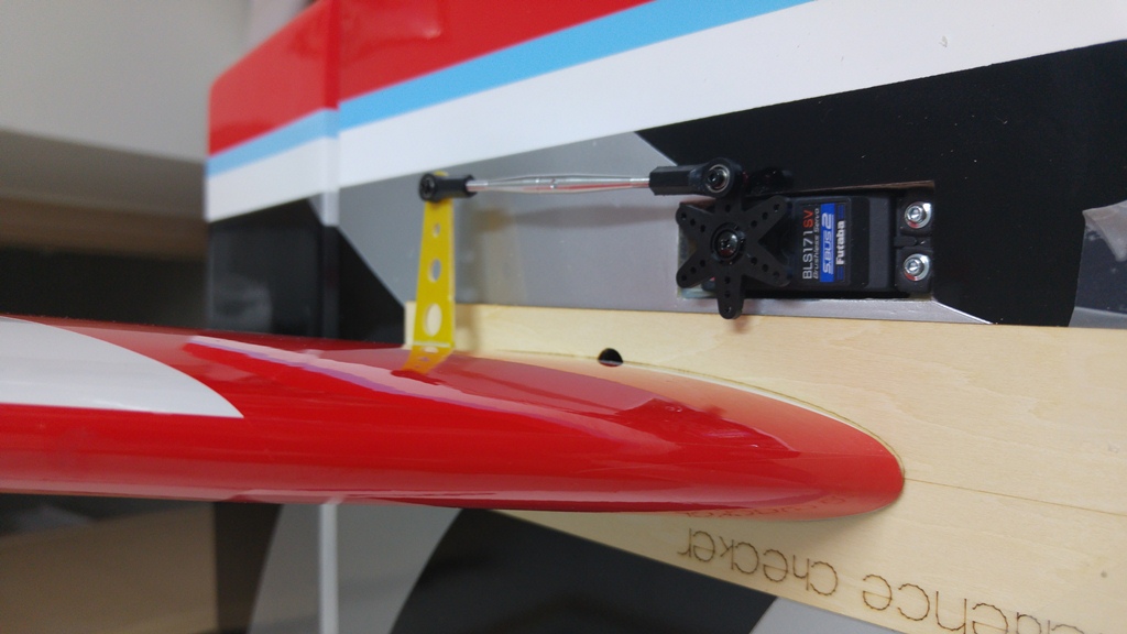

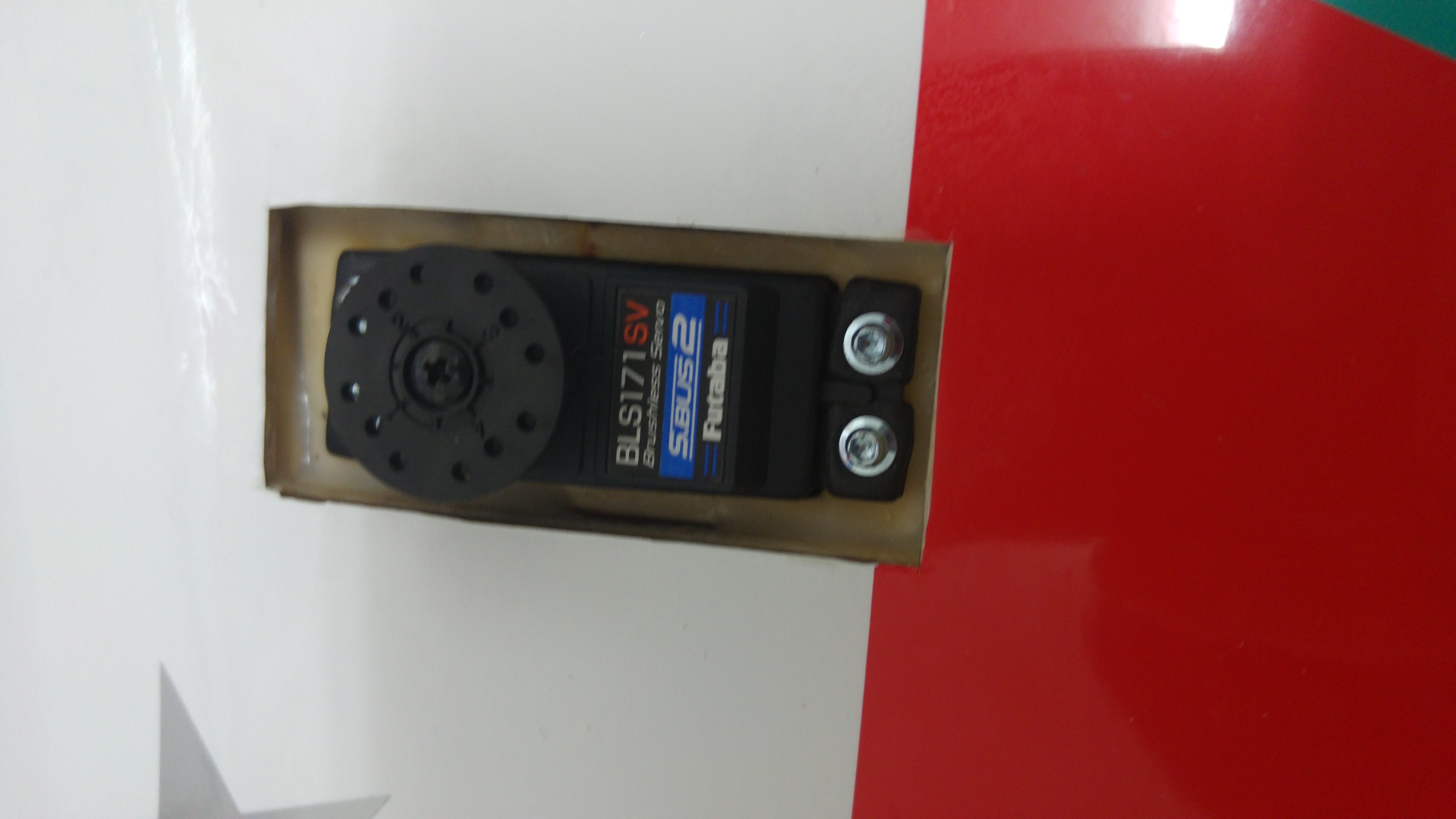

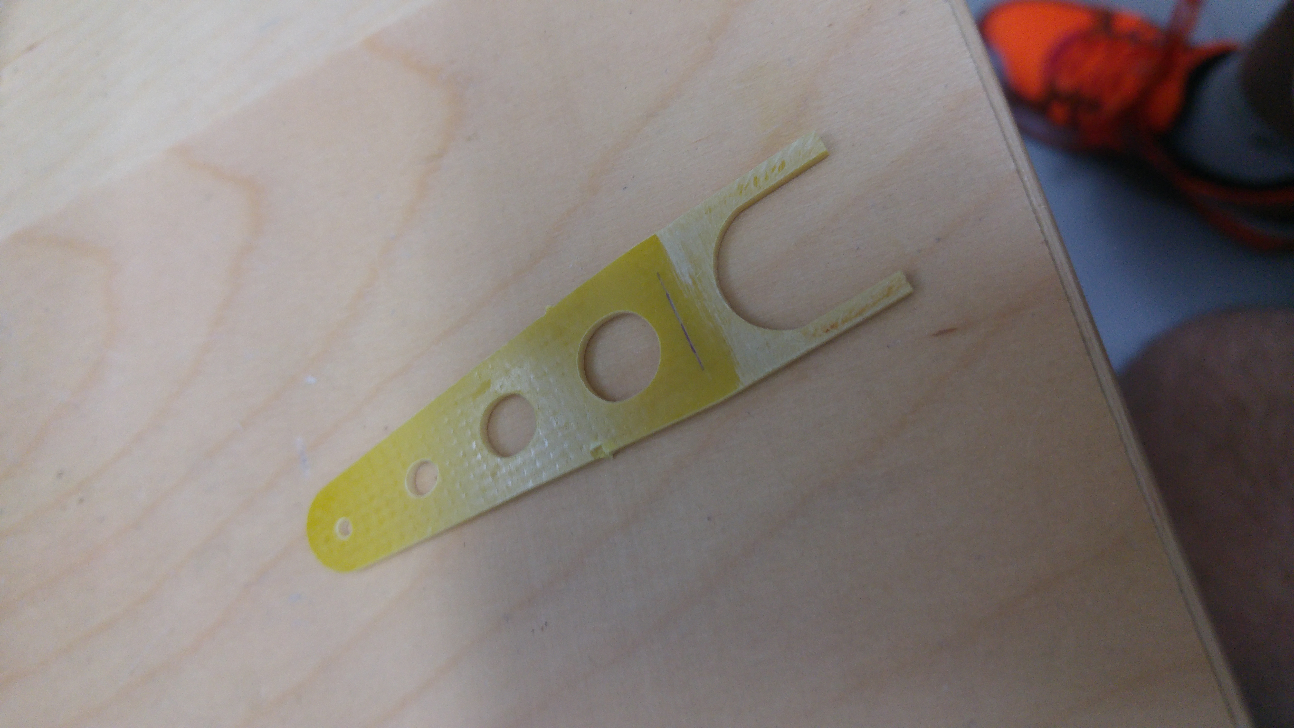

Usually I likes to use few drops of CA to fix the servo mounts in place and then make nice clean 3M 460 Epoxy on it.
I use the same Epoxy to glue the control horn

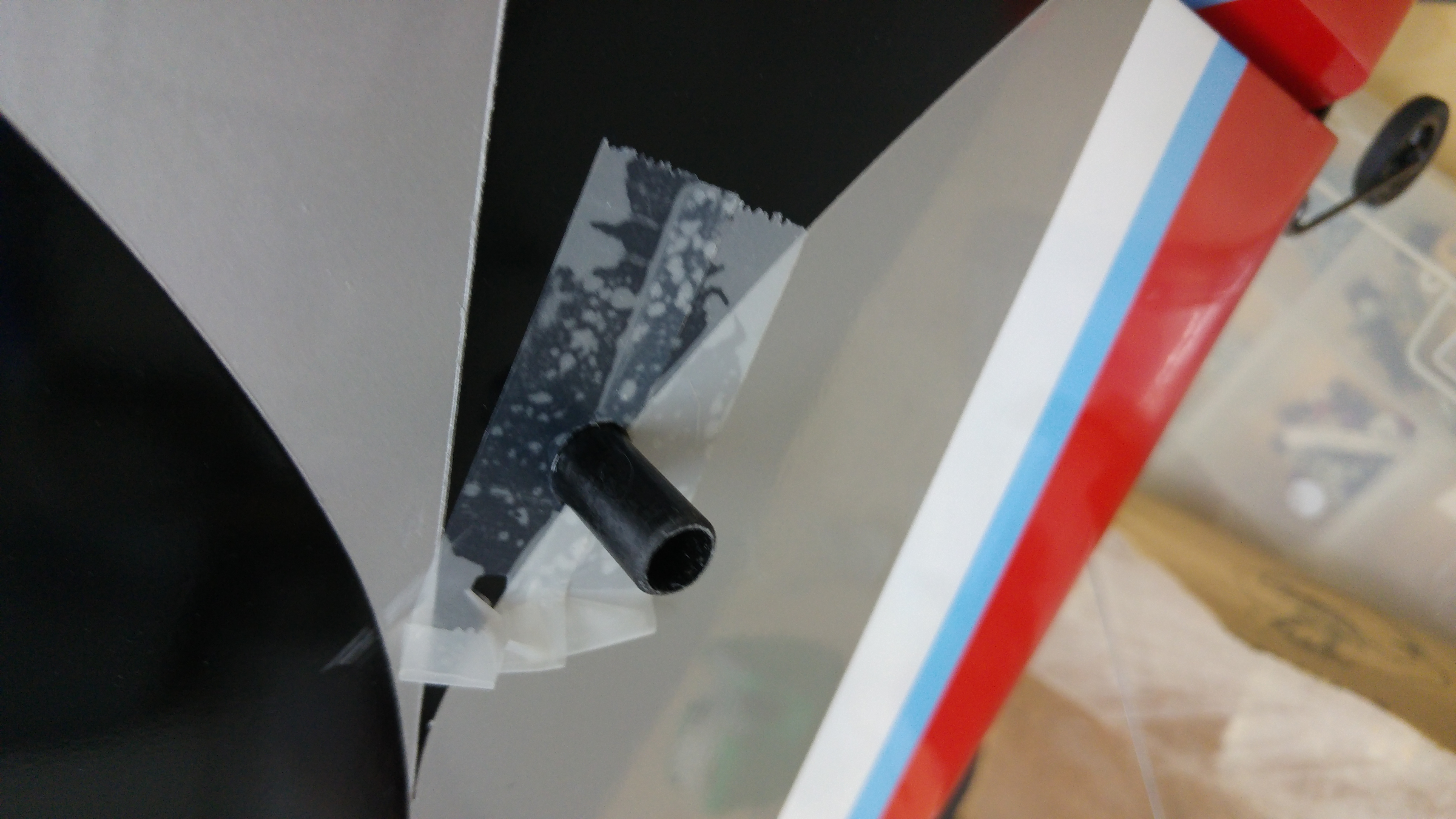

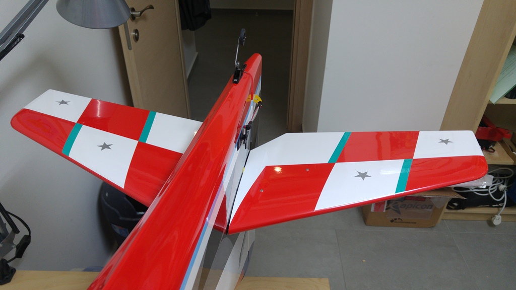

ram_z 11-28-2015 12:40 AM
12 Attachment(s)

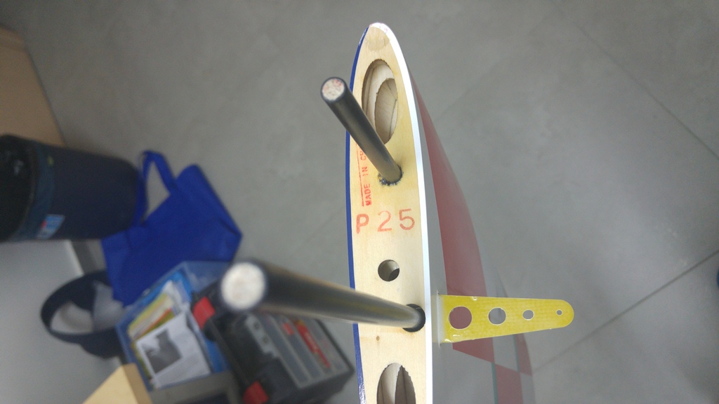

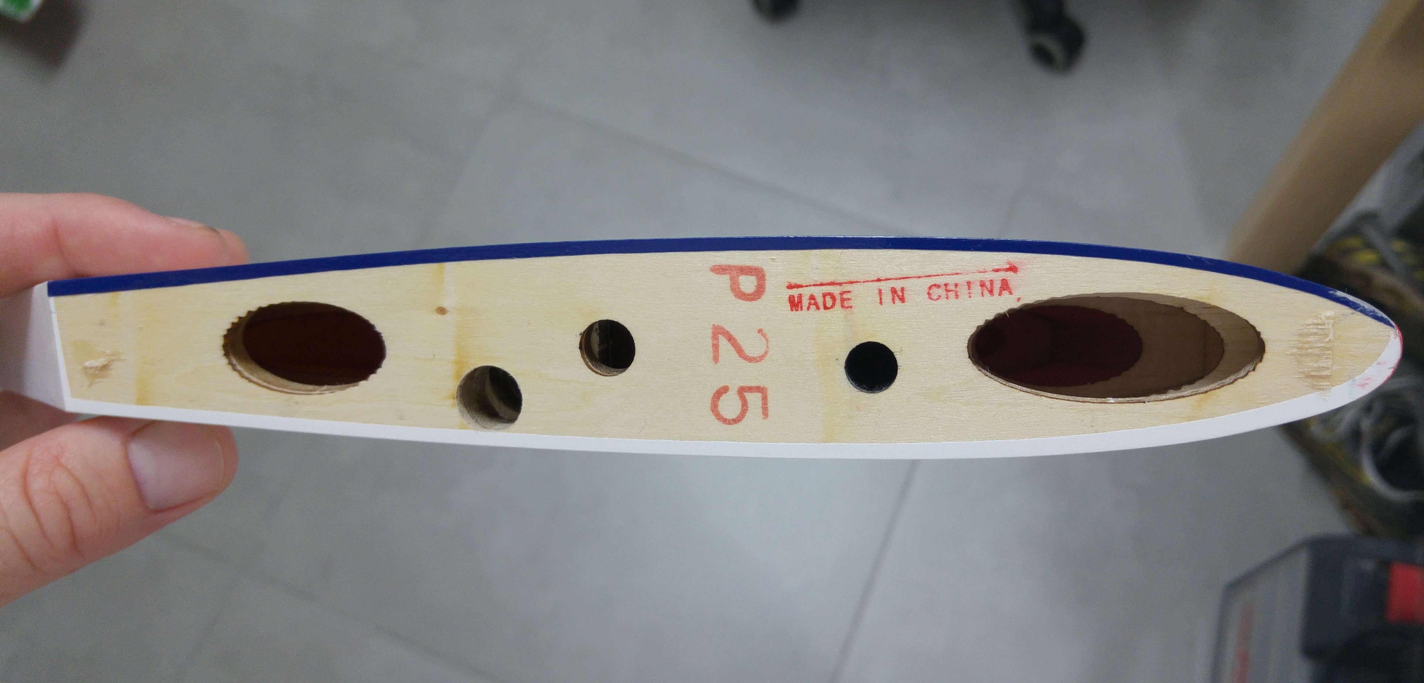

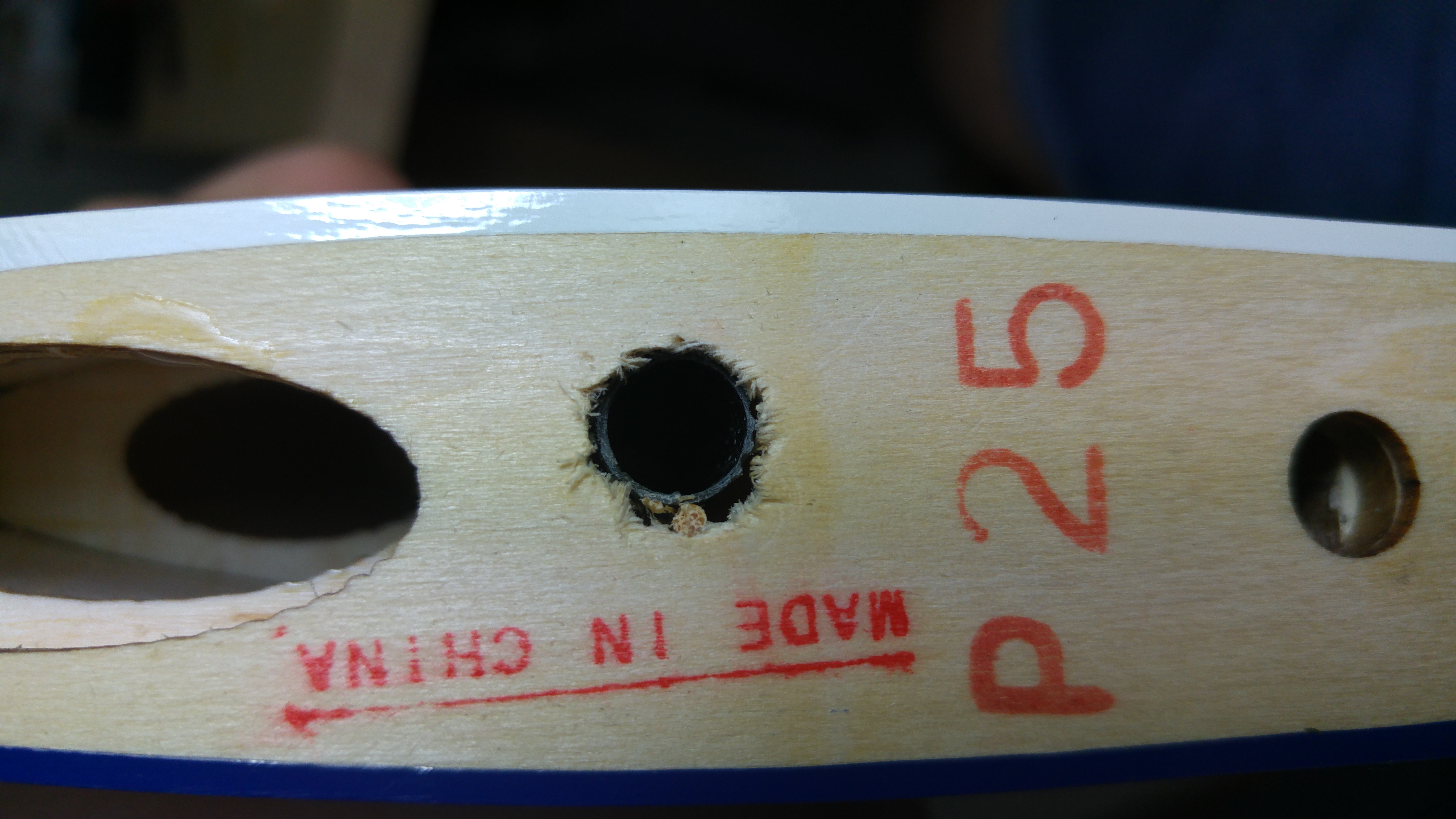

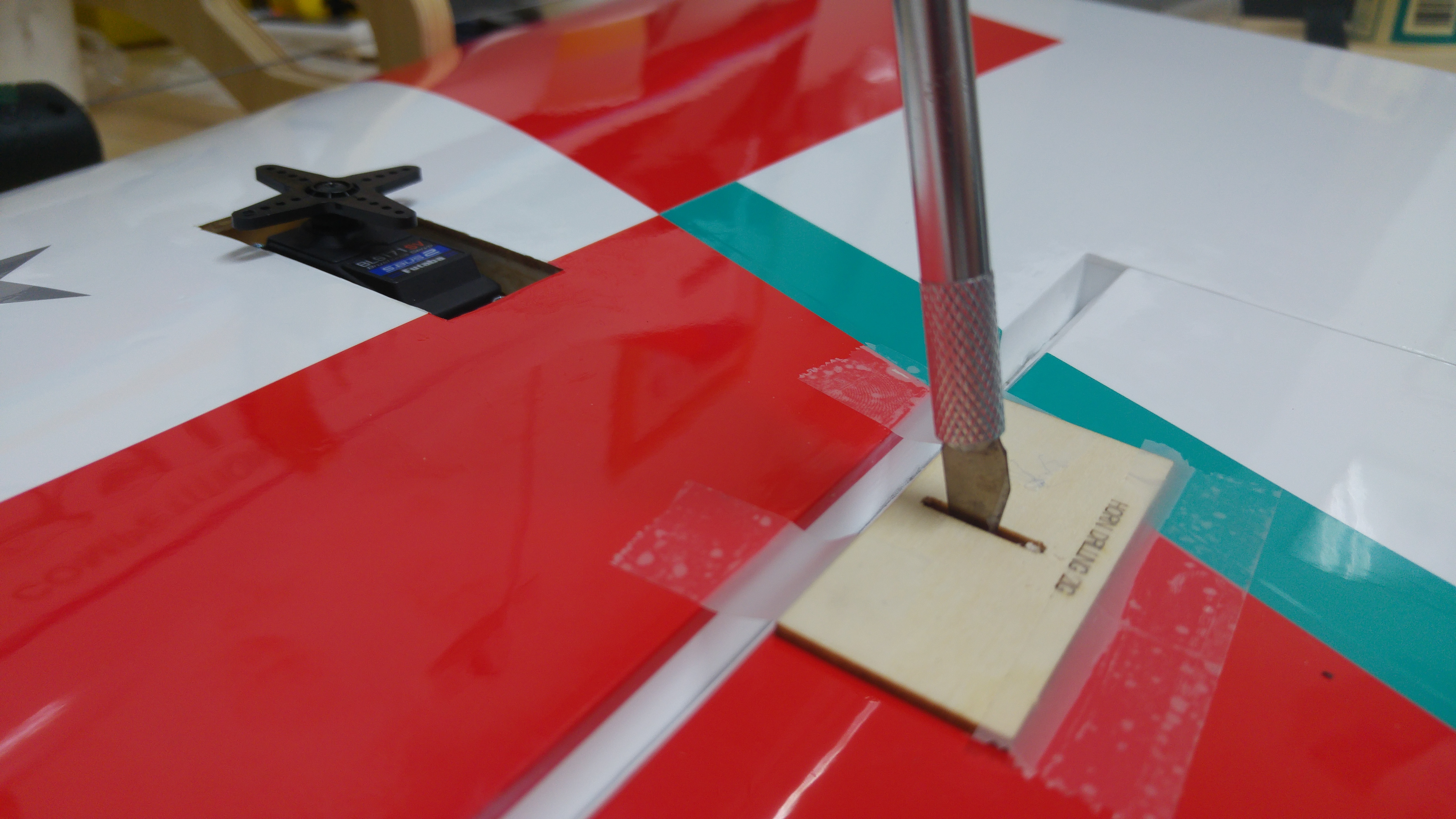

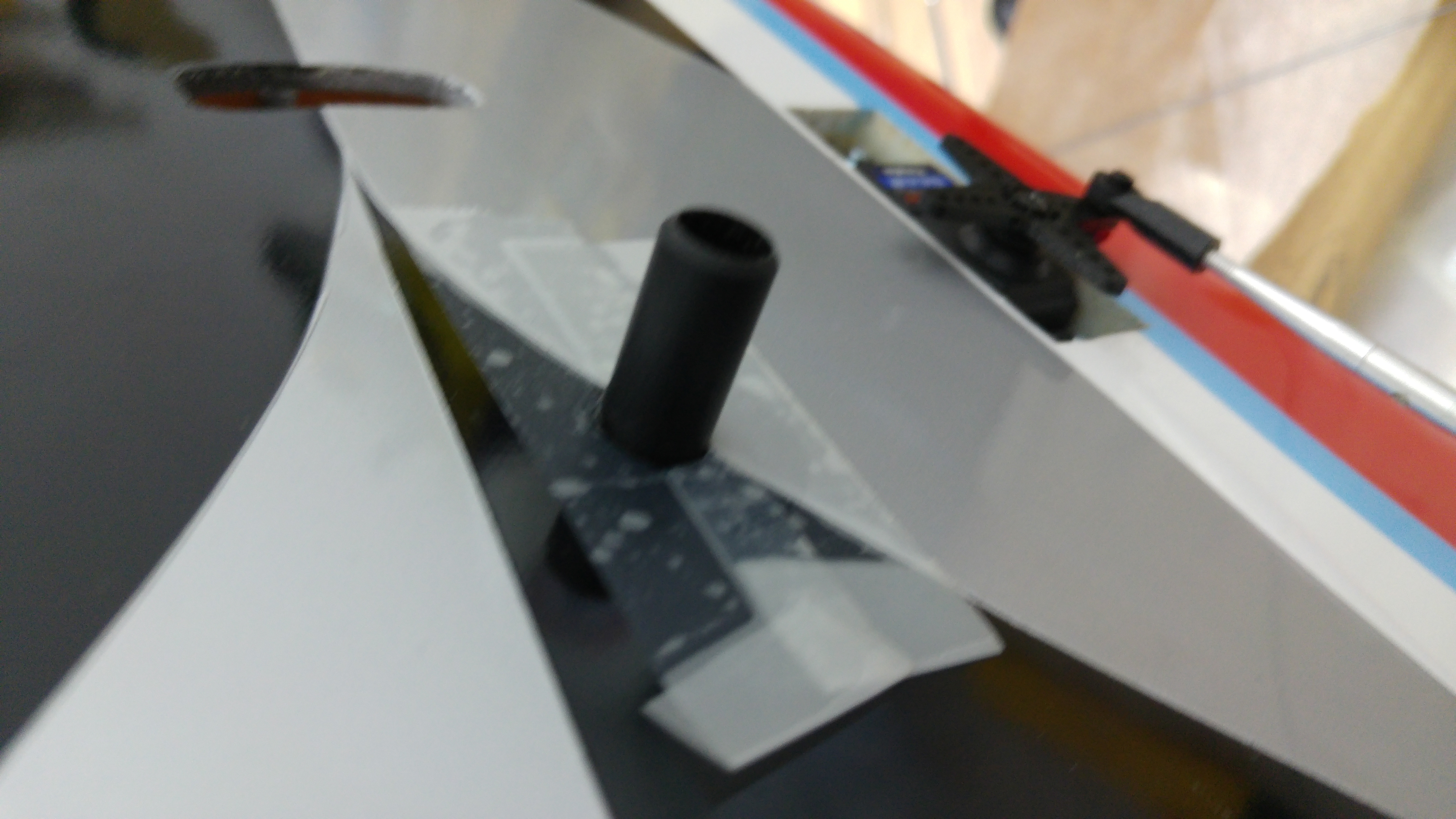

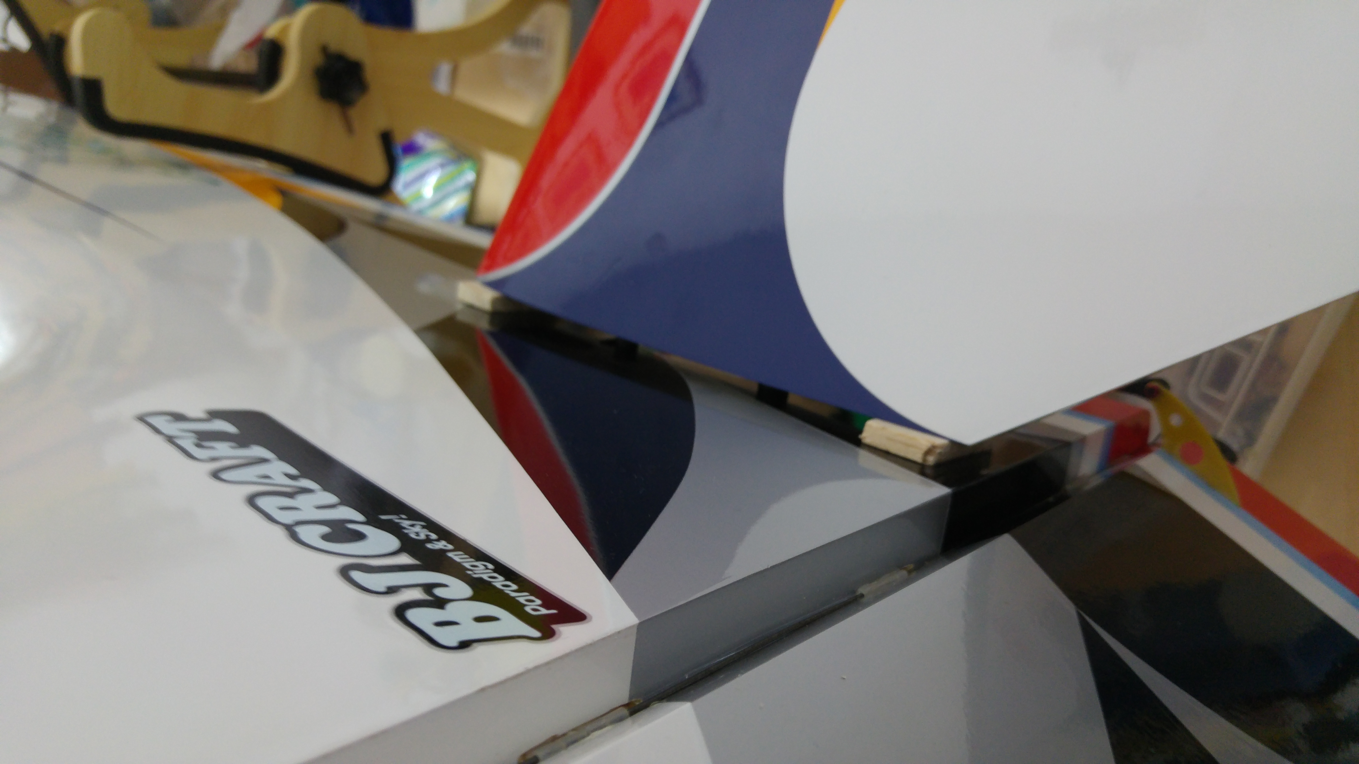

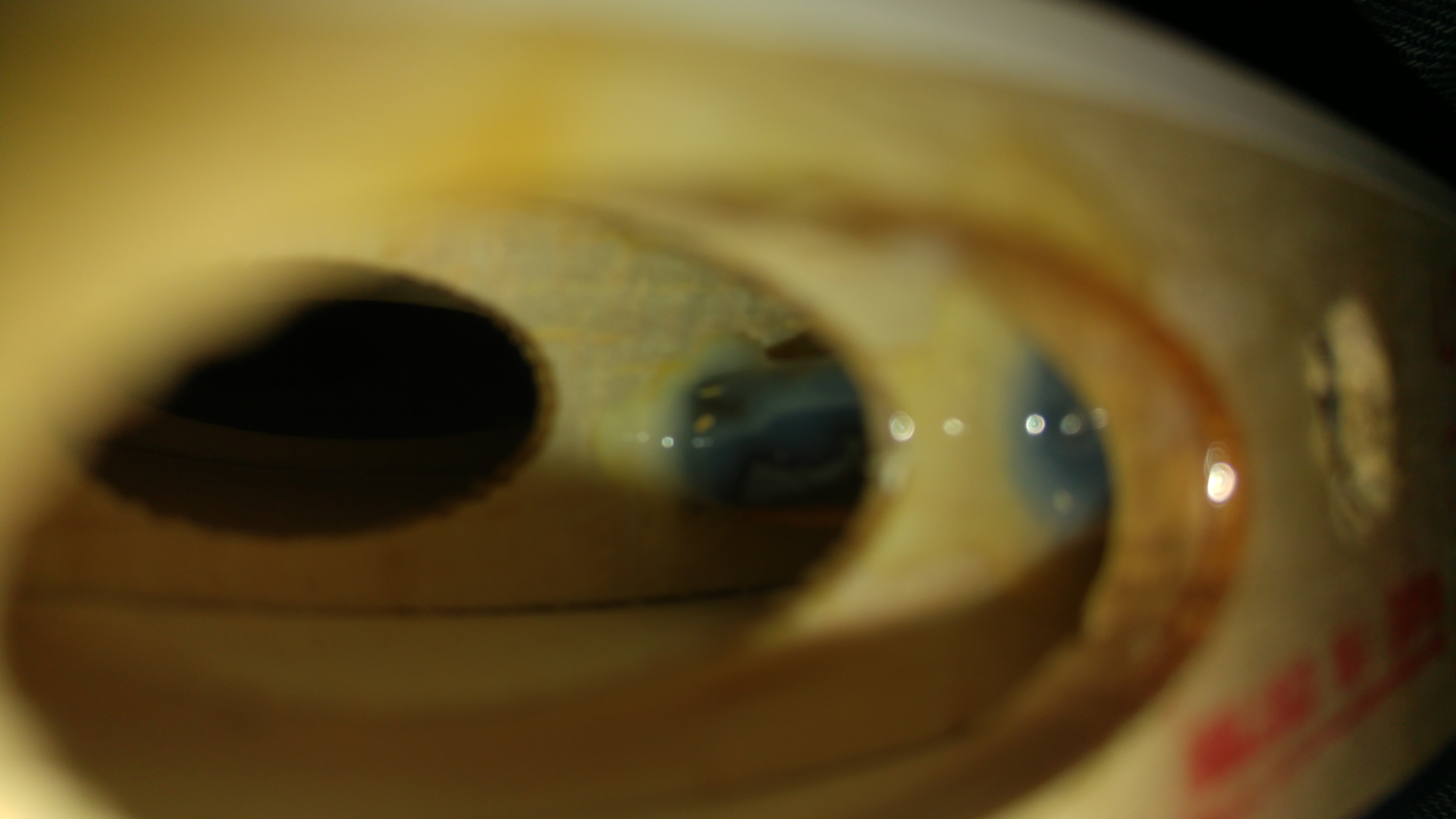

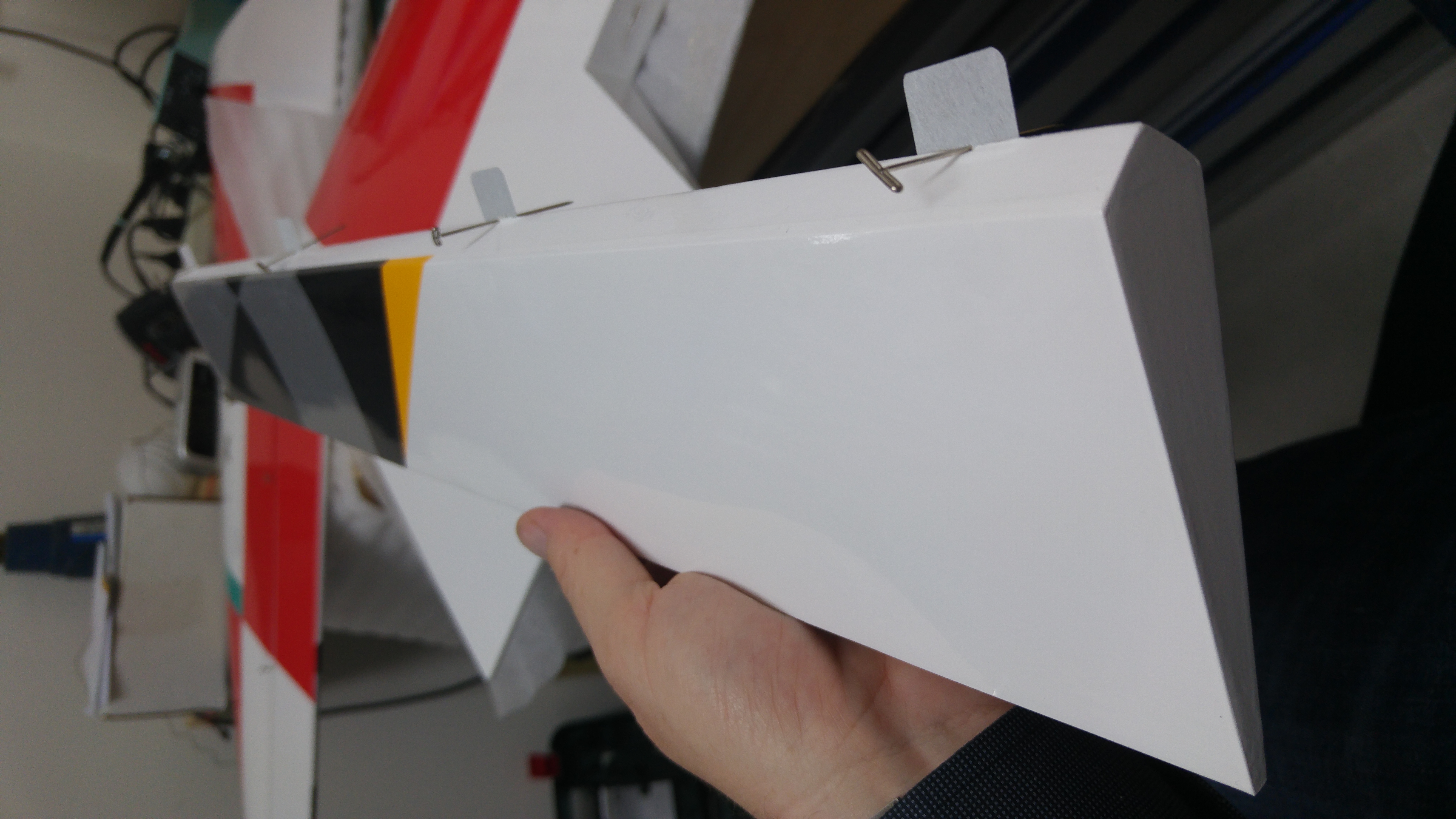

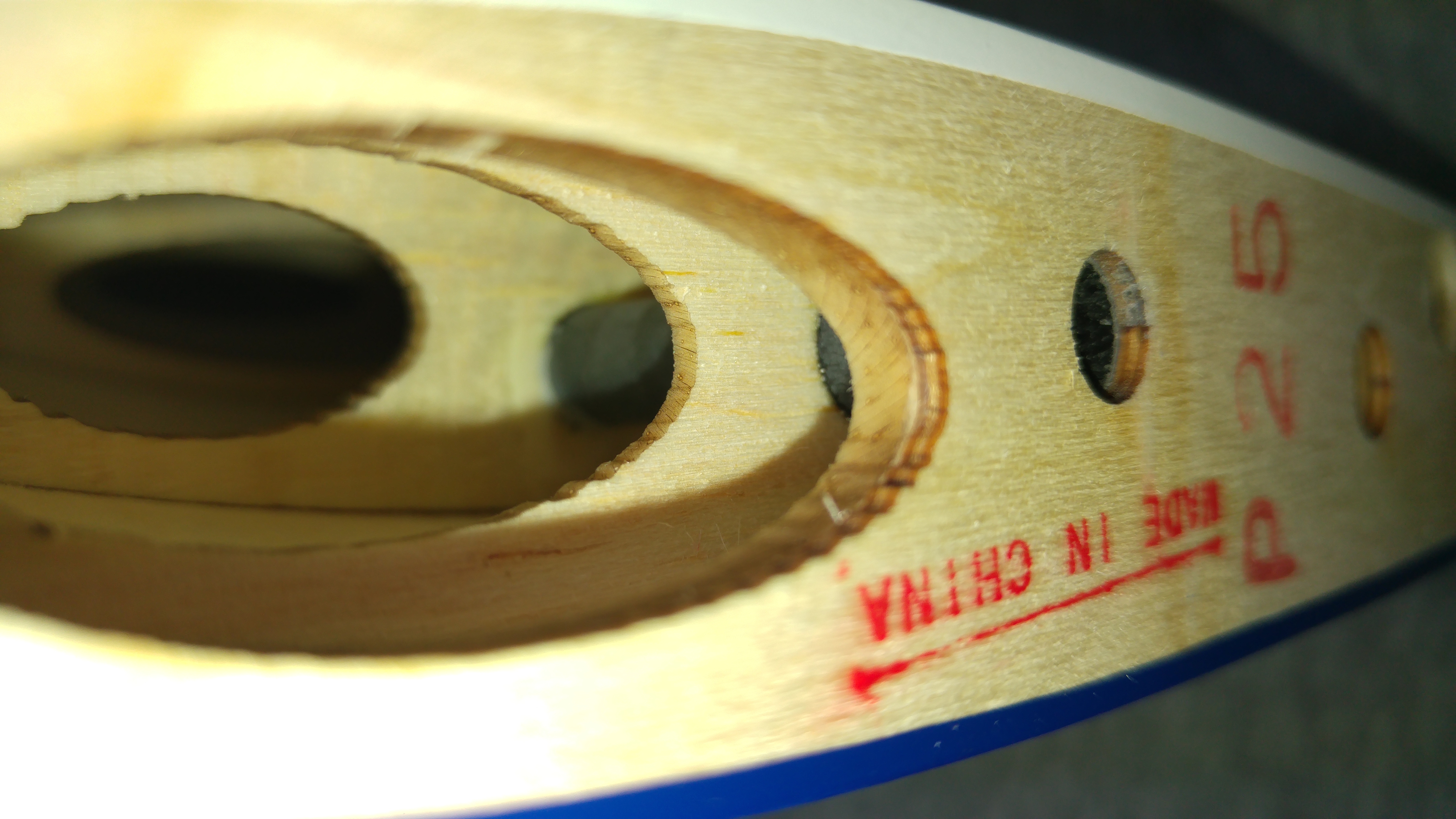

As someone said before in a different thread, the hole for the main elevator sleeve needs to be sanded due to the paint that goes in.
Before glueing the sleeve in place it is a must to check that it is in the correct position.
http://www.rcuniverse.com/forum/atta...mentid=2132854

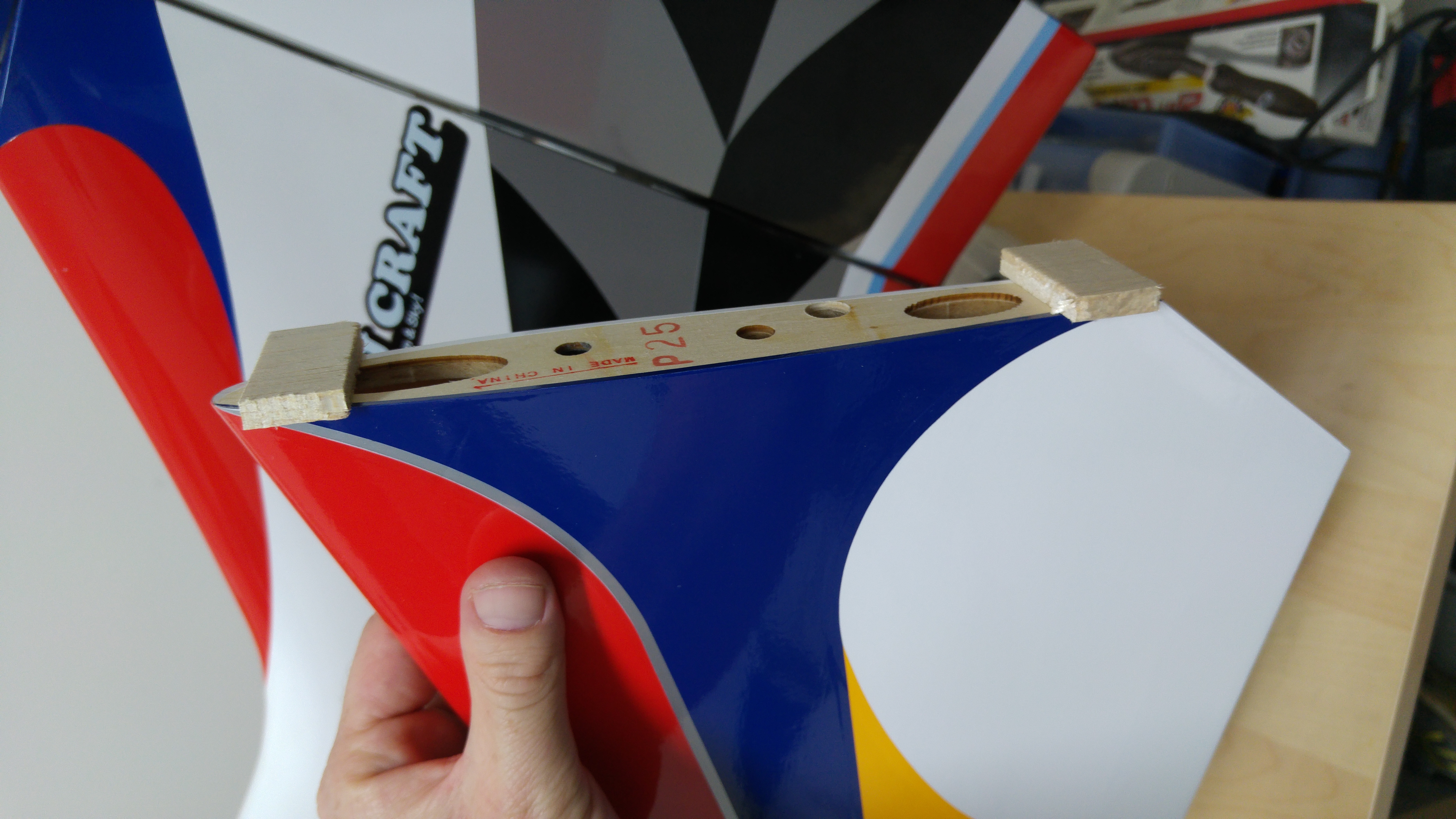

Then, after ensuring that the sleeve is in the correct positioning, it's time to glue it in place. I glued a temporary 2 pc' of 6mm Balsa wood spacers on each stabilizer half.
those spacers will ensure that the sleeve will be glued in the correct positionn without glueing the satbilizers...
I am also using 3M 460 Epoxy here.
As always I use a tape to keep the area clean.
http://www.rcuniverse.com/forum/atta...mentid=2132855http://www.rcuniverse.com/forum/atta...mentid=2132856http://www.rcuniverse.com/forum/atta...mentid=2132857http://www.rcuniverse.com/forum/atta...mentid=2132858

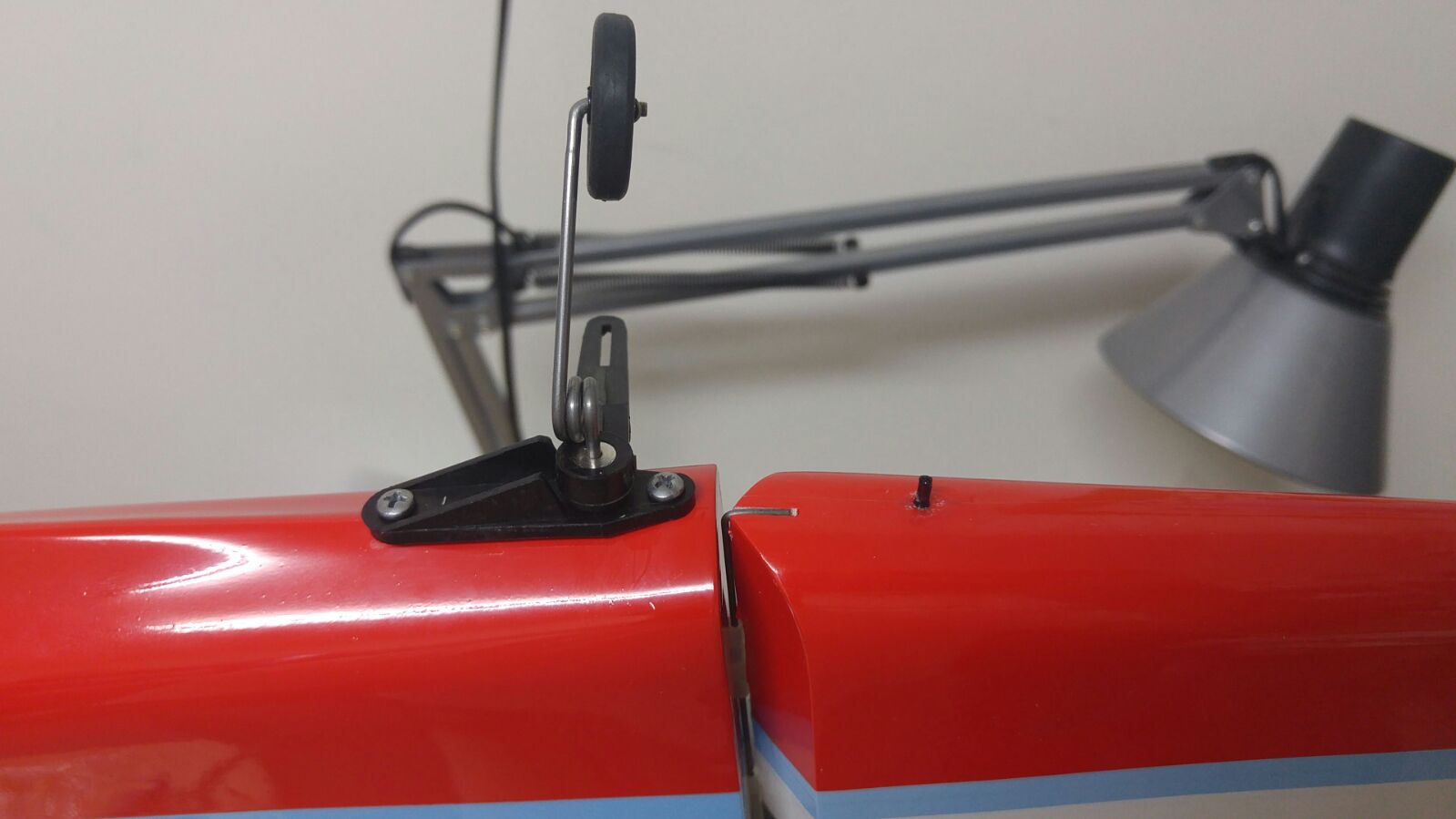

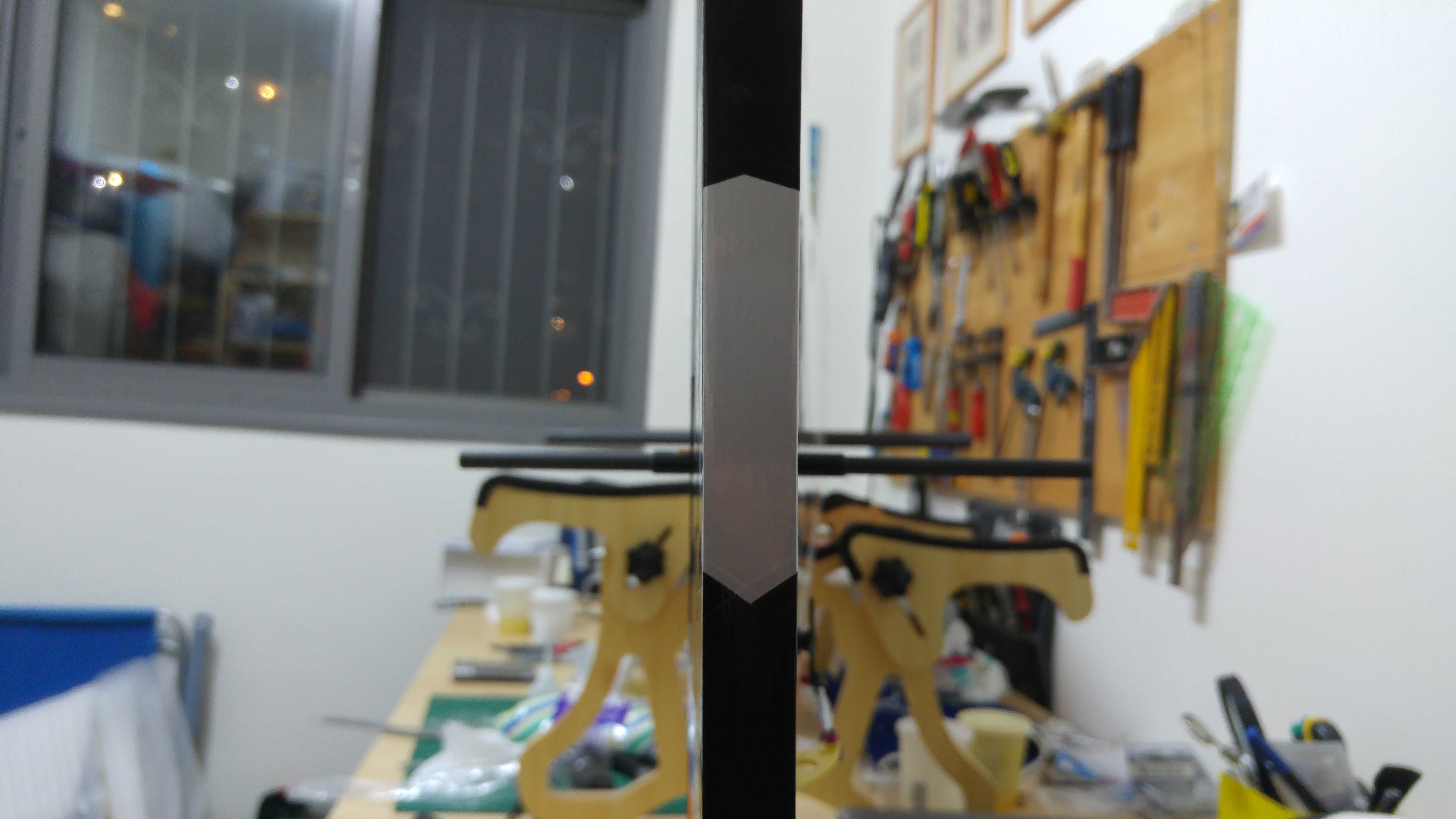

Later after the glue has cured, I found out that the two halves of the stabilizer are not parallel. There was about 1 degree difference between the both halves.
so I have to make an unexpected "surgery" to correct this glitch.
After consulting with B.J. I started the so called "surgery".
It was much easier than I could imagine, about 15 minutes and I then I waited to the glue to cure.

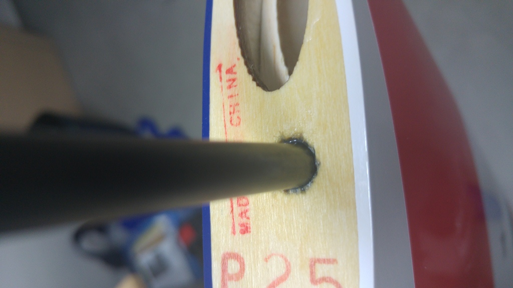

The process was simple. Around the front sleeve of the Left stabilizer, I drilled 1mm holes through the two first ribs to disconnect the sleeve from the ribs. then I could have a play to correct the angle.
I insert a small wood rod (about 1.5 mm thick) between the sleeve and the ribs. assemble it on fuselage and checked with incidence meter. it was perfect! I disassemble the left stabilizer and glue the sleeve in the new position using Epoxy.
also use the mixed glue to glue the control horn.

9 Attachment(s)
Normaly I set the starting point of the CG without the canopy, the final CG will anyhow be determined in flight.
meanwhile, I had some time to proceed with the assmbling which goes very easy.
with the next pic's I will show how I finished the assmbling of the stabilizer.

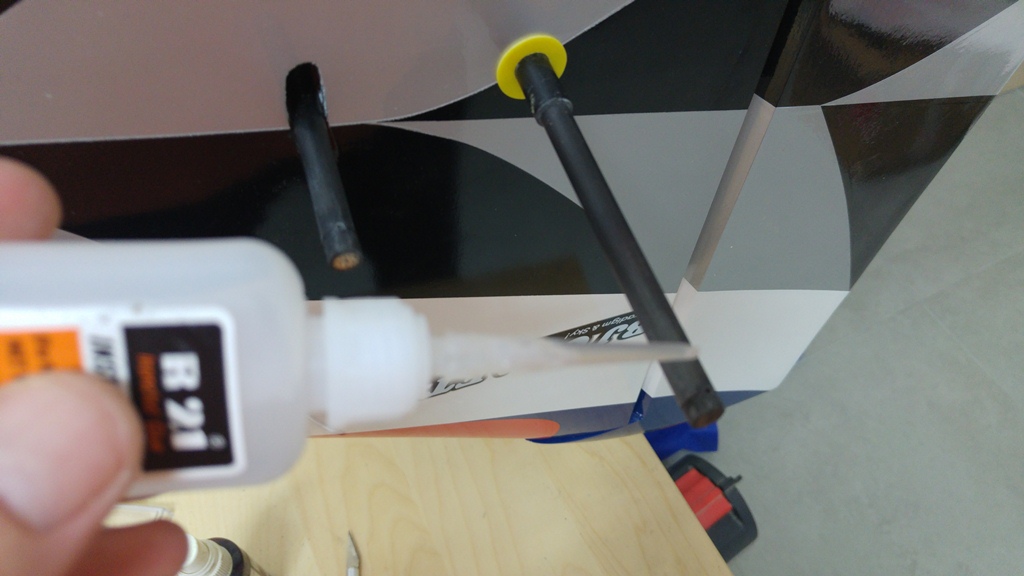

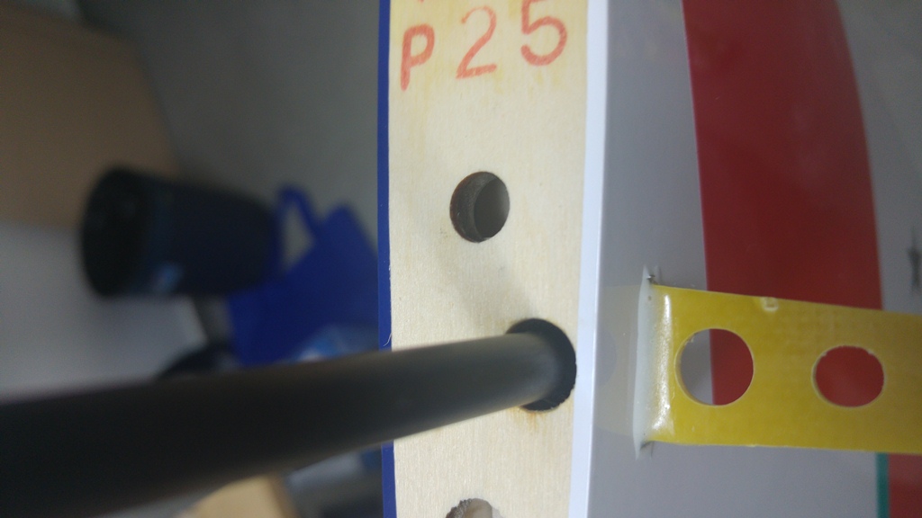

The stabilizer halves are connecting with two carbon tubes. The tubes are glued to a sleeve on the left half, and 2 screws are bolted on the right half.
next pics show the tubes being glued with 3m Epoxy.
it is very important to keep the rod clean from glue as it might cause problems when slid it thru the main sleeve on the fuselage.
http://www.rcuniverse.com/forum/atta...mentid=2133754http://www.rcuniverse.com/forum/atta...mentid=2133755http://www.rcuniverse.com/forum/atta...mentid=2133756http://www.rcuniverse.com/forum/atta...mentid=2133757
Next pics, connection of the two halves together.
On the bottom part of the right stabilizer there are two factory pre marked dots which shown the location for the screws. all I have to do is slide the two stabilizer parts on the fuselage, hold it tight, and drill one hole for each tube exactly on the factory pre marked dots. Then, screw the two long bolt in place. I personally like to pour few drops of thin CA into the carbon/wood thread to make it a bit more robust.
http://www.rcuniverse.com/forum/atta...mentid=2133749http://www.rcuniverse.com/forum/atta...mentid=2133750

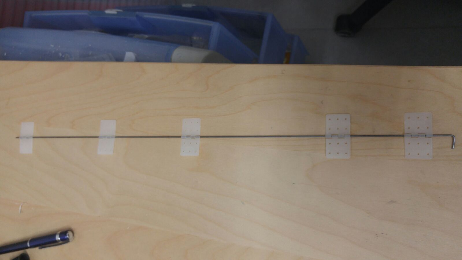

setup the servo and pushrod. very neat with the supplied jig.
http://www.rcuniverse.com/forum/atta...mentid=2133751http://www.rcuniverse.com/forum/atta...mentid=2133752http://www.rcuniverse.com/forum/atta...mentid=2133753

Hey Ram, what size linkages are you using on the ailerons?
ram_z 12-13-2015 12:18 AM
Originally Posted by rgreen24 (Post 12138559)
I am using a Secraft turnbuckle 90mm with hobbyking joints
http://www.hobbyking.com/hobbyking/s...idproduct=8265.
http://www.espritmodel.com/pushrod-t...raft-m3-2.aspx
