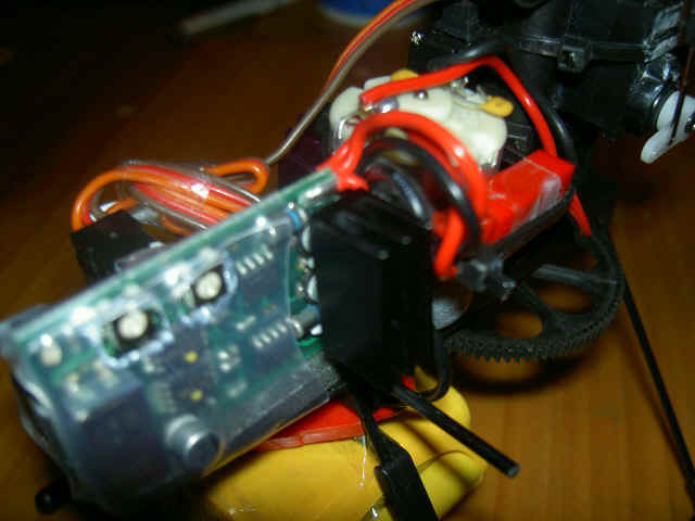

I've just bought a 2 cell 7.2v 1400mah lithium ion battery for my Aerohawk but it doesn't lift the heli off the ground[
Midland Helicopters state that it is suitable for the Fixed pitch Piccolo so I took a chance thinking the Aerohawk is a similar size but it didn't pay off.
Is the Piccolo a much lighter heli or is there something else I need to do to use li-ion baterries? Do I need the 3-cell 10.8v (don't want to cook the board) or is there a suitable upgrade battery anyone can suggest?
It flies well on the stock batteries but I want longer than the 6-7 mins flight I'm currently getting.
I use a Ripmax Mercury EX charger that has 7.2v 2 cell 1400mah setting so I dont think its a charging problem.
Any info appreciated [8D]

I used a 2 cell li/ion and got the same results,not enough head speed. So i tried a 3 cell on the standard motor and it goes like a bomb. i put a heatsink on the fet`s on the board just in case.
So far no problems with the board,gets a little bit warm but the motor does get a bit hot to touch.

I think your right quaker1. I've e-mailed Midland Helicopters to see if they will exchange it for a 10.8v 3 cell 700mah.
The motor gets pretty hot when using the standard battery so I'll probably just put some extra thermal paste under the heatsink and fit some extra heatsinks on the board.

Well the 2 cell Li-ion I bought lifts the heli about 6 inches off the ground. Its 7.2v though not 7.4v but thats not much difference is it.
I think it is because the current draw is too much for the LI-ion but the original 8.4v Nimh batteries cope ok. I checked my flight duration and I'm only getting 3-4 mins of good hovering before the heli loses power then it takes an hour to safely charge them up again so I was looking for a bit longer flight time than that.
Quaker1 seems to be getting good results from 3 cell so Im going to try it- with extra heatsinks in place of course
