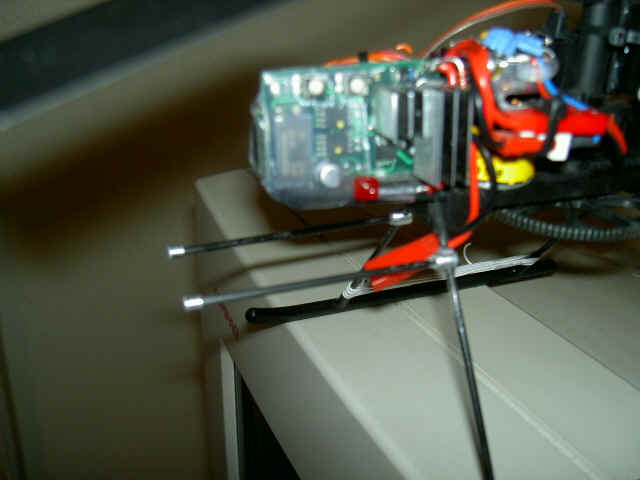

Anybody have any solid information on raising the head speed on an aerohawk or similar?
Im running mine on lipos and the thing is so light the rotors dont really speed up that much to get it in the air which is ok in doors. Im thinking of maybe having a spare set of rotors/motor that I can swap out for flying out doors with a much higher head speed for a bit more control. Being outdoors there would be less chance of hitting the rotors on say( the door ) and damaging them.
I need to know what size pinion would be best and how much to modify the rotors.
Would it be best cut the ends, or along the full lenght?
I recently upgraded to a HBll 370 motor and I now have a spare 310 tuning motor so I dont have to keep changing pinions I can just swap them over.
Thanks.[sm=sunsmiley.gif][sm=sunsmiley.gif]

what I really want to do is go with less pitch or less rotor area which will suit a higher head speed , which will give me a better chance outdoors.

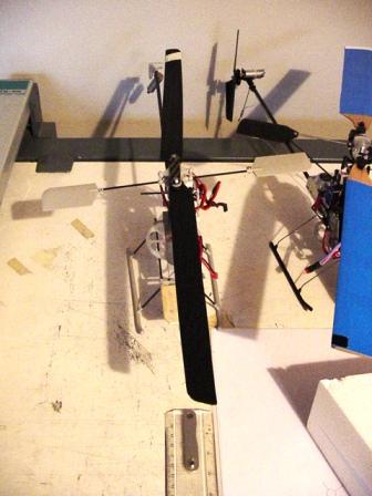

If the aerohawk is anything like my dragonfly it hovers great but forward flight is a joke. Higher head speed is the answer.
I cut at least a third of my blades away, basicly running the trailing edge parallel to the leading edge from the tip to the root, removing all of the taper. I also stiffened the dragonflys head but I think the aerohawks head is ok stock. I also upgraded to a GWS EDF50 motor (note the motor only not the whole fan unit) to give the tail same much needed assistance and finally the stock battery was replaced with a 3s1p Etec 1200 pack. This gave me a hover head rpm of 1700, which is similar to a hornet FP.
The whole mod took about 2 hours to do and it now flies a hell of a lot better. It will now respond to cyclic in forward flight and the pitchup is reduced. Down side is the main motor will not last anywhere as long as stock - but they are cheap.
Once again this mod was on my Dragonfly but the principles are the same, if you want to get these little FP helis flying as well as just hover, the head speed has to go up.

Good to hear cut your blades to increase the head speed, you have just scratched the surface though. I see in your linked thread you estimate a head speed of 2000. I'm afraid its unlikely to be more 1500rpm with your current setup. I am just cracking 1700rpm (tacho-ed) with severely cut blades (see pic). it is now one of the most responsive FP micro helis I've flown, not perfect but a long way from stock.

I may try a higher gear ratio say 11 or 12 tooth pinion, and cut some more off the blades. The motor seems to be in its sweet spot at the moment.
You must be right about the head speed, your blades are quite a bit smaller than mine. Did you cut any off the lenght, is there any danger of too thin a blade flapping or flattening out at a high speed?

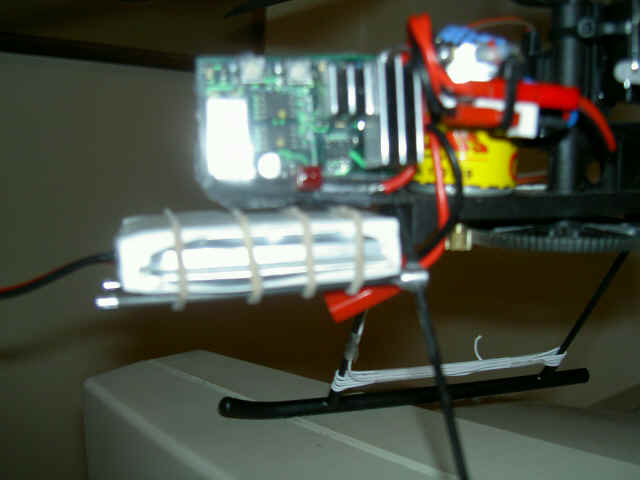

The battery im using is a 600mah. I have a home made li/ion thats about 105g and it really is stable with that, but obviously I prefer the lighter weight one and im going to get the head speed up to suit that battery.
I may go brushless but at the moment this motor seems to have enough power.
This is my heavy li/ion battery next to the lipo.

How are you mounting you LiPo to the AeroHawk, I notice on your Pic you appear to have a shelf underneath the Picoboard & Rx.
I'm waiting for my 2s 1200mAh Lipo packs to arrive, and hadn't thought about how I was going to mount them.

cut my blades down some more today, flies even steadier now.
Took it outside in a slight breeze but had no problems with pitching up or being taken by the wind.
