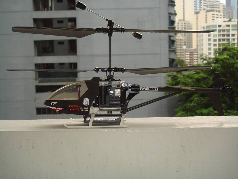

I want to buy an electro helicopter and that's why I've been reading posts these days. I've read bdavison's review on Hirobo XRB Lama and that's why I searched on ebay to see the price of it. I found it with 300 Euros.
I also found it's half brother Hirobo XRB Shuttle with 250 Euros. I looked for reviews on it on the forum but haven't found any. Which is better?
I also found the Syma Dragonfly with 30 Euros. What's with this huge price difference?
An advantage of Dragonfly is that you can use it outdoors comparing to the indoor Hirobo XRBs.

How about Syma Dragonfly, which is 10 times cheaper? Is it 10 times worse than Hirobo XRB? What do you think are the problems with Syma Dragonfly?
I want to equip the helicopter with a controller and a lens. Can Hirobo XRB sustain more weight? How heavy are the removable shell and tail? Can it fly without them?
Thank you
Thank you

I have not been impressed with the cheap knockoffs. You have to understand that Hirobo makes some of the finest quality heli's out there. Their stuff is ROCK solid, well designed and built to last. Unfortunatly many of the knockoff's are not, and are not worth even considering. Ive never flown the Syma one, but I have flown the Esky one.
Do yourself a favor and get the Hirobo. I know its expensive, but you honestly pay for what you get. The XRB is better than the BladeCX in my opinion. Follow the well written instructions to fine tune the heli, and it will last forever. I dont even know how many flights mine has now...Im guessing well into 1000 flights. The only repairs so far, is replaced the lipo, quite a few sets of blades, and a flybar pitch link (it popped off in a crash and I couldnt find it).
The heli will fly without the canopy, but not without the tail. The CG is too far off, and it acts funny without the tail, not to mention the fact that you cant tell which way is which if the heli yaws.
You might be able to equip the heli with a wireless camera, but it would have to be a very VERY small camera, Im thinking payload maybe 40g total weight would be reasonable, and dont expect much performance from the heli if you load it down. If you get the carbonfiber blades, you might be able to get a little more payload on it.

Dancu:
You can get the carbon fiber blades for the XRB at Canadian$ 45 from Star Flight (www.jutstar.com). They are efficient and ship the items out quickly as soon as they confirm payment thru PAYPAL or by credit card.
I hope you are enjoying your Hirobo as much as I do mine. In fact, I bought another XRB, the Lama (I have the Shuttle with a painted shark face canopy and United States Marine Corp insignias.
Joey [8D]
