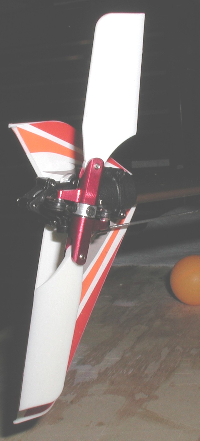

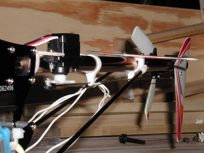

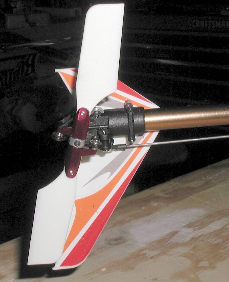

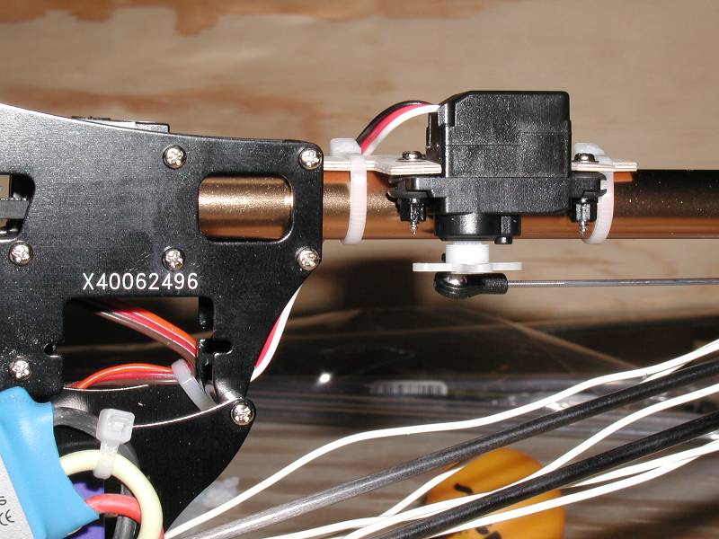

Has anyone had issues with the rudder servo linkage not being long enough? I bought the recommended servos and the tail responds very slowly and not too smooth throughout the range. I thing a longer linkage would help but I'm curious if anyone else has had the issue. Thanks,
Dan
Dan
Join Date: Aug 2005
Location: Howell,
MI
Posts: 96
RE: HeliMax MX400 Problems
Dan,
See Trex build thread at http://www.trextuning.com/.
Look at build step 21. The links on the MX400 tail may be backwards. I have read that the grips should be in front of the leading edge of the tail blade. I happened to stumble on this last week and this change made quite a difference to the rudder control. Be sure to reverse the Gyro and servo if you make this change.
Joe

Dan,
After making this change I was able to shorten up the rudder linkage but there seems to be many opinions as to which way the blade grip should be. The trex build thread said it should be leading the tail rotor but on the x400 build thread it shows the grips trailing. Does anyone else have an opinion as to which way they should be? I have them leading and I did have to change the gyro and servo direction and also shorten up the servo linkage but my tail control seems to be better and more even in both directions. Lets see if anyone else has an idea. I am new to RC helicopters and I would hate to tell you wrong but this does appear to be an important issue that needs to be cleared up.
Joe
Joe
Dan,
I had the same problem with the push rod. I made a servo mount for the boom out of thin plywood, some double sided foam tape, and a couple of plastic ties. I also made a new push rod and used a ball link on the servo. Its nice and tight and I now have a nice straight run for the push rod.

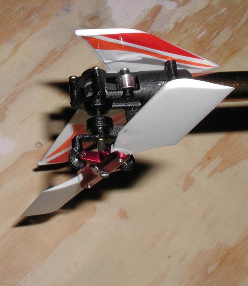

Could someone post a picture of the change they made to the tail rotor to give more play with the stock setup. I don't understand the trailing/leading aspect that you guys are talking about.

Shadrack, these are for you. Leading simply means that the ball link that controls the pitch of the blade is in front of the blade, Trailing would mean the ball link would be towards the trailing edge of the blade. My setup is leading the blades.
