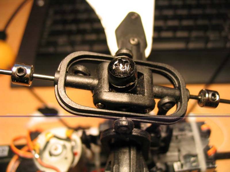

Made some progress today with my BCP - lots of hovering, and some back and forth forward flight. After a while, control was getting harder and harder, until it just dropped to the ground. After, I could not get it back off the ground. I brought it home and started trying to figure out what went wrong. I noticed the flybar was freely rotating about its longitudinal axis. I'm pretty sure its not supposed to do that... Should these collets be attached to the control frame?

Yup it's broke. Time to get it replaced.

Yup it has plastic tips on each side and the flybar goes thru it and the collets screw on to that and puts presure on the fly bar

Is it common for this to break? Today I had no crashes, just a couple hard touch downs. Could it have been weakend in previous crashes, then just simply gave out today? I think its also kind of odd that both sides broke at the same time. I'll probably buy two just in case.

Mine broke in the same spot due to hitting the ceiling though![&o]
I couldn't get mine to hover very well and found that part broke..I have 2 coming in the mail.
