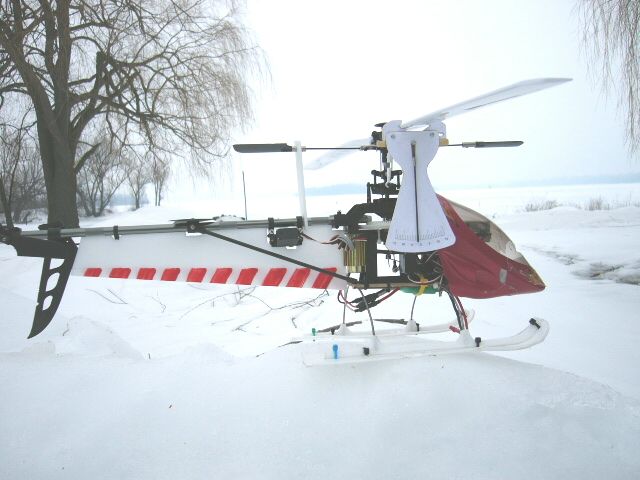

I did not do anything to protect the electronics. I know, this pic does not have falling snow, but even when snow is falling, I have never had a problem.
Now, problems with links that tighten up in the cold, those I have had! [X(]

right on man... that looks cool, I'm hoping for some fluffy snow that I can blow around with the rotor wash...

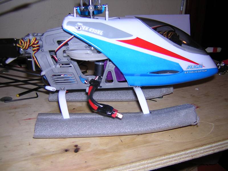

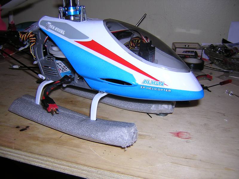

here's what I ended up with, I went to a couple of places and noodles don't seem to be in right now... I did find a toy sword made out of foam, thanks to the great manufacturing the glue holding the inner shaft snapped and I then had a hollow piece of foam, I cut a slit for the gear struts to go up in and figure I can zip tie it to hold it in place.. shaped a bit with the dremel which sucked.. I think this should work

The foam method works well for anyone interested. I use foam tube over the skids on my EP550 and it makes landing in snow a bit easier, though it'll still sink in the light fluffy variety.
Pool noodles are too thick for smaller helis anyways. If you want good stuff, visit a local home depot or hardware store and just pick up some of the thin foam tube insulation used to go around the copper hot water pipes in your home. Works' great and it's super cheap .
