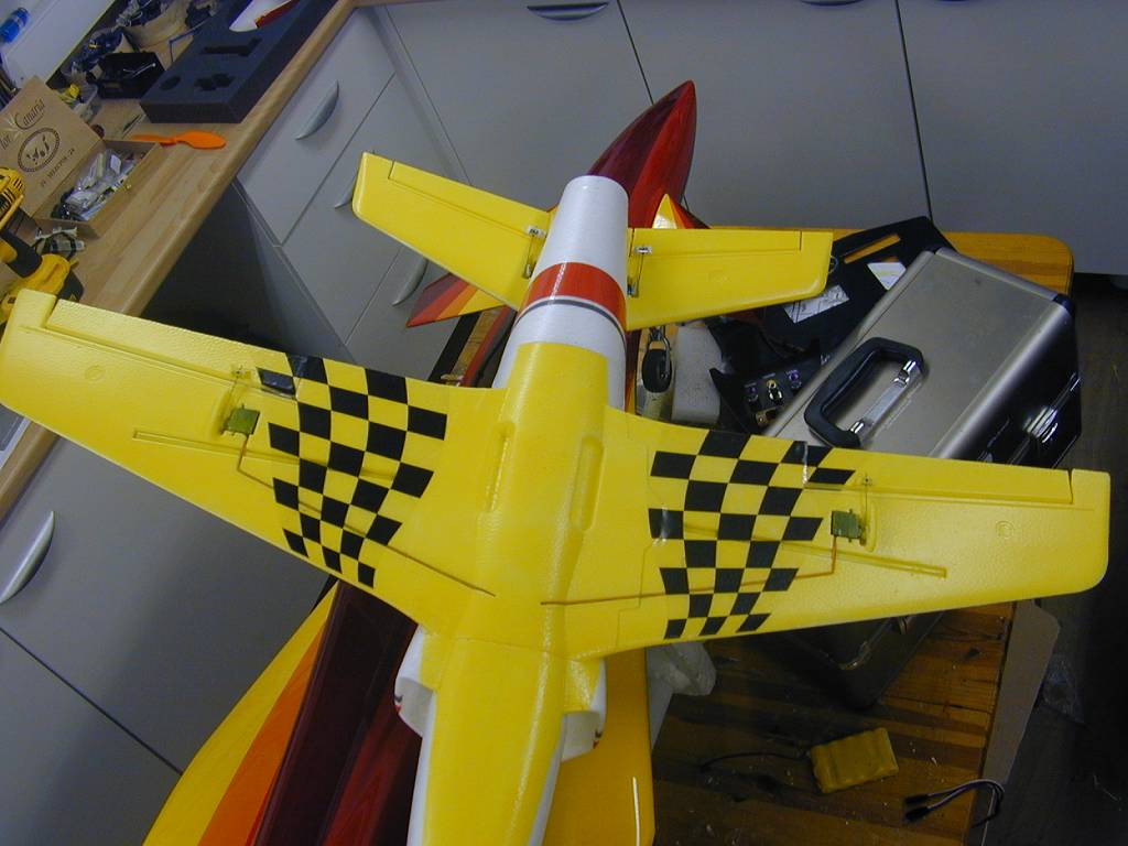

Anyone else got one of these? I must say I am impressed with it, bit expensive at £139.00 for a bare airframe, but as I had all the spare gear out of my ex Habu it seemed a shame to waste the gear, the die cutting was the best I have seen for the formers, but a bit of modding needed to fit the fan.

Having now flown it a lot, it requires no mixing for knife edge or for anything else for that matter, it tucks ever so slightly to the canopy in knife edge, but I think that is a C of G issue, the 3000Mah batteries I am using are a bit long for the installed battery tray, I will need to cut this out and reposition the velcro to move it back a bit and see if that gets rid of the small amount of tucking.

Most of the guys at my field say the Viper is faster than the Habu, I am not sure I think its the Viper is smaller and I keep it closer in so it may seem faster, but one thing is certain its a lot better flying than the Habu by a long way.

The Habu needs opposite aileron to rudder to keep it in knife edge, its much heavier than the Viper and bigger, so slower and not as nimble, its also difficult to see on a not too perfect day being all grey it blends in with the normal UK winter sky, that's why the Viper has the yellow underside, it comes in all white.

The ViperJet has a nice fairly thin wing section, so no massive drag to contend with, flew it again eight times yesterday and its still one of my favorites, good turn of speed and just wonderful knife edge's from one end of the field to the other.

To get the fan to fit you need to open up the recess a little so that it fits flat without a step to the inlet, other than the extra servo for the second side of the elevator everything else fits OK from the Habu, but have you seen the "Centry UK" Vortex, have a look on their web site, DW is flying it and seems quite pleased with it.
I hand launch like a discus launch glider from the wing tip at full power without the turn, just hold the wing by the tip and rotate it up and level, its very easy.
