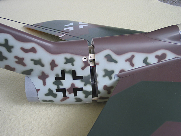

Do you mean the FW TA183 Huckebien?
If so, no, the wings or tail won't come off after they are installed. (They're glued on.)
A simple modification to the fuselage can be done to make the fan accesible.
Here it is (from the Alfa website) Note the drilled and tapped lugs and screw holes. I would recommend nylon screws as they won't vibrate loose.
