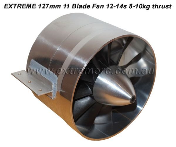

His fan is an old series Ramtec with the 9 blade rotor, and the big amp hog Scorpion motor that pulled over 200 amps on 12 cells to get to 10kg. It also weighed around 1.4kg. Things have changed a lot since then, Tony and I have been working on the fan a lot and 3 years ago I convinced him to change the blade root size and add blades to the rotor to bring it more up to date with what people want from EDF, performance AND sound.
The Ramtec has been 11 blade for a few years now, I asked HET to make a 50mm inrunner along the lines of the neu 50mm motors, what we ended up with was a 127mm 11 blade ramtec that runs on 12-14 cells with the HET 800-73-590 motor, pushes 8kg thrust on 12 cells at 121A & 10kg thrust on 14 cells at 150A. This fan weighs in just on 1kg, the centre body is a modern finned design in CNC alloy as are the stators, everything has been lightened yet the strength still remains. Excellent cooling for the motor too.
I have been testing a new 800-83-510Kv motor built for 16-18 cells, we are seeing 12.5kg/27.5lb thrust at 165A on 18 cells.
RAMTEC 12-14S FAN COMBO
RAMTEC 16-18S FAN COMBO
The RAMTEC rotor is very different to the Dynamax, the Ramtec is higher loaded, was designed to run the OS91 engine without blowing it up, in the air it was superior to the dynamax. In electric form its proving itself to be very adaptable, just look at the video on the 12-14s page of the JTM Super Viper running 14 cells, its a big heavy model and gets over 170mph.

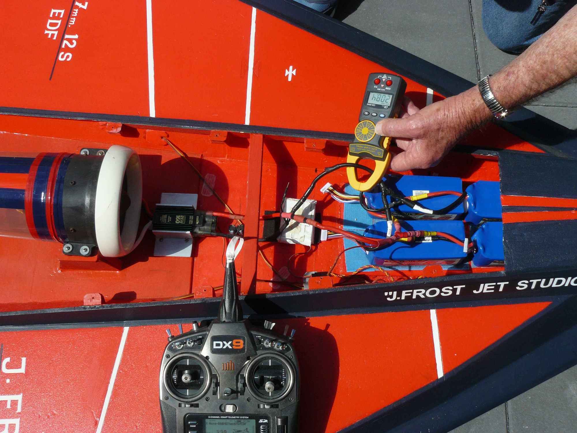

Cheers.
Not a great deal to carry 8 kilo of lipos in this power hog.
Just another hog.
This hog does 250km/h at ease.
The first of my amp hogs still going like new after close to 10 years! Yep. it's 9 blader.
More than happy with my amp hogs in all of my 5 giant EDFs. Years of endurance, performance and reliability is my priority. Countless hundreds of actual flights is more important to me than some bench static tests with false stated performance figures. My 180-250A/ESCs handle the 200+ currents at ease, and 3 to 8kilo load of lipos is not a big deal for my design EDF jets to carry.
Back to the OPs 6" fan, I would definitely expect lot more thrust than any of my 5" units.

The amp hog fan is a Ramtec, its the early 9 blade, and has the big scorpion outrunner in it with an extended shaft. It pulled a lot of watts to get the power, over 8500w from memory, and weighed in over 1.4kg.
Our current 11 blade version with the HET motor comes in around 1100 grams and pulls 7500w for 10kg thrust. Mr amp hog can chest beat all he likes about facts and figures, but everyone knows Ramtec Tony posts up on the other forum in my threads and is a friend of mine. I got the HET 50mm motor series into production, I was the one who asked HET to make an equivalent to the 1927 series motors. I knew we needed a 50mm inrunner for the Ramtec, one with low enough Kv to handle the big pitch and power and Tony knew the amp draw of the scorpion was the big issue with sales, and competing with other fans on the market. 200A is crazy, 150A is far more manageable.
Here are some pics of the housing I designed and had made, there are around 200 of these out in the world in use, cannot imagine there would be if the figures were not true!!
