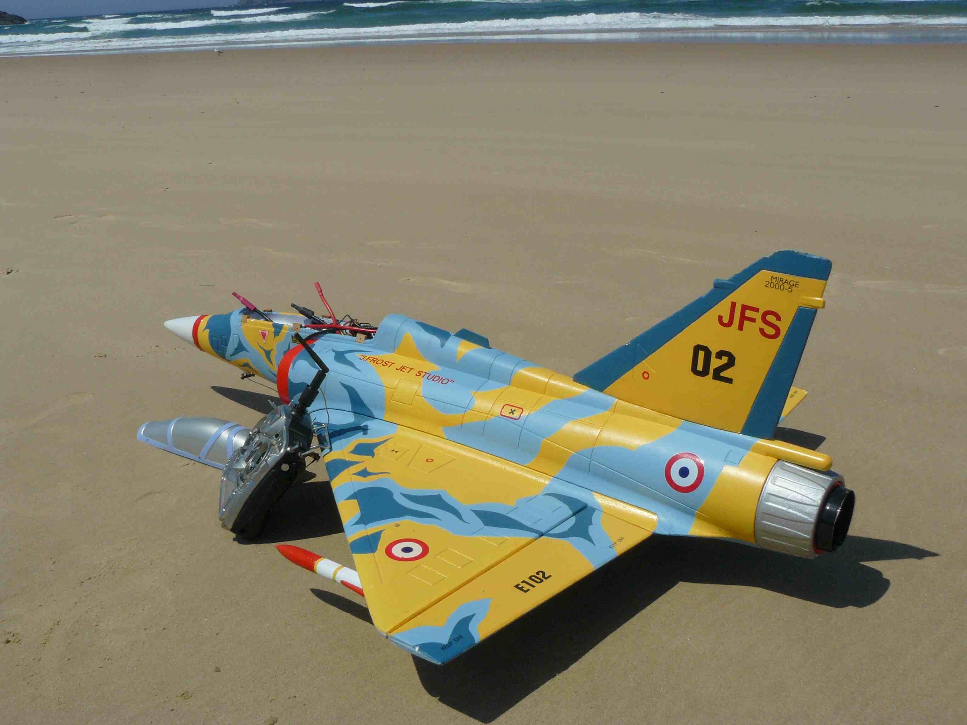

My highly modified foamy Mirage by FlyFly at its favoured flying field. Hotted up to 9S next to 7S powered Habu. Another flying day in paradise.

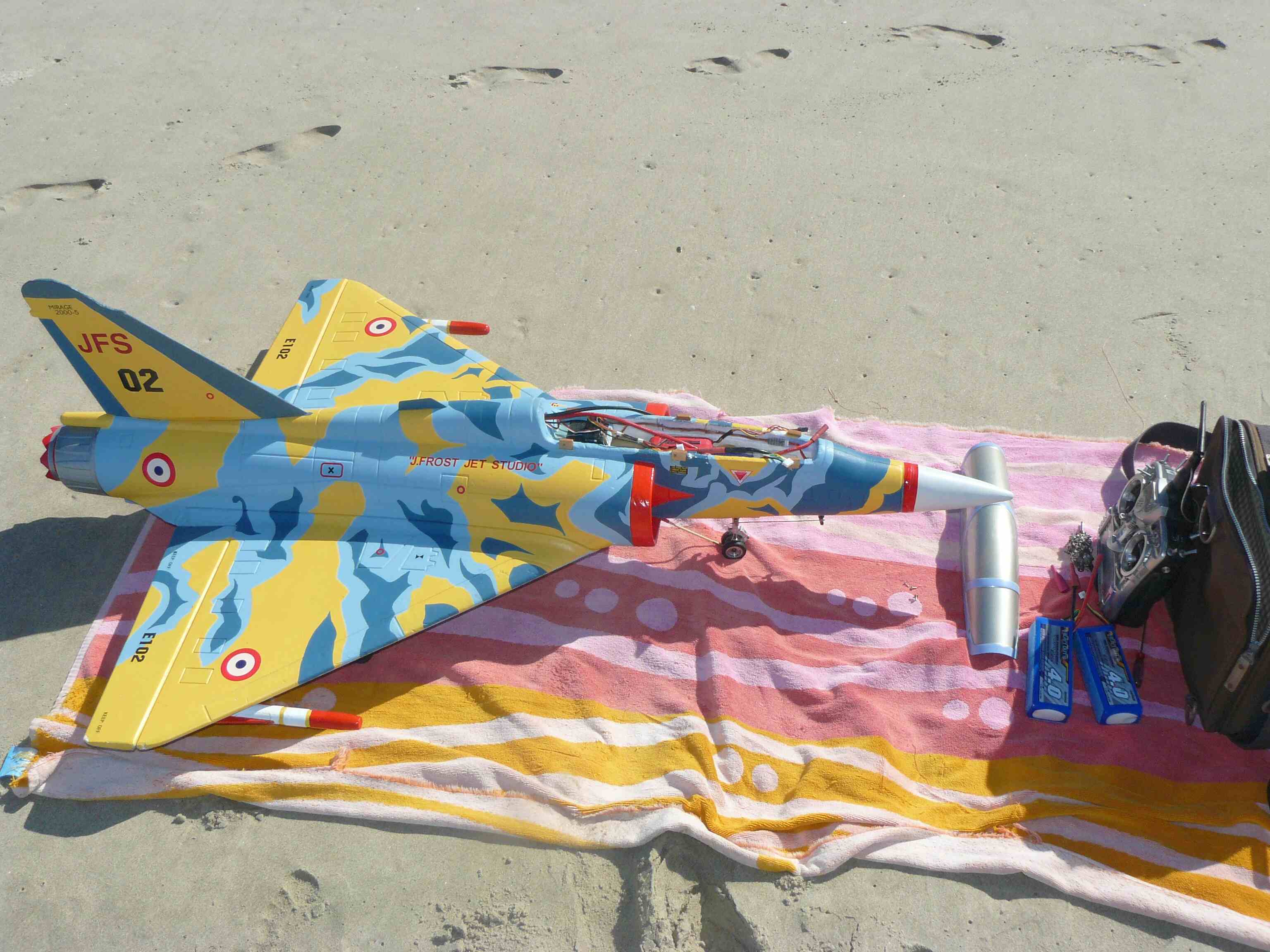

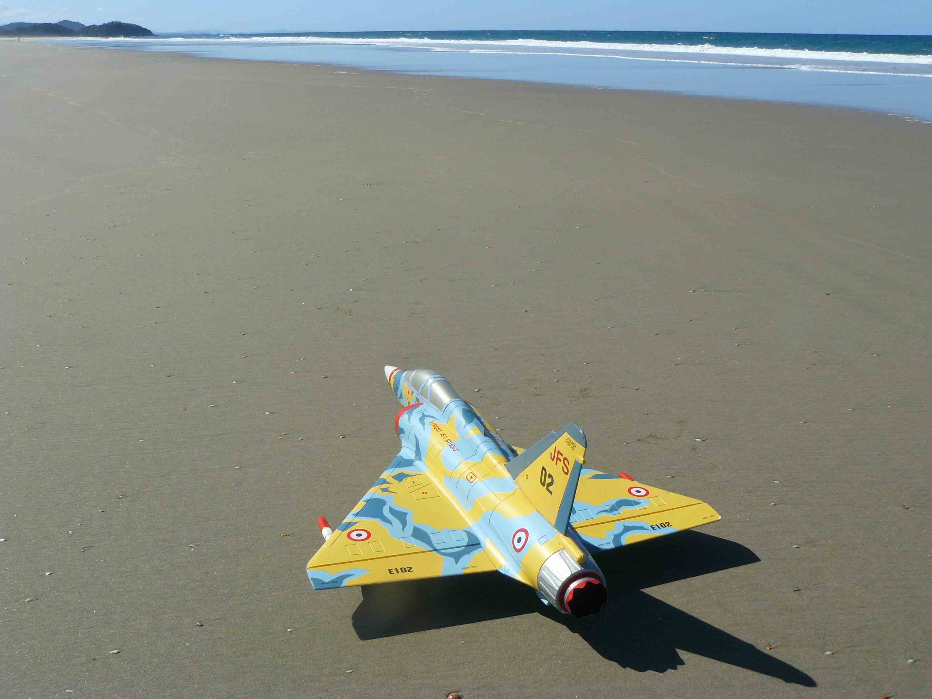

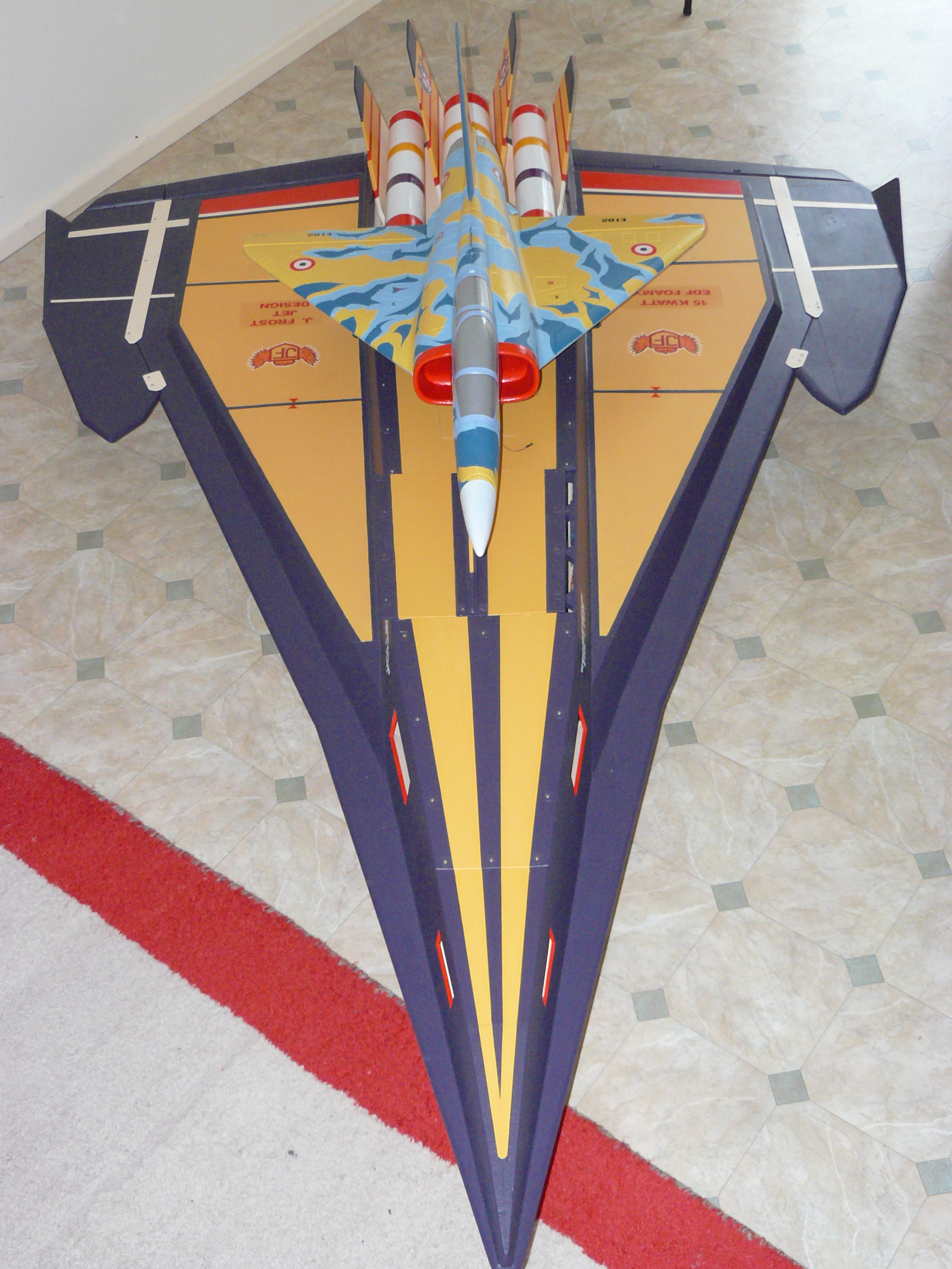

Few more pix of this unique build.

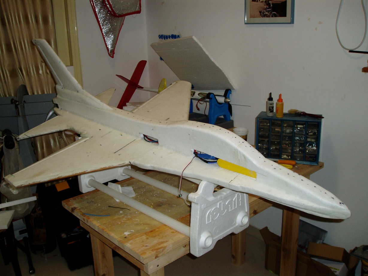

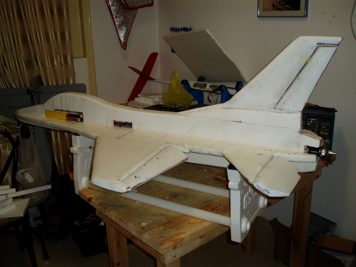

some pictures

I think that the flying fuselage area will add to the total wing area by about 20%? I'm definitely adding wing extensions that I can saw off later on after some flying practice. It's first foamy so it's not very scale, Hahaaa. Esc and batt. are placed in that slot up front. Do you think they'll have enough air flowing around for cooling? Wires are hidden inside the fuse. Waiting on some servos to arrive. 4.5 kg.

I didn't realize it is a pusher, post it in different Thread, this is EDF Forum. Never the less it should fly fine if you stream line your control's Trial edges, BTW, it was a waste of time to glass it with all the extra added weight. Enjoy having fun with it. J.

Yes I think it will fly fine. Thanks for your help and I'll start a thread elsewhere.
