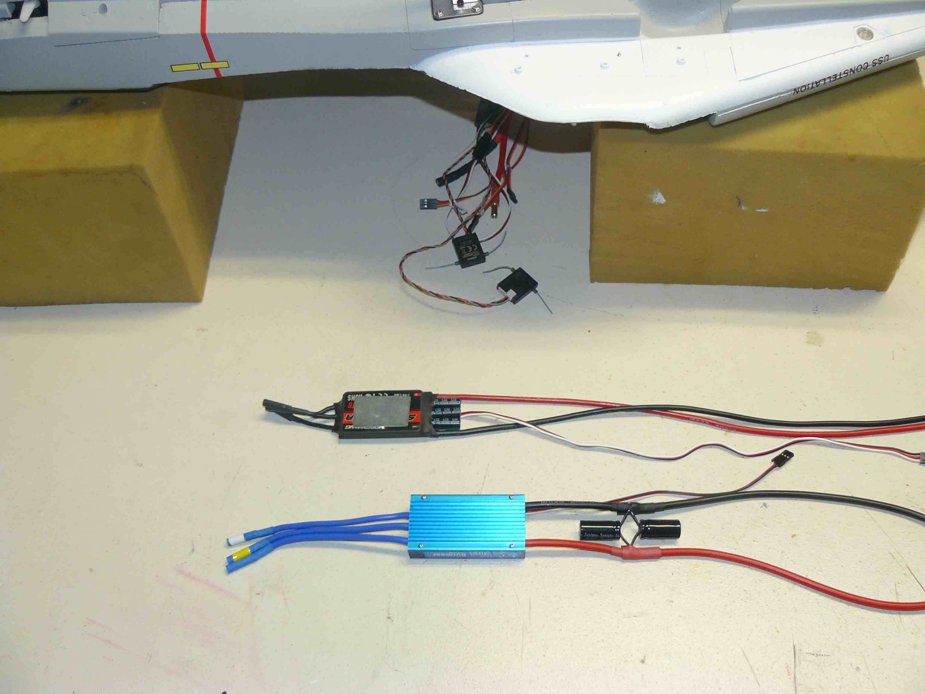

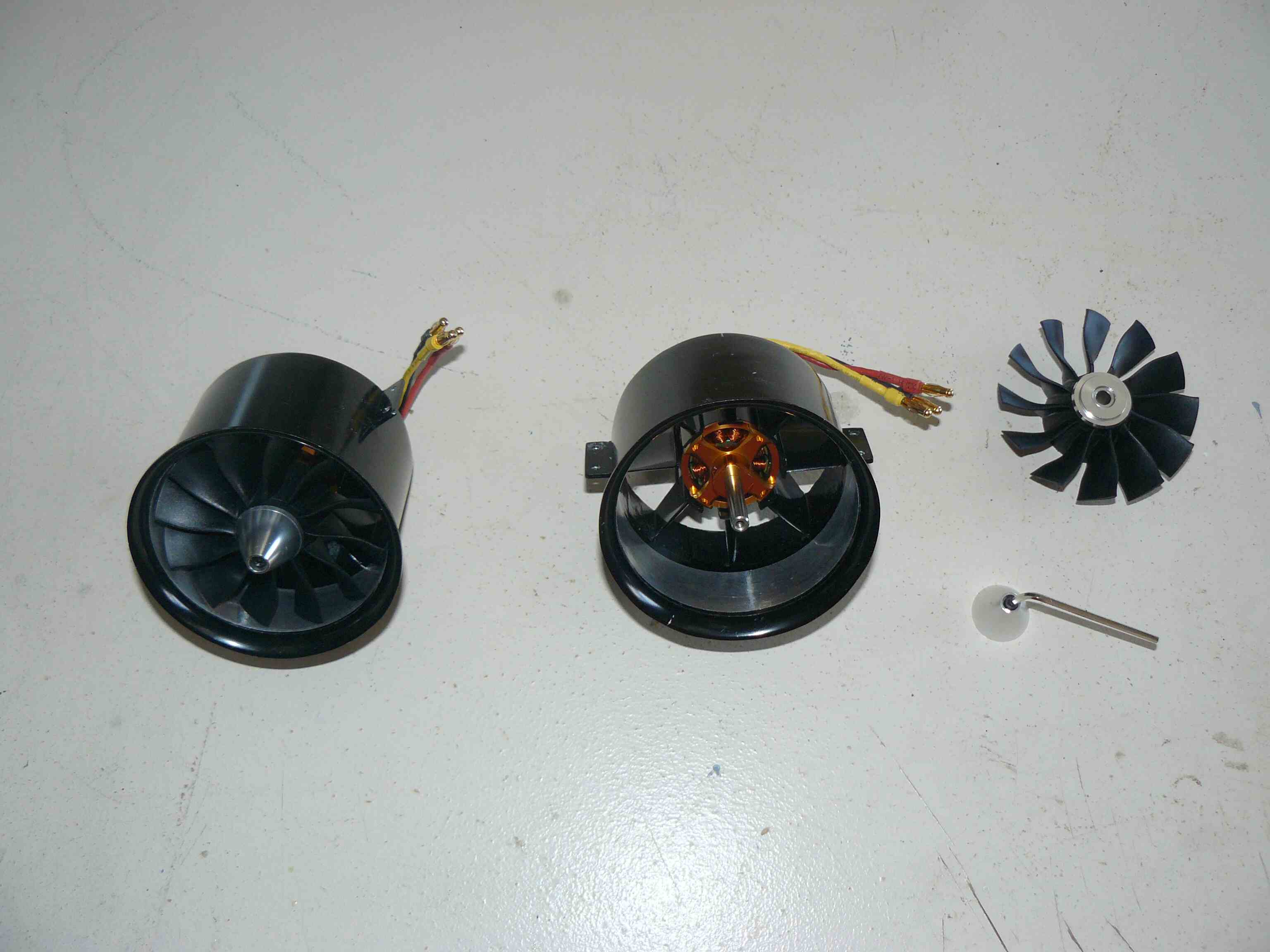

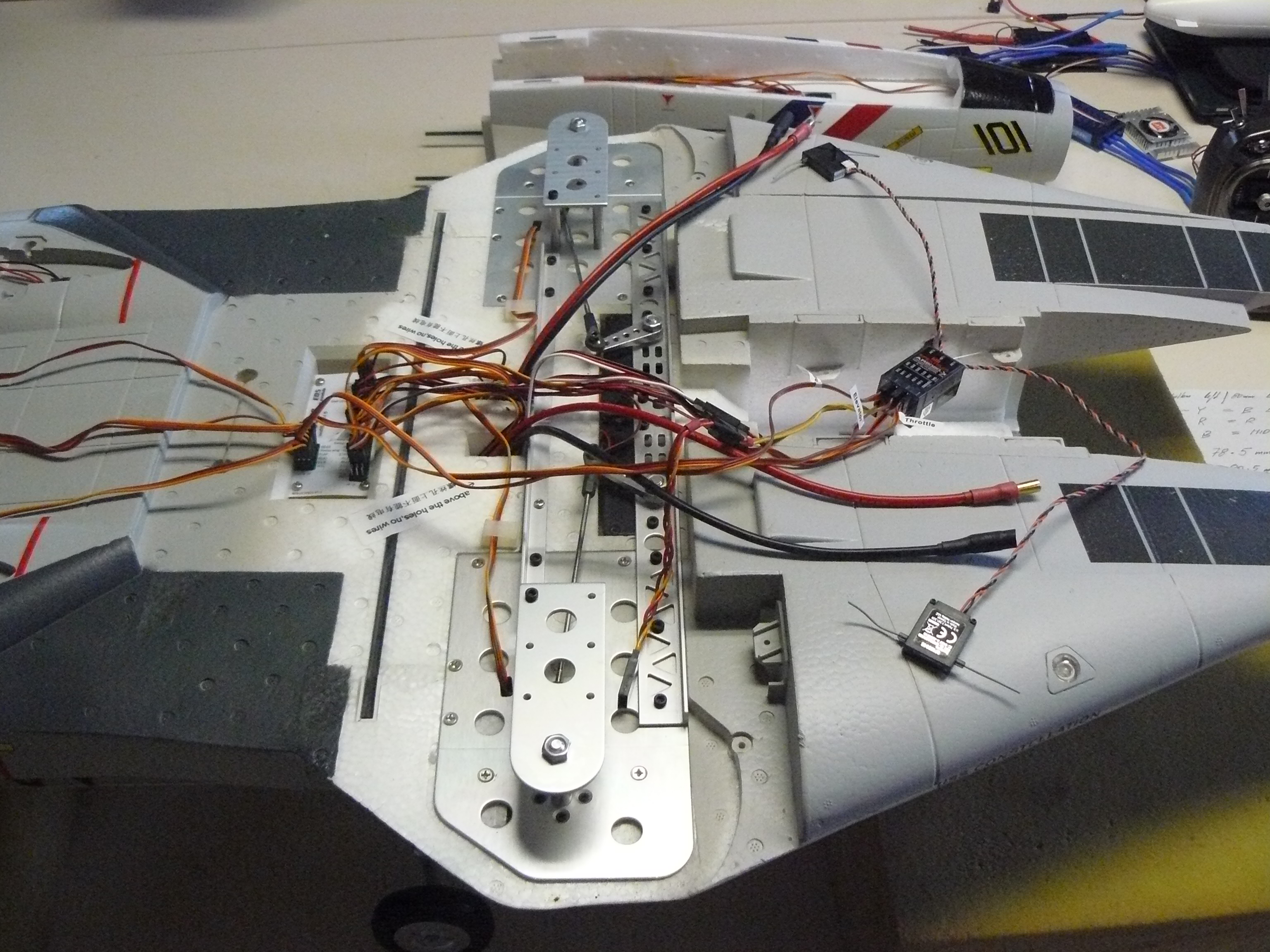

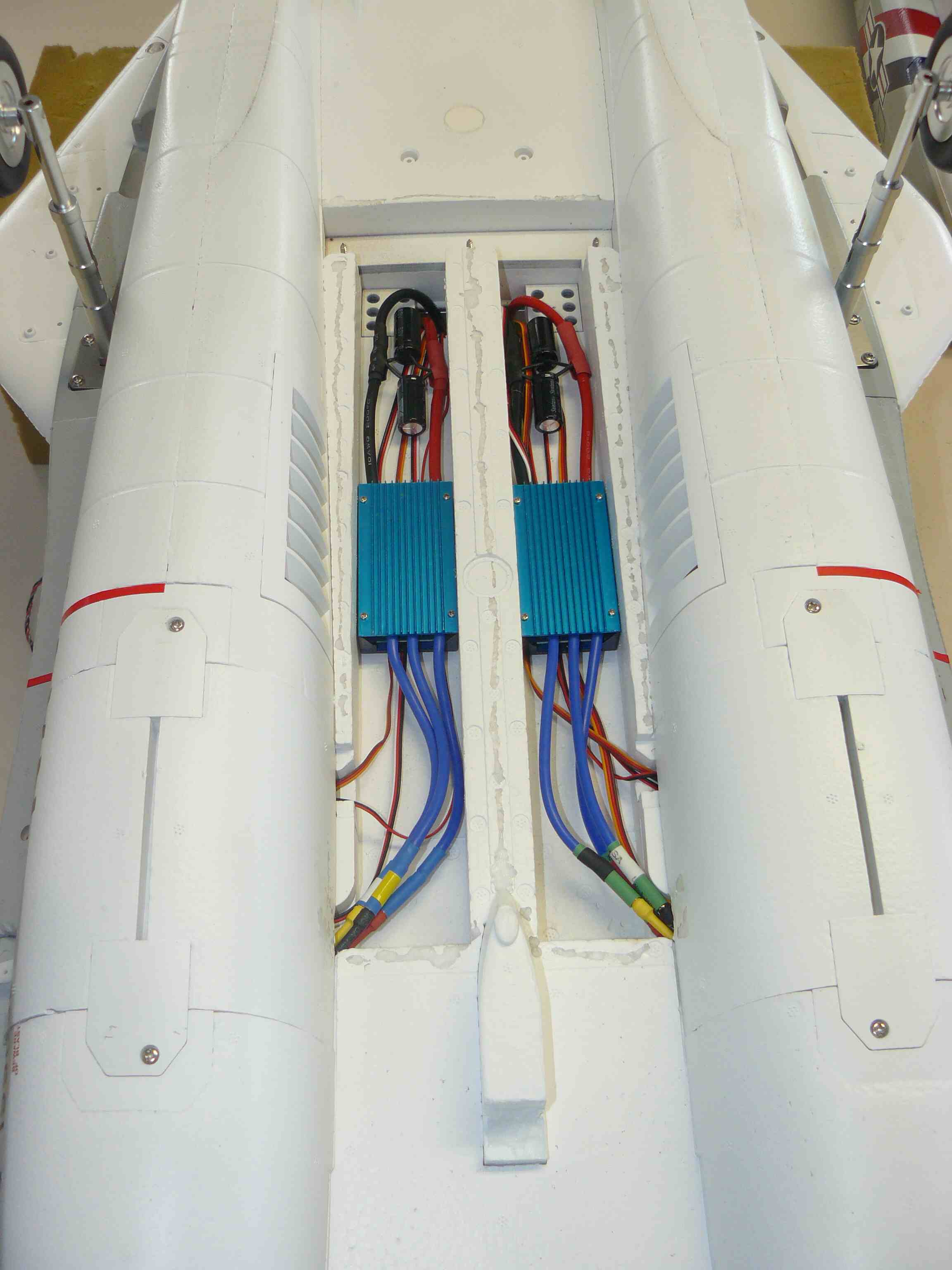

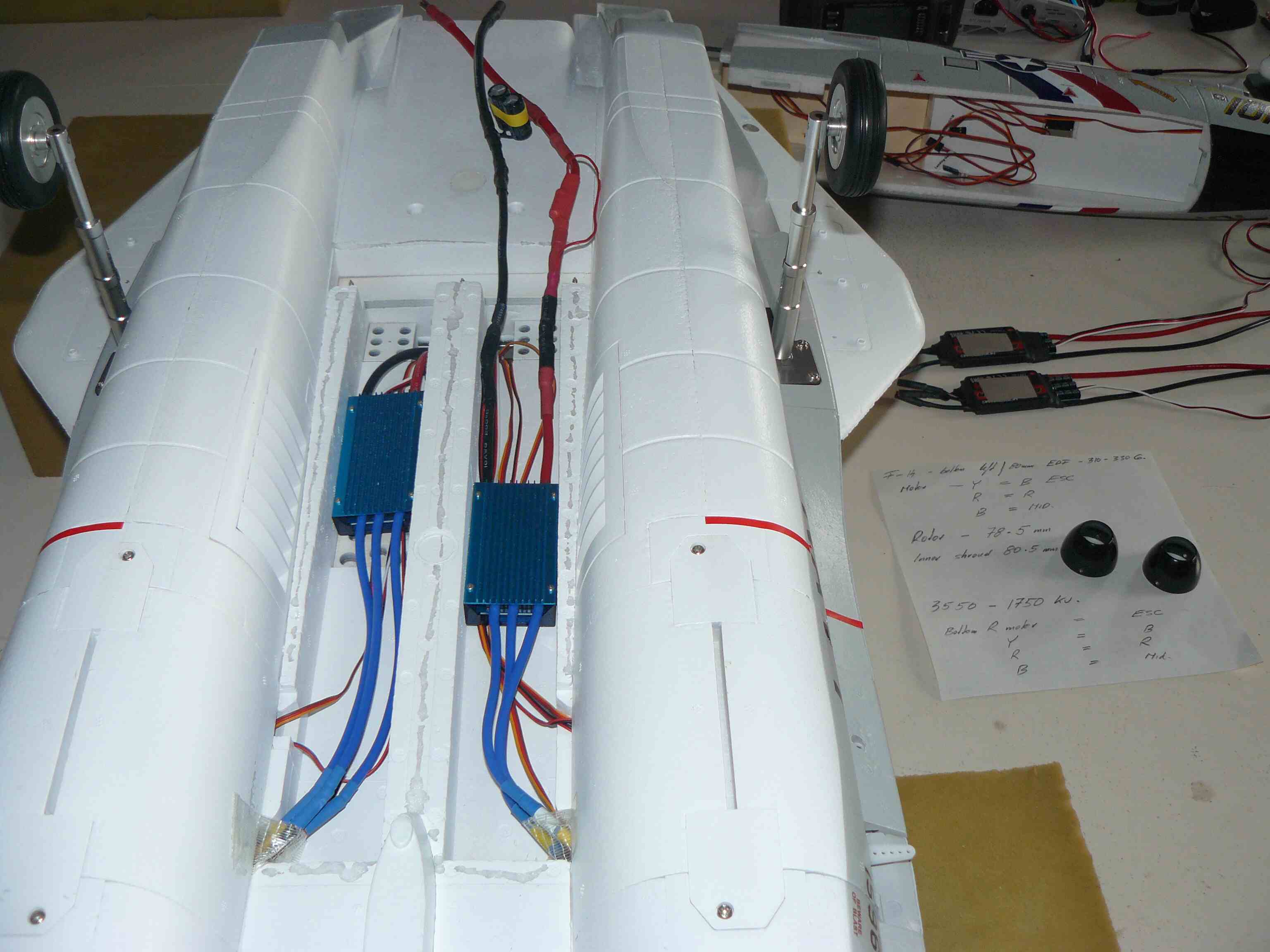

Well, my infection developed into fully blown jet fever and my latest bug is getting hands on this foamy "Tomcat" I just pulled out of the box to see what I can do to it. Few pictures of my upgrades starting with larger ESCs, better oleos springs and so on.

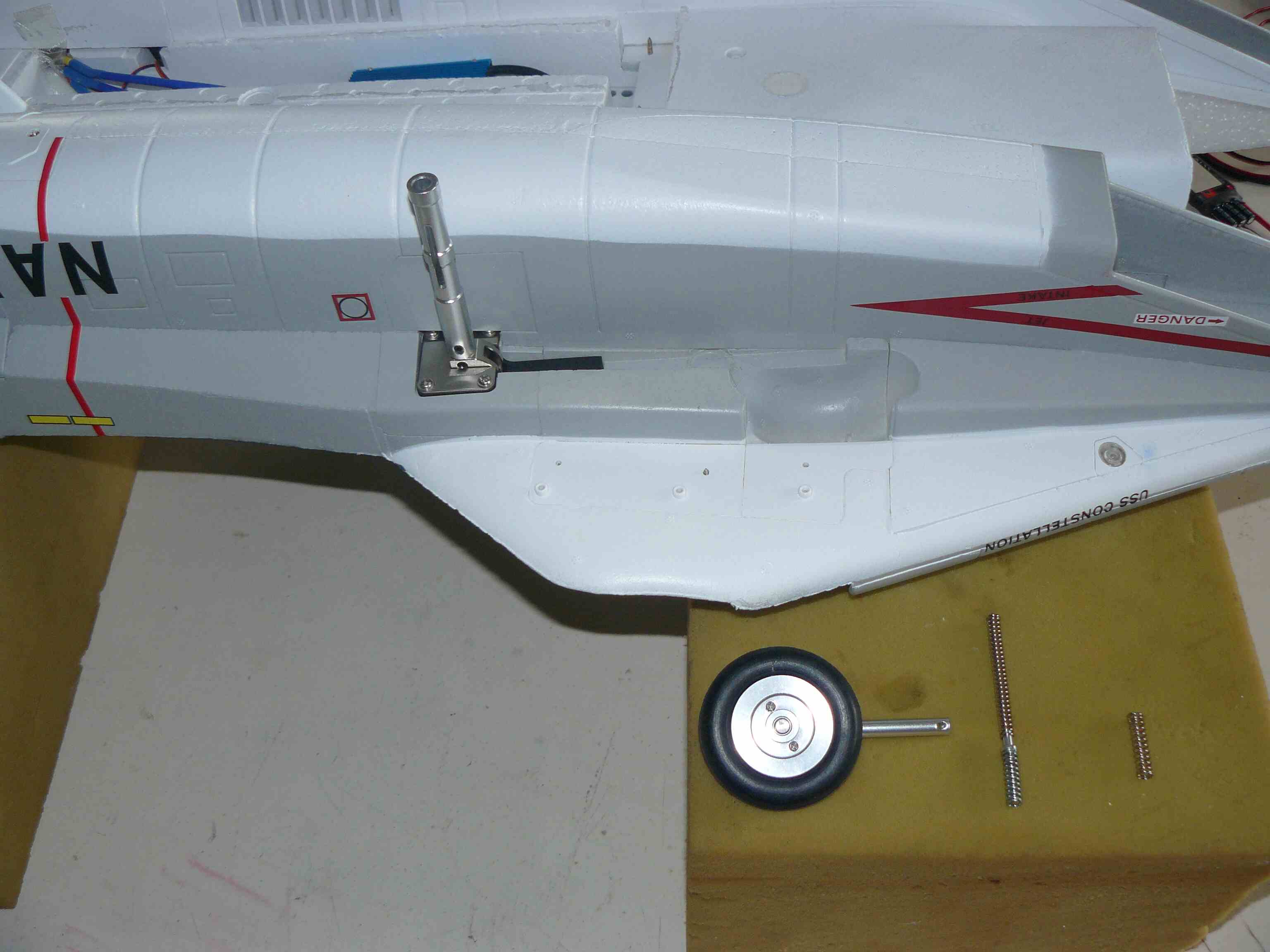

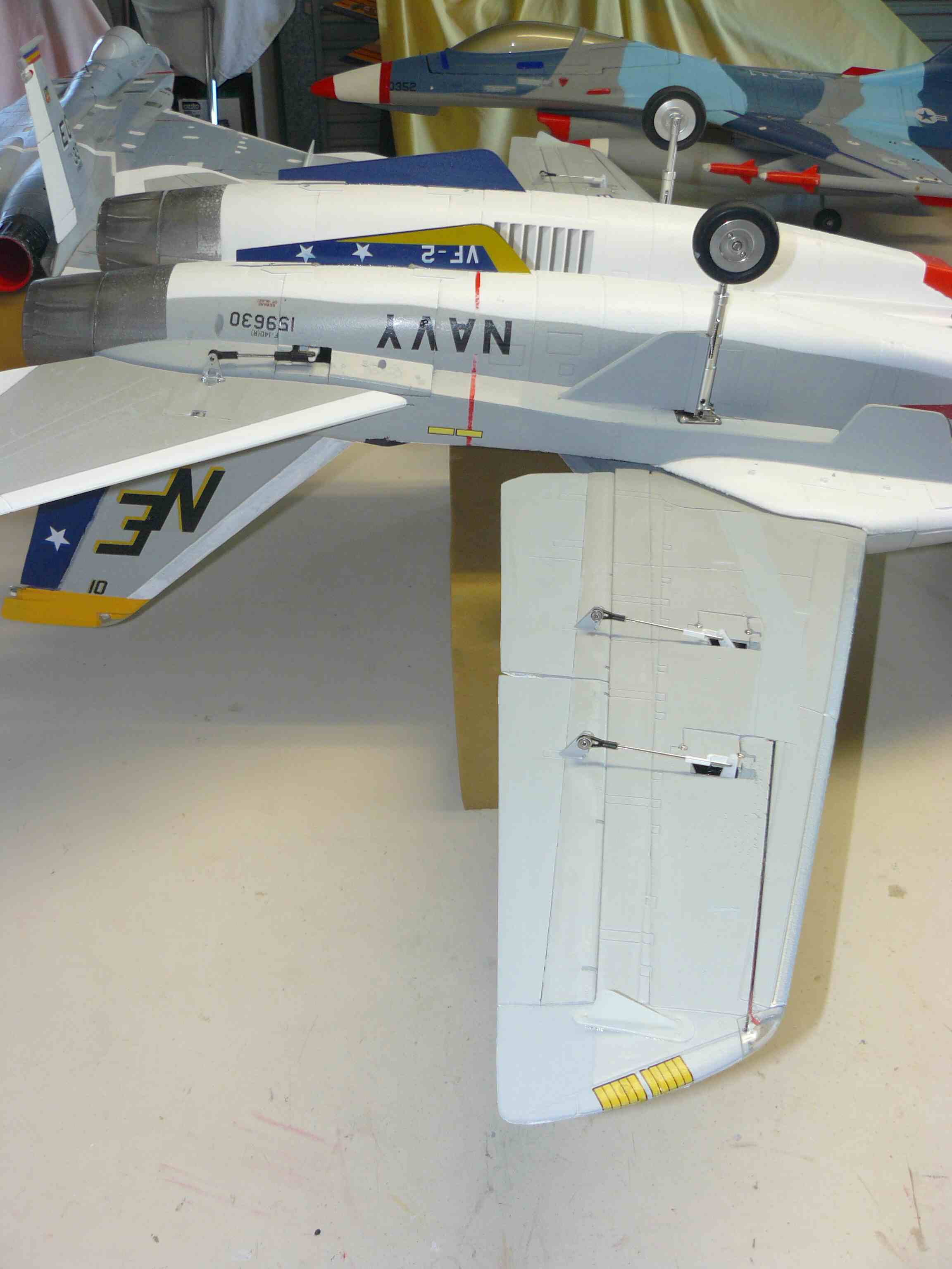

Beefing up the main landing gear, 6+ kilo foamy with oleos like this need some attention, especially off the grass.

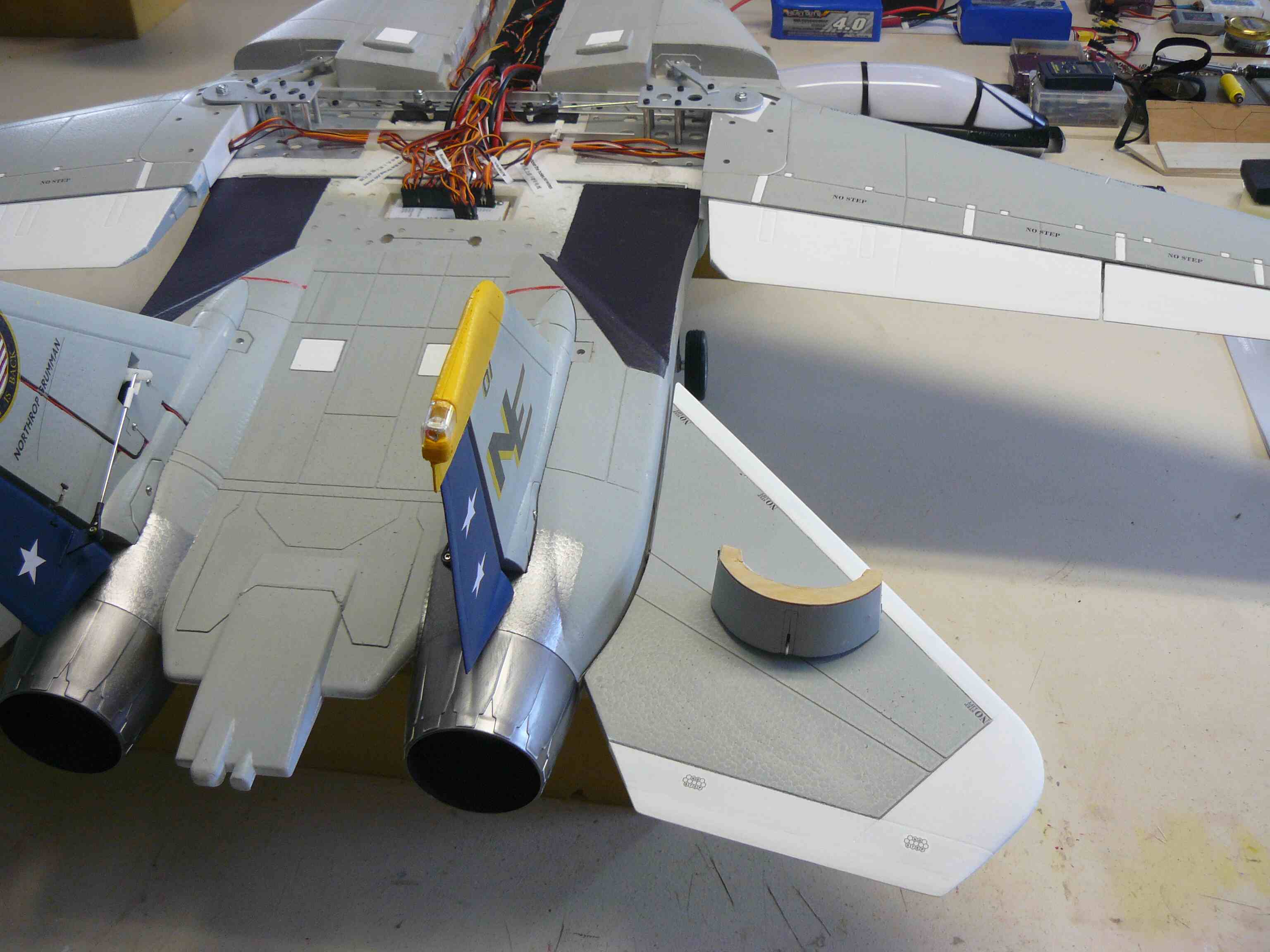

Cheers and Marry X, TEs fitted to my rudder fins, some trimming was needed for seating of swing wings all the way back and battery bay enlarged to accommodate lipos. AUW will vary between 5650 to 6350 grams with 4-6Ah sets. With the larger packs I might have CG issue so might have to compromise somewhere in between and shorter flight time unless I ad on my aft CG correction probes.

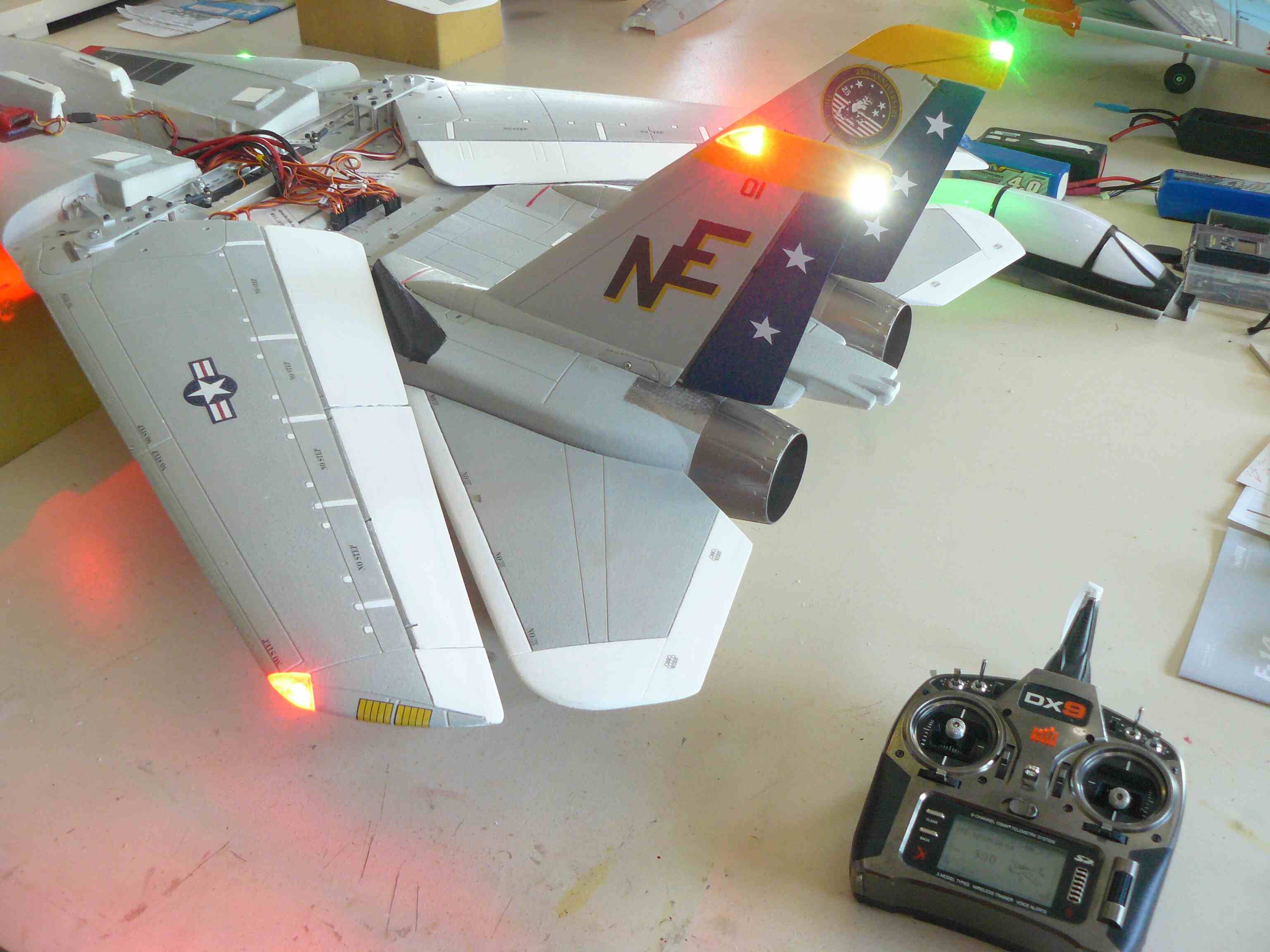

Few more improvements and final finishing touches, perfect x/mas present, just about ready for action, after 1st. of Jan.

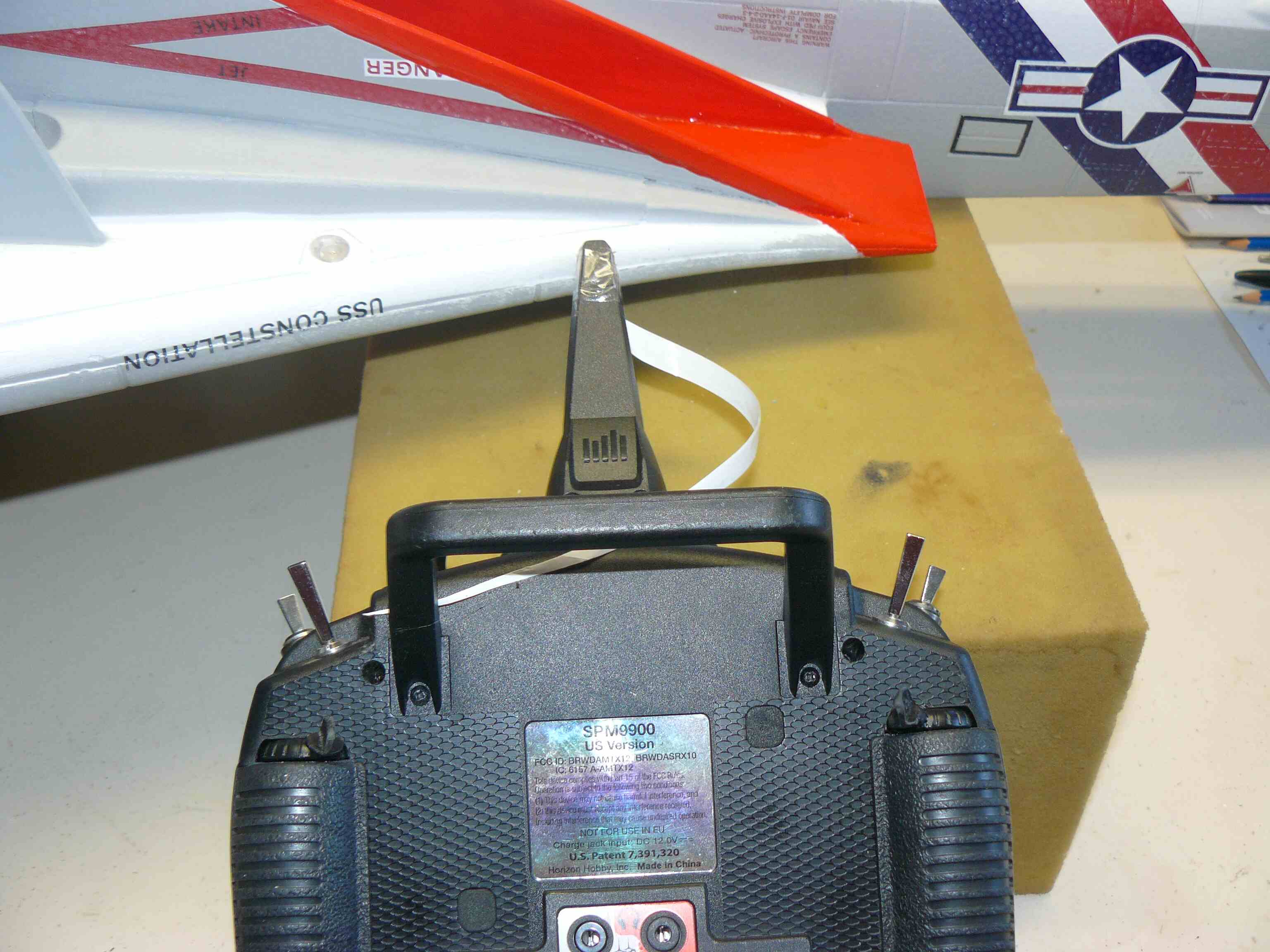

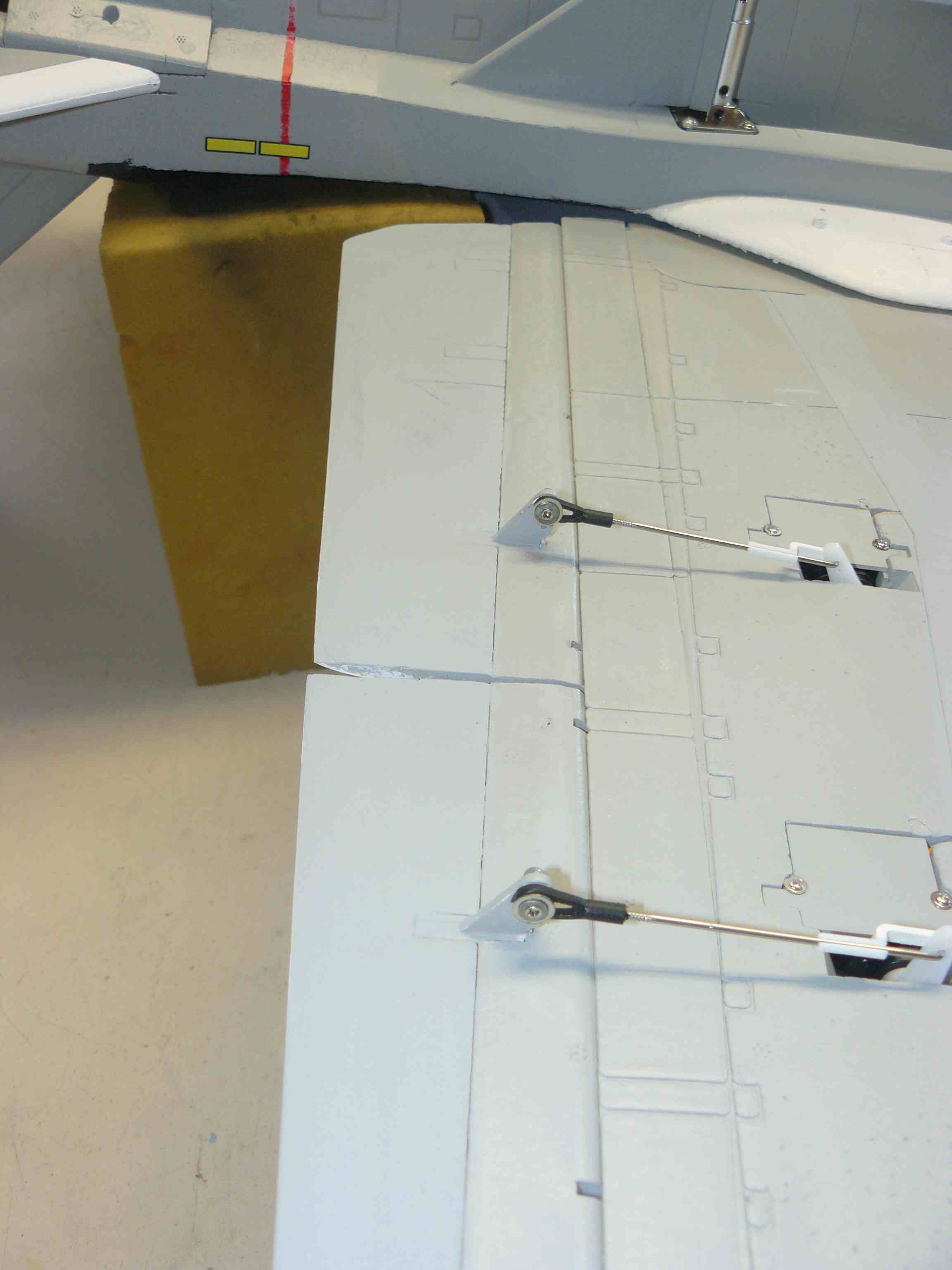

Better to be safe than sorry, security washers added to all controls to ensure the clevice won't slip off the ball under the load. Protection skids fitted to the wing tips and bit of micro surgery to my radio by fitting better control knob on the left lever I use for the sweep wing, which I will upgrade to proportional control.
