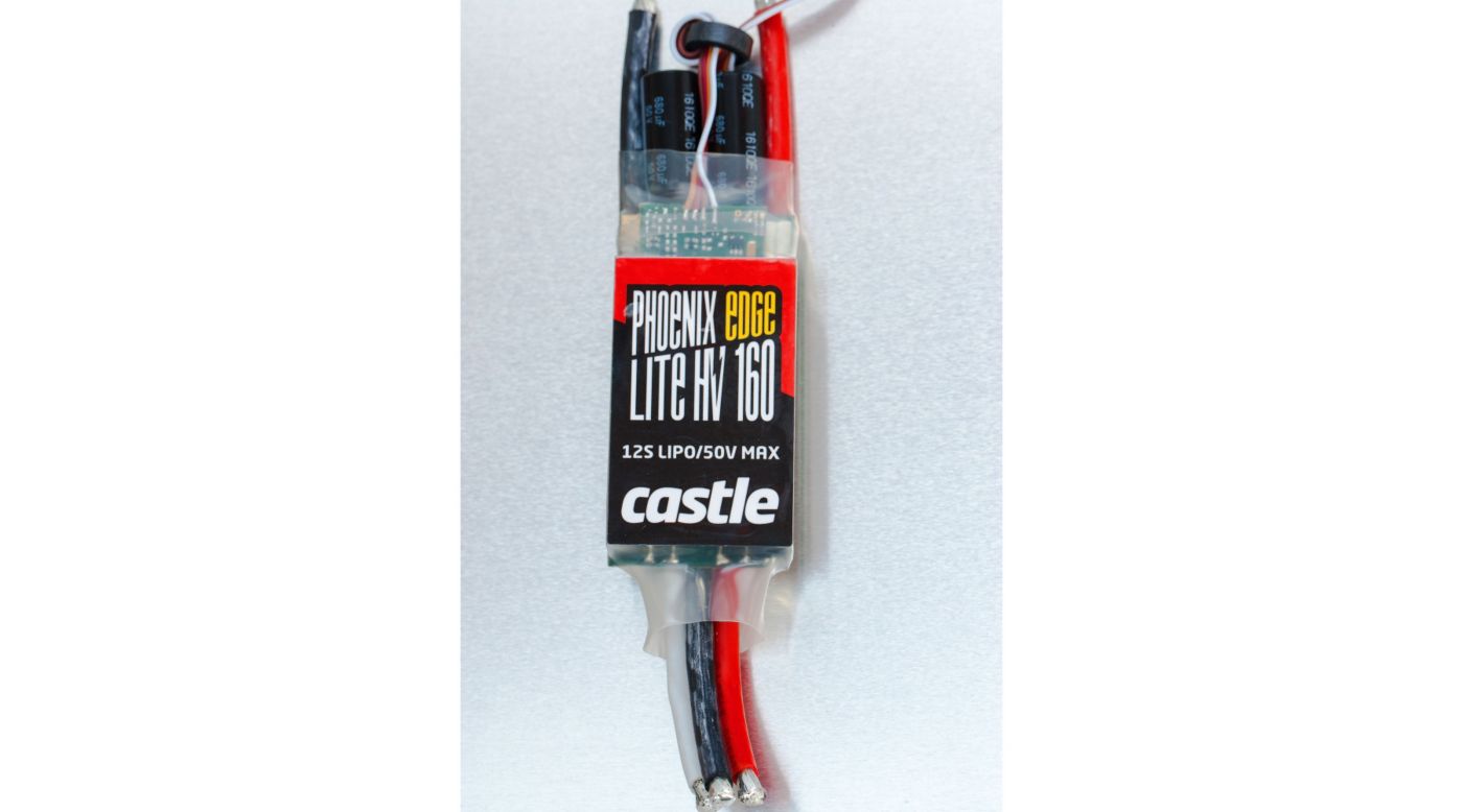

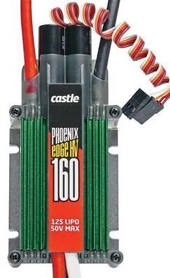

What is the difference between these two controllers ? It looks like one is without the heat sink, but the one without it is more expensive, so it must be different(?). On the BV pages it just specs Phoneix Lite 160HV for the 10S and from the illustration it looks like is the heat sink one. Can someone elaborate? Thanks.

Ahoj Vasku, jak zijes? I believe the "light version" is with BEC, the one with the heat sink is OPTO,- I use two of those, great speedos, with one of them I just logged 500 flights on 12S, pushing it to well over 200 amps, so far no melt down but fitted to it extra cooling sing head. In my other model (127mm Panther) with very high BS/850kv motor I have recorded close to 240 amps current draw at one stage. Ahojky, J.
