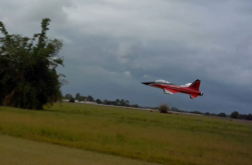

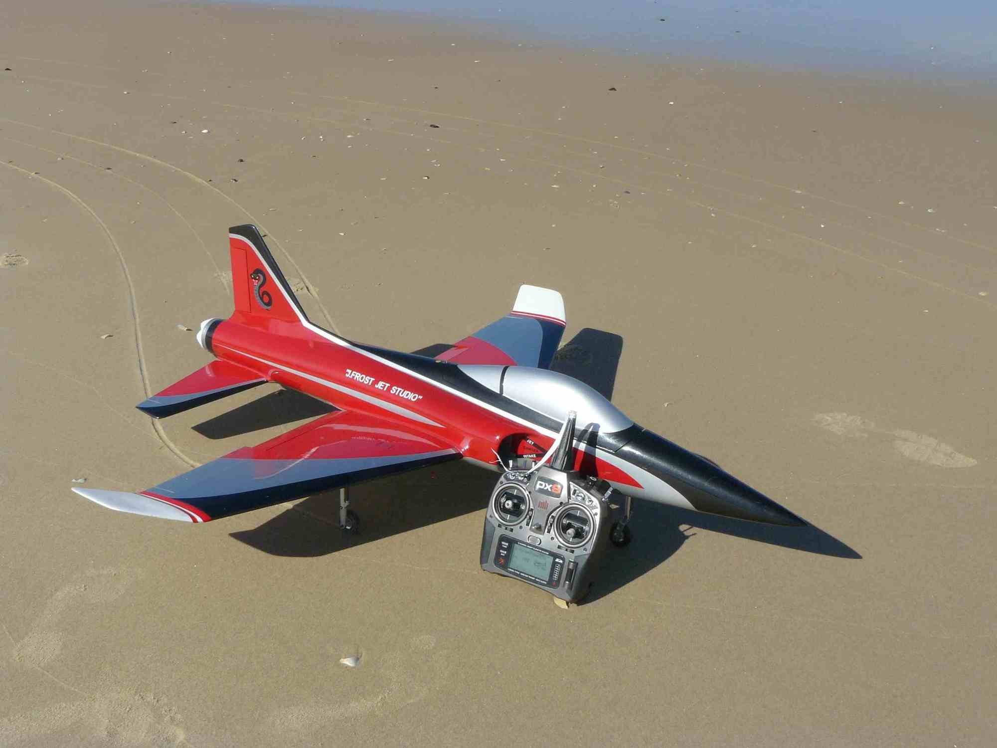

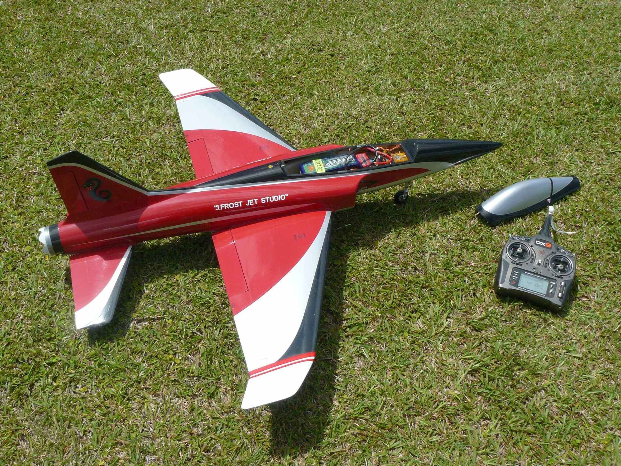

I have lot of fun with my Eflite "Habu", rather heavy model but moves nicely after lot of mods. (pics)
Got this one fully set up for a song, 200 bux OZ.
Perfect strip.
Caught in action.

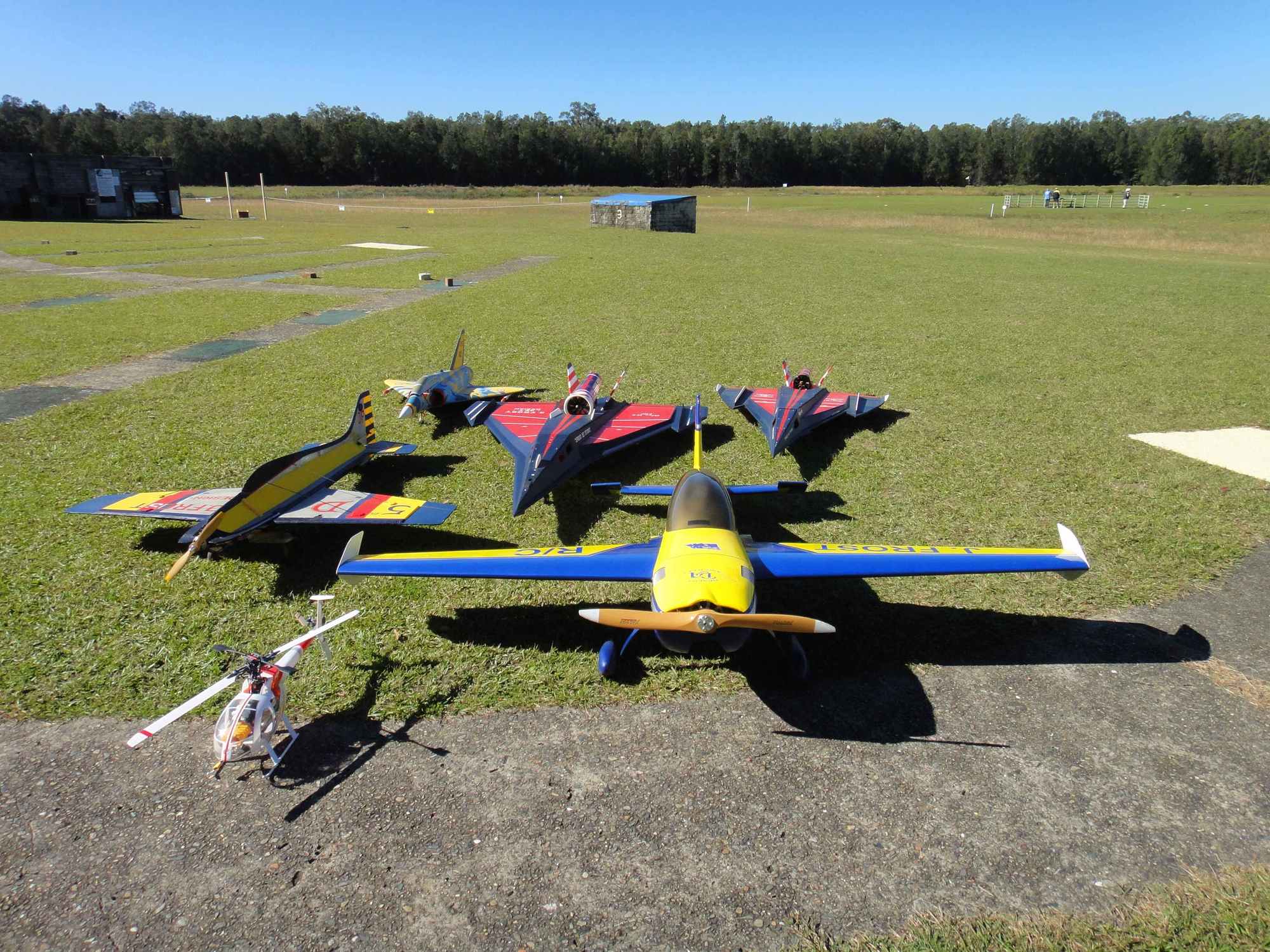

Bit of days variety, combine logged flight time with these 6 models is well over 3500, 3-7 minute sessions over last 9 years.
Just back from another great flying trip with some variety of models, all programmed to low timing and PWM Freq.
