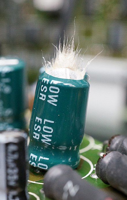

If you cannot but extend, extend the motorwires instead of batterywires and keep controller(s) close to battery(s). No need for extra input capacitors
Too long wires batteryside will kill ESC over time: precautions, solutions & workarounds - RCG

Originally Posted by NewTinkerer
Okay so I'm new to the RC world ...
Some well-structured reading for rainy/windy days, and some handy e-tools as well. Will save you, and us a lot of questions. Notably the 'what went wrong?' kind of questions Will also prevent you from burning up several controllers and/or motors and/or battery:
E-flight primer and tools
And pleasepleaseplease, do your RC equipment, wallet, ego, battery, controller, motor, house/garage/car a big favour ... get a watt-meter. It will more than pay for itself, will save you at least one fried motor and one fried controller. Will also help you finding the best setup.
Keep battery-/-watt-/multi-meter wires short!
too long wires batteryside will kill ESC over time: precautions, solutions & workarounds
