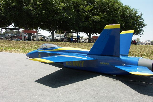

The FA-18 from Warbirds-RC is a single fan Electric Ducted Fan Jet. It uses a Minifan 480 and a variety of motors have been proof tested on the model. This jet ROCKS...Period!!! It is one of the best looking, best flying Minifan ARF's I have ever flown and it comes highly recommended. A brushless combo is required to get the full performance from this model and depending on your final AUW, it may be hand launched, although I bungee launch mine.

Yes, you can do a fixed landing gear mod...I know of one person that even did his fixed gear so it would be removable and he could bungee launch if he wanted. It does not come with gear. It is a balsa and ply jet, pre-covered in either Gray or Blue Ultracoat. As the website shows...it's an ARF...glue on the wings and tail feathers, then add fan, motor, esc and radio gear. It uses two servos for Elevons.

The model is assembled using Epoxy and CA...your normal basic glues for model aircraft. You can view the entire assembly step by step at these two locations:
http://www.rocketryforum.com/ctulank...x.php?dir=fa18
http://www.warbirds-rc.com/Models/0008/index.htm
As far as power plants go, the fastest and what appears to be the best setup so far is the Mega 16/15/ 2T with a 3S2P 2200mah Lipo pack...it's a rocketship but also flies slow. I don't know how the Astro compares to the Mega motor so I can't help there. I fly mine on the Kontronic Fun 400-36 and a 10cell 1950FAUP; there is plenty of power and speed with room for more if needed. My next one is going to be on the Mega 2T though!
The model lands absolutely fine with belly landings on grass...I have many flights now and still don't have a scratch. If you have to fly and land on asphalt, do the landing gear mod. For the money, you are not going to get a glass Fuselage, nor is it necessary. This jet flies better than most of the glass bodies and holds up well on landing. I doubt a glass fuse would sell as well, as it would put it out of the price range of most fliers. As is, anyone can afford this kit and everyone IMHO should have one in their hangar...period!

I can tell you that my setup on a Kontronik Fun 400-36 with 10cell 1950FAUP peaked at just over 400W then settled in at 385W and 32-34 amps. It's not quite as fast as the Mega 2T, but flies very well and I have the option of adding another cell or two, thus getting it near the 500W range, where the Mega is pretty much maxxed out at 10 cells or a 3S config. So, in reality, yes the Kontronik will produce some serious power, but the added weight to get it there wouldn't be worth it. The motor alone is almost twice as heavy as the Mega...good for handling power dissipation but bad for weight. My model weighed in at 29oz WITH motor, fan ESC, Rcvr and two HS81 MG servos and no battery...so it's pretty light.
The best combo to date I have seen fly though is still the Mega 16/15 2T on either a 3S2P 2200mah or higher Lipo pack or a 10cell 1950FAUP...they both fly about the same speed...draw is around 40amps or so and around 450W. You could go 3T, but that has been a bit dissapointing in performance due to the rpm drop and to get the rpm's back up you have to add more cells, hence more weight. Save your money and buy the Mega 2T and the fan for the price of just the Kontronik.

Check out the assembly pics link I posted...you will see it is a single thrust tube exit. I have no means of measuring the thrust accurately, so I can't help you there. I do know that if you try to run a power plant, be it Mega 2T, 3T, Kontronik Fun400-36, Hacker BL40-9S or any other motor made for this sized bird, you will not fly it on a single 3S 2200 pack. A newer 10C 2200 would not be able to produce the current, 32 - 45 amps or more, needed to drive the motor and you would burn up the pack...note I said 10C, a newer generation pack...older ones would be toast just bench testing. You could use a higher winding motor and get your current rating down around 20 amps, but then you would have given up thousands of RPM, hence speed and performance.
You can make it fly on lower power packs, but the lack of performance would not make it enjoyable. As far as NiMH, the 1950 FAUP and 3300's can supply quite a bit of amperage, but do give it up in another way with shorter run times. I get about a 4 minute run on the 1950FAUP 10 cell packs. The big disadvantage is that they are heavier than a 3S2P pack by a couple ounces or more. However, the 1950's can supply 30-40 amps nominal with 45-50 amps peak and I have heard near 70 amps for the 3300's, depending on the setup.
It comes down to the fact that if you are looking for an FA-18 that can run on a single smaller Lipo, this wouldn't be the jet for you. Unfortunately, it's about the only good ARF out there, so you will have to settle for a kit or scratch build.

Tim...no problem man, glad I could help with the numbers. Unfortunately, I am pretty much out of comments as you are delving into an area that I have not seen tested, so you will be pretty much on your own. I am sure the model will fly on lesser setups as it glides well and has long legs on landing, even at my weight of 43oz AUW with the 1950 pack.
So if you keep it at 30oz or so, which seems pretty light seeing how mine was 29oz without battery, you just cut down a bunch of weight. The only thing I see on numbers is you may have more TTW with a lighter setup, but the output, and more importantly velocity of the thrust will be much lower, hence your top speed will decrease. RPM will be 20,000rpm less than what I would call a normal setup...that's quite a big change.
