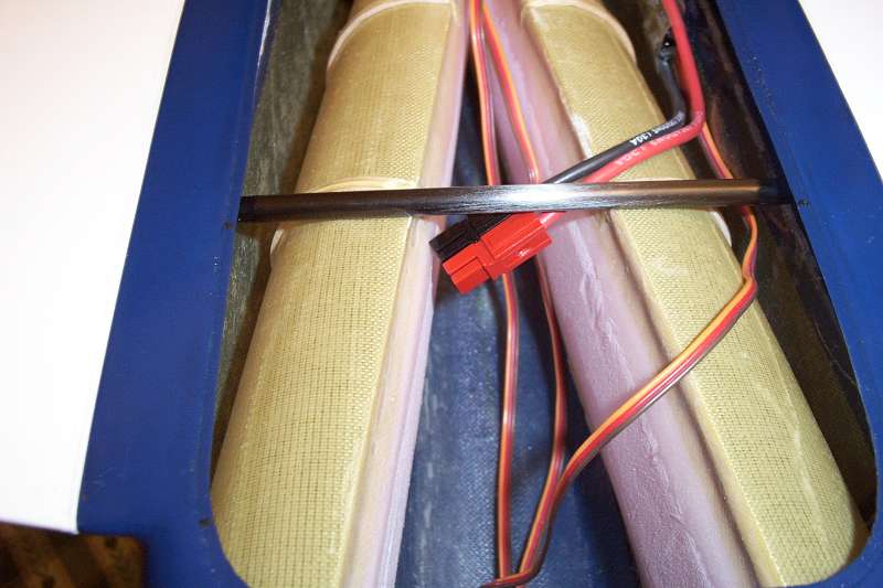

Here is an update on my MF480 project. I decided to call it the DoJet after the nickname of the full size jet that I fly, the Dornier 328. I chose to use the Mega 16/15/3 with a Pheonix 45 from Castle Creations. Castle Creations makes a great product and there costumer support is next to none. I still am debating on which battery to use. The FMA high discharge cells look good but the flight time would be down unless they were in parallel. Any suggestions? Ready to fly weight without the battery is 1.5 lbs, not too bad for a prototype. I had some trouble with the inlets collapsing so I added strips of balsa capped with Kevlar around the shell, that seemed to have curred the problem. The silver tool next to the plane is an aluminum plug that I made to make a perfect exhaust pipe for the fan. There is even a lip that matches the diameter of the fan so the transition on the inside is smooth.

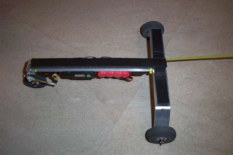

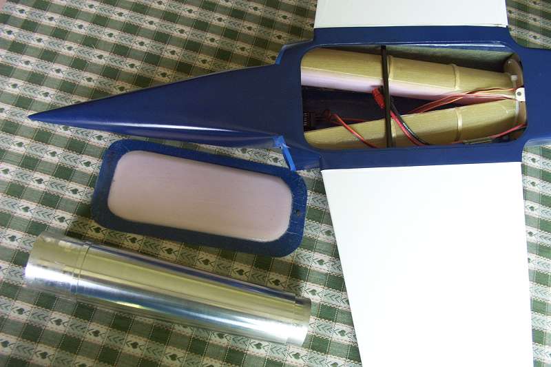

Currently there are no retracts for weight considerations. I have made a dolly that has steering and is just for takeoff. It will be interesting to see if it works. I have purchased two Apogee 3S1P 2080mah packs and will wire them in the 3S2P config. That will push the overall weight just over 2lbs. At 300+ watts that should perform well. The hatch is fiberglass with a foam core and there is a lip on the front and two neodyum magnets on the back. This makes for a clean look, we will see if it stays on inflight. There is a picture of the aluminium tool that was used to make the exhaust duct. The test flight is scheduled for later this week, finally! What are you ideas for a scratch built project flydrive rc?

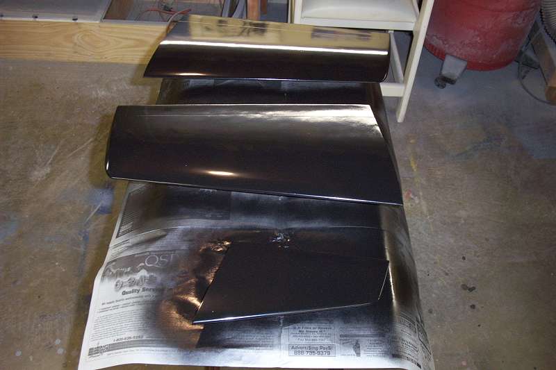

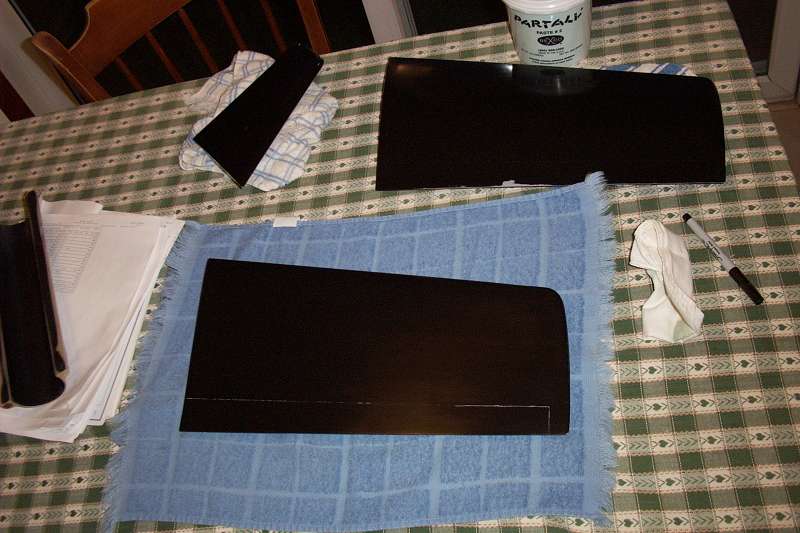

Old 09-14-2004 | 07:50 PM
Joined: Jun 2004
Posts: 122
From: Greenwood , IN
Default RE: DoJet Update

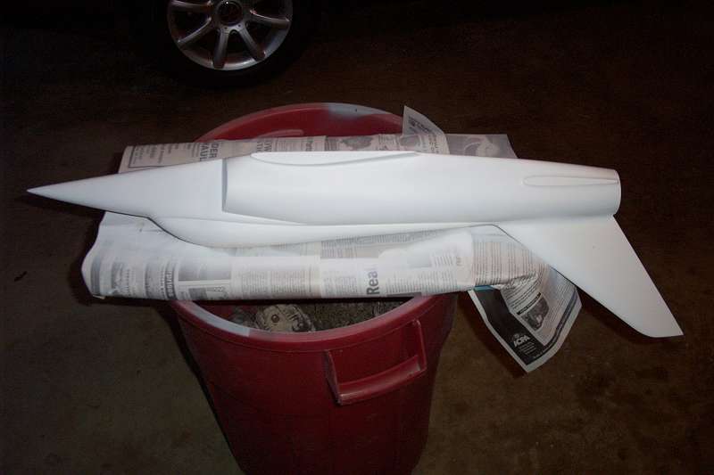

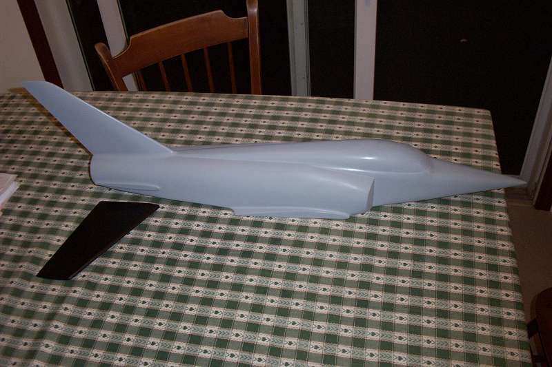

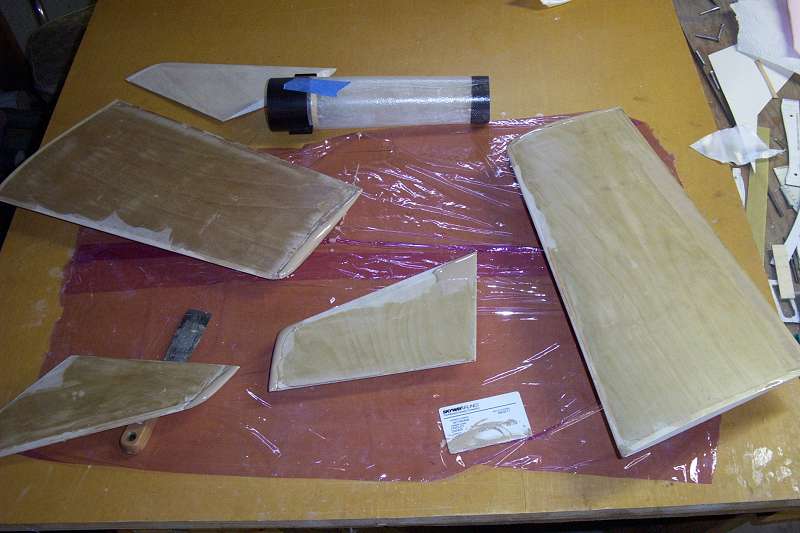

The DoJet is getting an update already. The fuse is getting remolded with an integral fin. The wings and the stabs are getting molds also. The plugs are made from a foam core sheeted with ply and then fiberglassed. The first photo shows that stage. They were then primed, painted and polished in photo 2. Now I am adding wax and buffing inbetween coates. The last photo shows the new fuse with its first coat of primer. I always put a thin layer of primer on first that is a different color than the rest. Then when you are sanding off the outer primer you know when you are about to hit the fiberglass. The outer coat will be grey primer. The wings have also gained a little sweep to make it look a little better! Let me know what you think, FYI the first DoJet is for sale ready to fly.

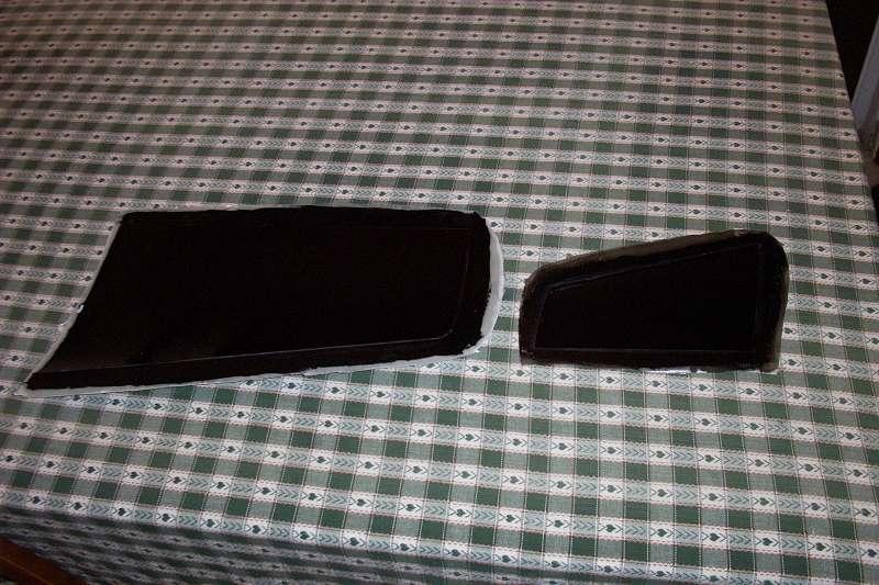

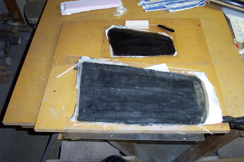

Old 09-17-2004 | 11:03 PM
Joined: Jun 2004
Posts: 122

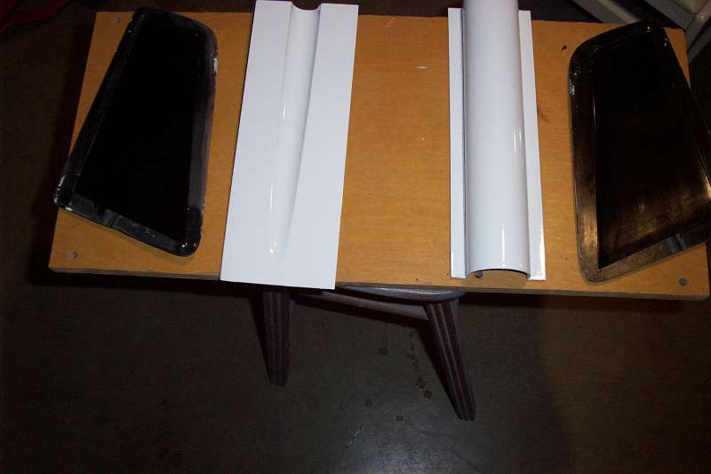

Half of one of the wings and the stab is being molded now. I used black tooling gel from Aerospace Composite Products and the covered that with heavy fiberglass cloth for strength. The tooling gel is great and it makes a very hard and glossy surface.
The fuse is almost ready to be molded and that will be done in the same way.

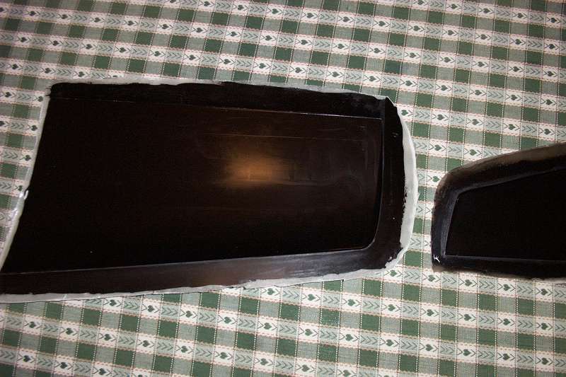

Old 09-18-2004 | 07:59 PM
Joined: Jun 2004
Posts: 122

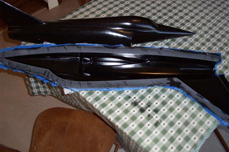

Here is the inside of the mold. They will be trimmed and sanded and then the other side will be molded.

The molds should be done tonight. This is the fuse plug with half of it molded.

The fuse mold is done now. Today I put a few coats of wax on it and used liquid rubber to cast a plug for the wing root. Before the fuse is put in the vacume bag I insert the little rubber plug to fill the void. The dowel rods make holes through the plug for the air to escape. I should have the pics in a day. The wings should be done soon.

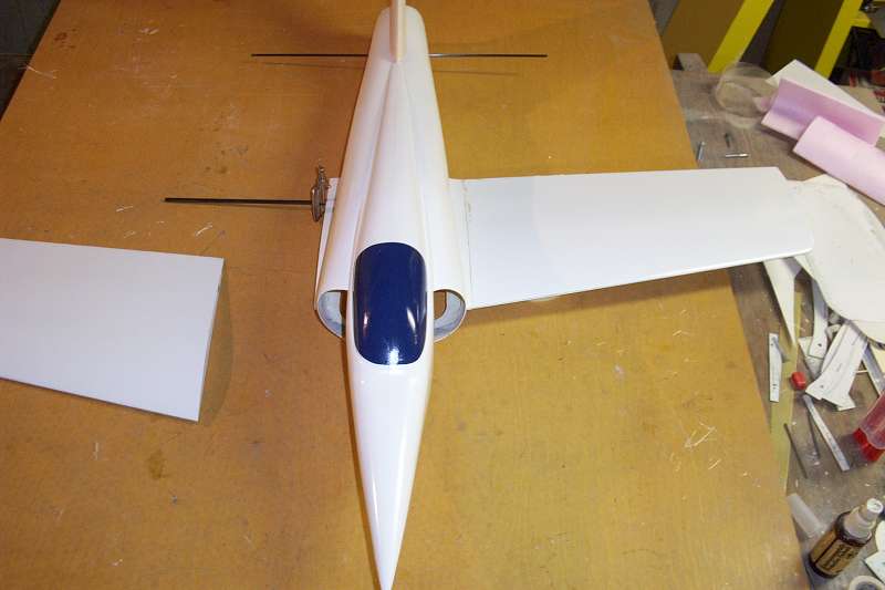

Old 10-13-2004 | 10:53 PM
Joined: Jun 2004
Posts: 122
Today I put on a coat of PVA and then painted the first MKII fuse mold. I also attached the first set of molded wings to a MKI fuse. It is amazing how much you learn on each piece made, already I have thrown out two tails and a few other smaller pieces. The new MKII fuse doesnt have specific hatches marked out because i want to experiment on this one to get it perfect. There is also plans for a MKIII version that would have retracts. The nose retract would be a commercial unit but the mains would be custom made out of composites to save weight. Any suggestions?
