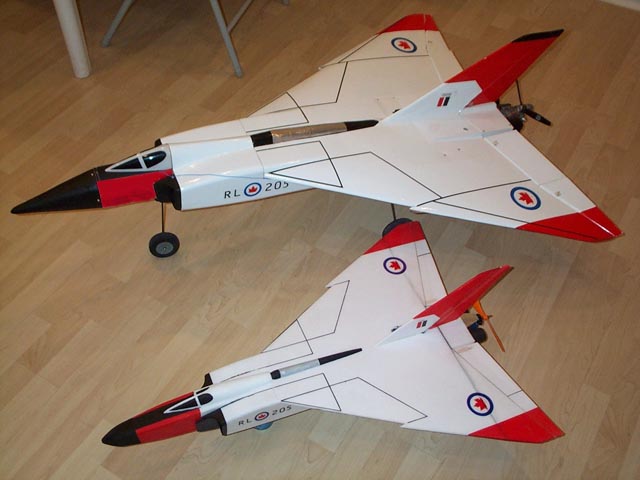

My website was down for a while but it is back up. www.madrc.com. I have started on designing a twin edf 36 in wigspan Avro Arrow. I will post once I have some work done. It should be the same size as it's glow version big brother.

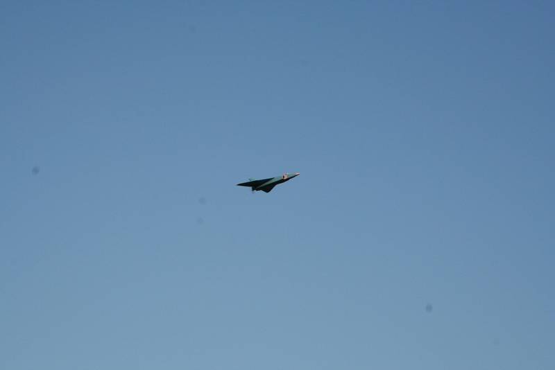

Not too much traffic on this site but I just wanted to say that I flew my Avro Arrow this morning and all I can say is wow. I have not flown it for one reason or the other for about a year and boy did I make a mistake. Thjis is one of the best foam flyers I have seen. Flew it in 15 mile an hour winds and was amazed. Most people do not like to fly foamies in the wind but this one loves it. Not only do you get Zoomy high speed pases with the wind, But you can almost stop it in mid air with high alpha flight. If you have not built one, you should. If you have, go and fly it. That being said, my website is gone so if you want the plans you must go to some of those free foamy plan websites or e-mail me at [email protected].

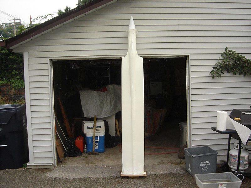

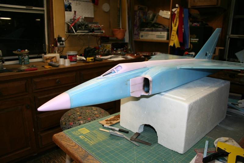

This is an ongoing Avro Arrow project. The fuselage is about 11 or 12 feet long.
Might be interesting putting a few electrics in it.
http://www.rccanada.ca/rccforum/showthread.php?t=78504
We finally got to the start of moulding stages at page 7 of the thread.

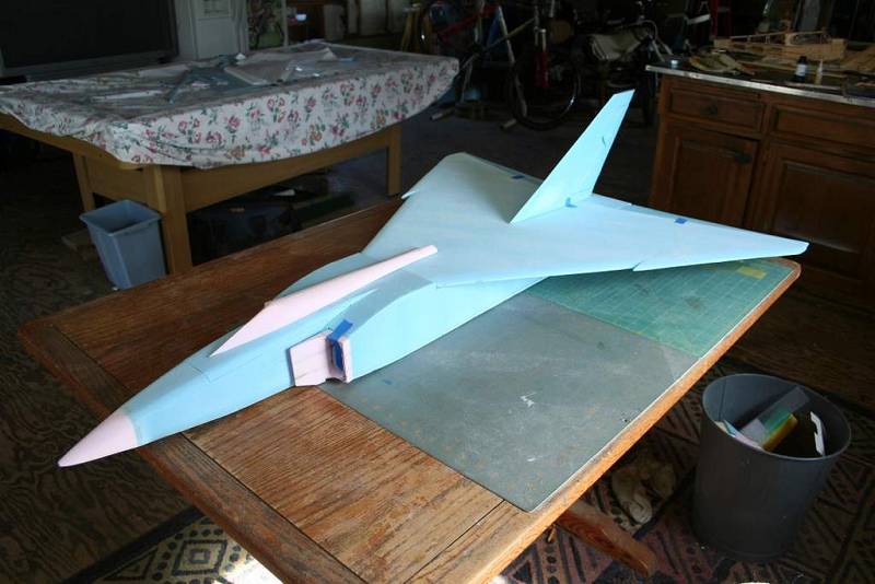

Hello Mark,
I just happen to stumble upon this thread as I don’t frequent this site much anymore. What caught my eye, was the plans you posted on the first page. I think those are the plans I used to start building my Arrow. I got the plans from pusher jets forum over on RCG. I scaled them up to get a 36†WS. I did take the liberty to modify the build a bit and incorporated Shumate style techniques in many areas. See the pics. I like the flow-through design as I believe it cools the ESC & motor more efficiently. Unfortunately, after a semi successful maiden flight, where the motor mount broke in half 4mins. In, the arrow went in hard on flight #2. I’m still a bit dumbfounded as to the cause. After the maiden flight in which I had to trim in a lot of up-elevon, to achieve level flight, I noticed after landing the amount of reflex was huge! I took this to be a nose-heavy condition. I was back ~1/2†from the CG on the plans. The plane was also a bit twitchy during roll maneuvers. The response to roll commands seemed to lag then roll quickly. I had read somewhere that if the leading edges of smaller planes were too sharp, that less than stable handling can occur. My leading edges were sanded to a sharp edge so I rounded them off a bit, added some tail weight to bring the CG back hoping to get rid of some of the reflex and went back out for flight #2. When I threw her up, I didn’t give any up angle to my toss, (I’m tossing off of a hill so 30’ straight out gets me 15’ of altitude). She just sagged down the hill and no amount of up stick helped. Into the weeds and shread the nose back to the intakes!! D@mn! I hate when that happens!! Accept for a few dings and missing chunks of foam, the rear & wing survived intact. I couldn’t believe she wouldn’t pull up at all! The only thing I could figure is the surface area of the elevons isn’t enough. So I’ve cut them off, widened the elevons out toward the wing tips. The overall shape of the wing didn’t change. I’ve about got the nose repaired and should be ready for round 3 in a week or two. The power system is no slouch at 450watts and an AUW as pictured at 52oz. If you have any insight to my dilemma and or any suggestions, they would be greatly appreciated. Here’s the specs on my Arrow; Blu-core, FFF construction. Wing and tail are double thickness. 36†WS, 49†length. BP 36mm 1500kv outrunner with a 60amp ESC, 3amp UBEC, 4s, 3000mah 20c Lipo with an APC 8X4e prop. HS-81s for elevons & HS-55 rudder. Also pictured is my FFF F-15 at 39†WS, 53†length. Same power system but an AUW of 62oz. and a wonderful flyer. Love those bigger jets! Blue skies.

With the power you have, that plane should fly well. I did notice something odd when developing my .45 glow version. I too made a full scale mock up in blue foam. I carved the entire thing including using a hotwire to cut an airfoiled wing. It was primarily a test glider and then converted to electric. Oddly enough, the plane would just not glide until I placed the wing upside down on the wing saddle. I initially had a somewhat semi symetrical airfoil that should have created lift but for some reason did not. I fliped the plane to inverted and gav it a toss and voilla. She glided right accross the gym floor. Perhaps the shape of the carved leading edge or airfoil is messing things up. On another note. My gas version has about 3 degrees of positive angle on the main wing, This puts the thrust angle at 3 degrees to the main wing and I believe that aids in keeping the nose up under power. If the motor broke off during the maiden, perhaps when you glued it back together, you inadvertantly glued in up thrust on the motor. This would account for not being able to get enough up elevon to fly arround. It makes sense because you seemed to be able to fly arround on the maiden and I dont think you added too much weight in the repair. Let me know if these ideas help. My next plane is going to be a 36 inch depron Arrow. I have found a wonderful and cheap motor and speed controller for this size plane. Auw should be 2.5 lbs.

Thanks for the reply Mark. The wing is a flat airfoil. When the motor mount broke, just the motor fell off & I was able to softly land in my neighbors' sandy horse arena. The mounting stick is solid and unchanged. A new motor mount, A beefy one, and a few cosmetic patches where the prop hit the foam before becoming detached was all that was needed to fix. I've always set the thrust line at 0 deg. on all of my other pusher jets, but I will recheck the thrust line and maybe try your suggestion to add some slight up thrust to the motor. I've always used the LAR, (looks about right) method and maybe it wasn't about right. I love cold war jets! This plane has such a mistique and strange history, that a complete airframe wasn't preserved for a museum boggles the mind!! Your planes look great!! Thanks again for your time and suggestions. I'll let you know how things turn out. Happy flying.

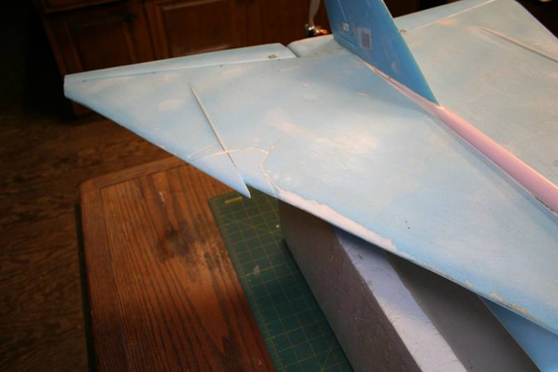

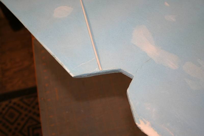

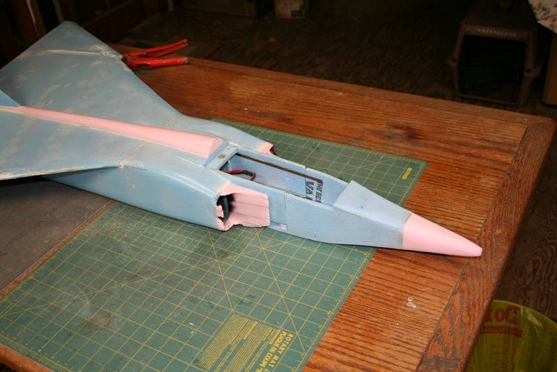

Here's a few pics of the crashed & repaired Arrow. I hope to try to fly her again in a day or two. Wish me luck.

I took the arrow out this morning and threw her into the air. She flew very well with no real surprises. I added the slight up thrust Mark suggested and all went good. She balloons a bit with full throttle but when trimmed to fly flat at 1/2 throttle, she came down with the elevons nice and level. I may back off a tad on the up angled motor which should cause me to get a bit of reflex into the elevons & lessen the ballooning. Now she's in the paint booth getting spackeled, sanded, sealed and painted up. This is really the fun part for me as I'm going to paint her up as RL 203. Researching the symbols, insignias & markings, which were slightly different for each plane, is sometimes a challange. Thanks all for your help, suggestions & thoughts. Blue skies.
