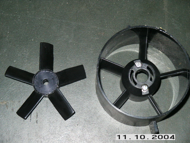

Got this in a smaller home built ducted fan jet and would like to know the manufacturer...
The housing is 3 and 1/2" Diameter and the can size is 1 and 3/8ths". More picture can be posted or emailed if needed.

This Is a wemotec midifan shroud. I dont know what the rotor is. could be home made. I would test it very thoroughly before trusting it to fly a plane. I dont think it will be as good as the original midifan rotor! Fortunately these are available, very cheap from wemotec.

This is a pre-Wemotec unit. EJT (Electro-Jet Technology) was purchased and became Wemotec. The unit is the older EJT unit. They work well but not as well as the Wemotec Midi.
It was called a EJT-540/600 if I remember correctly. Not for high input power.

Oh I stand corrected! This artifact was from before my time of edf. LOL. It doesnt look like they changed the shroud much!
