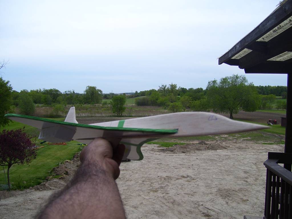

Here are first pictures of "Chuck glider/Proflie glider" model that i built today.
Model Specs:
Scale 1:67th
Wingspan 15"
Length 32"
Weight few ounces AUW.
It's to be used to properly figure/determine CG balance point for my BIG Concorde model
It will also be hand launched and flown to see how it handles as a "Proof of Concept"
Once this prototype is successful then i'm planning to make 2ft wing span model powered by twin 50-55mm EDF Hyperfly from GPlanes. That model will be exact copy at 1/4 scale for my BIG one to be build soon.
Let see what you guys think.

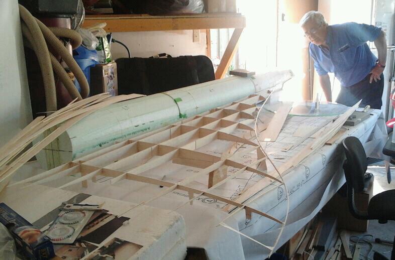

Today's progress...
This Concorde could be at Chatham this year, lets see where she will in terms of build by that time...
Spars were made, interlocking was creatred for spars to join the root rib, wing's main structure is being made now...

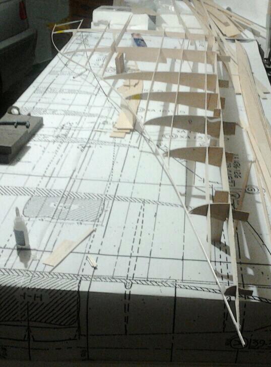

Old 05-21-2012 | 10:22 PM
Joined: Aug 2005
Posts: 4,196
From: Mississauga, ON, CANADA
Default RE: concorde

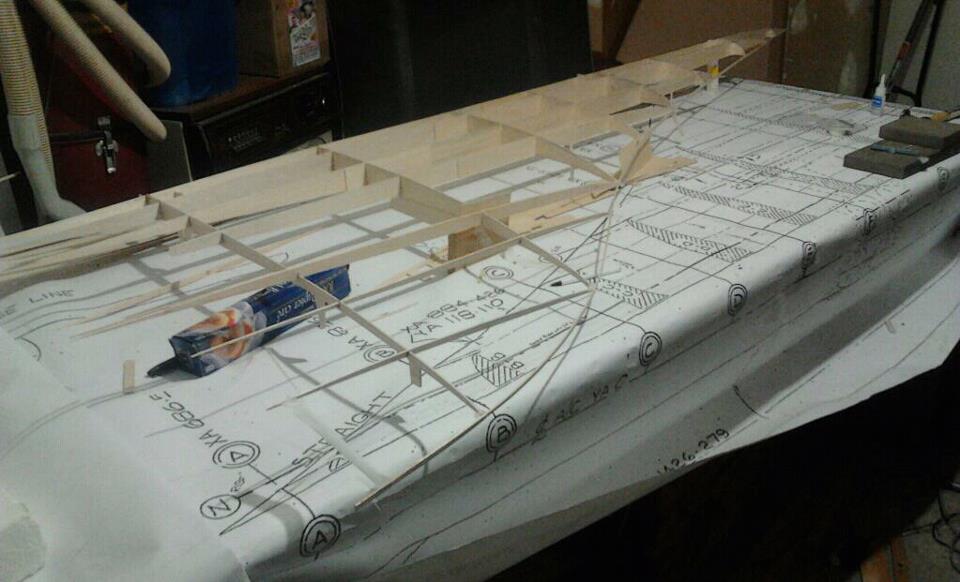

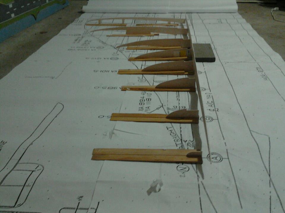

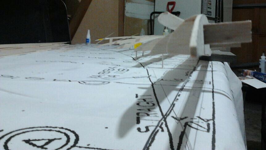

One wing is all framed up now, i have been working on it since 2pm today and it's 11pm now.
So far looking great but i should have used 1/4" balsa sheet or 1/8" lite ply sheet to make the wing root ribs, 3/32" is just to thin for this wing type!, it's flexing quite a bit even after wing is framed up now.
I couldn't able to make the 2 spars and 2 ribs today as i was manually making interlocking notches multiple times on these spars and ribs which really consumed most of the time, good that my dremel rotary tool with cutting bit came in handy after installing 3rd rib to speed up the process other wise i would have 3/4 ways in terms of framing up this wing by this time.
First 2 pictures were taken as 5pm, after 3hrs of working on this wing today.
Second 2 were taken after 3rd rib was installed
Remaining were taken at 1055pm just after full wing frame was complete.

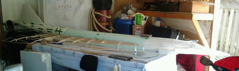

Today i met with another scratch builder from other forum at my place when he came to buy my Joe Bridi's Shrike Commander kit, he was astonished and literally blown away by this model and my S Connie, it was great meeting another scratch builder as our breed is on dieing scale due to 95% ARF flyers out there...
After Chris left i managed to dry assemble tail and aft fuselage section with rest of the structure, here she is with full fuselage and right side wing...
