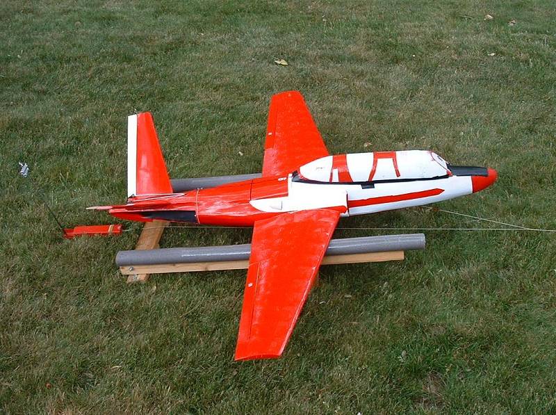

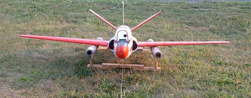

RE: How can I build my own Bungee launch system for my HET FA-18? If anyone has built their own bungee l
Here are a couple of pix of my ramp. It's made of scrap wood and some 3/4" foam pipe insulation. The pedal release was purchased somewhere or other. The cord is a Home Depot item.
For a size reference, the WS of my Fouga Magister is 56"
wow, it is really short! What kind of cord you buy at Home Depot? I was just there and they don't have bungee cord. I found this really good site showing how to build a pretty good launcher. http://www.yourzagi.com/launcher/
