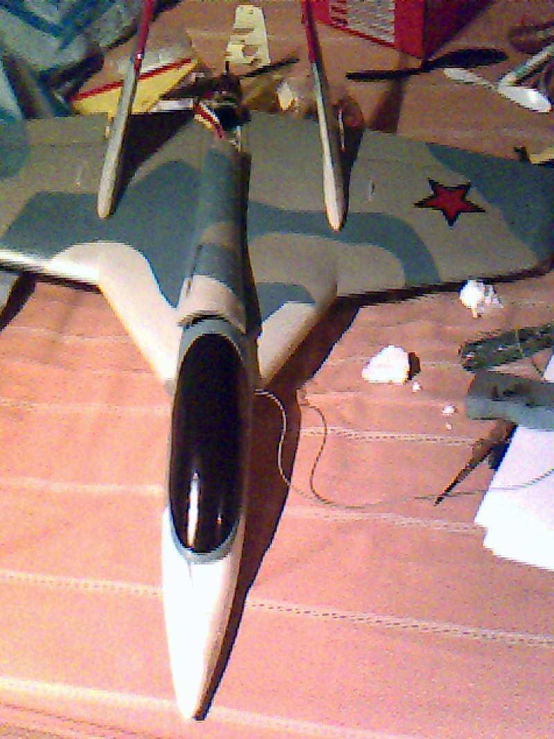

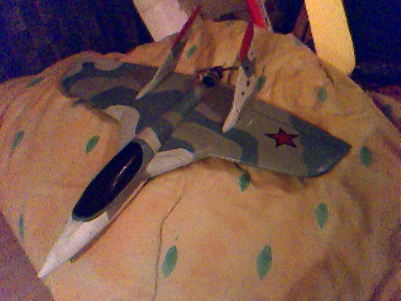

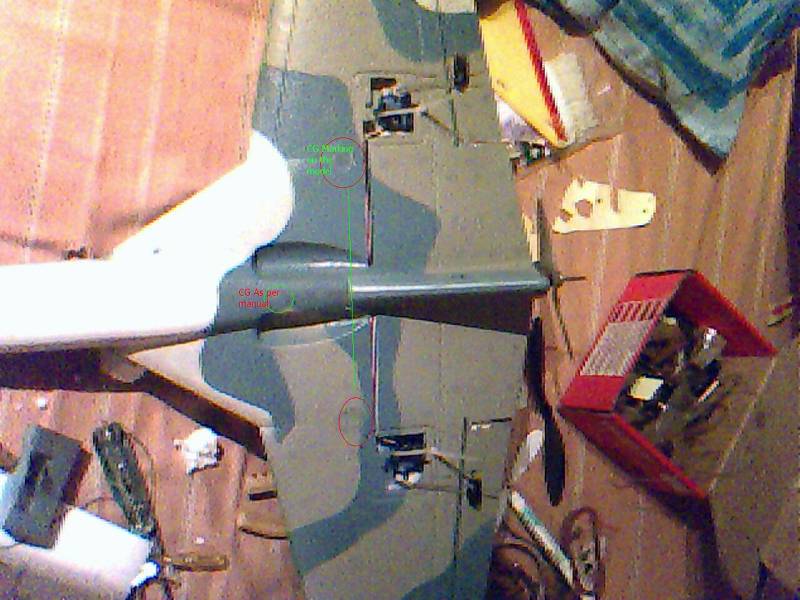

Hi,
I am having trouble finding the correct CG location for this model .It is a "multiplex microjet" lookalike and the dimensions are exactly the same.Only difference bieng the vertical extension under the motor mount to prevent prop strikes.The Cg location marked under the fuselage is circled in red while the cg location in the microjet manual is marked in green .I hope someone can point out the correct Cg location .Plan on flying it this weekend provided the Cg issue gets resolved.

I would say the recommended CG seems to be waaaaaay to far in front. Why not compromise and then expect it to be still slightly nose heavy. All the best!
