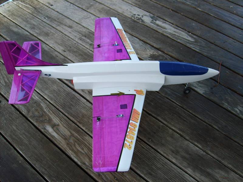

Default RE: Turbinator-E
I finished mine a couple of days a go. This particular plane is not an easy build. The effort was worth it. I did deviate from the plans a bit.
I am a bit lazy, and so I ordered the short Kit From Laser Design Services. All the parts were very accurate. Shipping was reasonably quick and well packed.
I don't like the idea of the aileron servos on the bottom. I have this issue with electronics and dirt. They were moved to the top. It is something I have done on other planes, and noticed no difference in the way they fly. I happened to have EPF retracts. Installing them was a bit of a trick, but with a little ingenuity and some careful surgery they fit fine. I didn't care for the canopy shown on the plans. After roughing out the fuselage, it seemed that it would look tacky. This fuse has such elegant lines that I elected not to install the canopy shown. I used some trim Ultracote and got creative.
The hatch as shown would not have worked for the setup I use. I prefer to build planes to suit the batteries I have. My current favorite is Zippy 1450 3s 30-40c. These will power everything I fly from a GWS Slow Stick to a Stryker with a WM 400 fan drawing 49 amps. I have paralleled these with great success. With this in mind I set up my Turbinator using two of these batteries in parallel. The fan I mounted is a HET 6904 with a 2W motor. On my test stand this combination provided 42 ounces of thrust at 52 amps and around 490 watts. The hatch has been extended one former further forward. (Starts of F-2)
CG as marked on the plans came out with the plane balancing slightly nose heavy when the landing gear is in the up position. Weight came out at 49 ounces. I haven't had the chance to get a maiden flight on it. It strated raining here a week ago, and as usual it is still raining. I tried to post the pictures of the finished bird, but was unsuccessful. If I do rekit this one, I will have to build another. It is a very elegant plane that was well worth the effort to build.

There were some other deviations I forgot to mention. The plans call for a 3/32 sq balsa spar on the leading edge of the wing, and top and bottom of the main spar. I installed .157 carbon fiber tube that is available locally. I had a carbon fiber tube from a helicopter that I failed to fly. It just happened to be the right size and length. I don't remember what helicopter it came from.
The graphics were pretty simple. I just used Microsoft Word, and went into Word Art. A friend of mine turned me on to a sheet of Avery Full Sheet Clear Labels. Simple and clean seemed a better solution for the graphics.

I finally got a maiden flight on my Turbinator. I found no nasty tendencies. It flew very smoothly with little trim needed. (dumb luck.) It did seemed to be a bit underpowered. With that in mind I installed a WM 400 fan using a Mega 2 motor. This particular combination draws 39 amps. I will have to recheck the wattage. The switch in fans was very simple due to Mr. Zirollis design. From what I see, this is a very well designed plane. I will still need to tweak it out a bit, but I can see where this will be a very good flying airplane once all the final adjustments are made.

Crash, the WM 400 fan works fine. The plane seems to have a bit more power. I have tested the thrust using my test stand. I was getting 2 lbs, 4 ounces of thrust at 39 amps. The motor I used was a Mega 2. I do have other thoughts on that subject. I have a modified fan that is getting almost 3 lbs of thrust at 65 mps, 670 watts. Keep in mind that this set up is using two Zippy 3s 1450 30-40c batteries hooked up in parallel. If you can get your hand on the parts, it should work better. I used a RCLander 68 mm fan housing, a HET 2w motor, and a HET four bladed rotor. It is a bit heavy, but much lighter than the stock RCLander setup. The sotck fan weighs eight ounces, and the modified fan weighs 5 ounces. I am using this same fan on a RCLander F9F with a flying weight of 42 ounces. Trust me there is more than enough power. Flight times are around 3 1/2 minutes. I could probably get more flight time, but there would be a sustantial weight penalty. Mounting the WM 400 fan is easier, and one would have to get creative to mount the RCLander fan.
