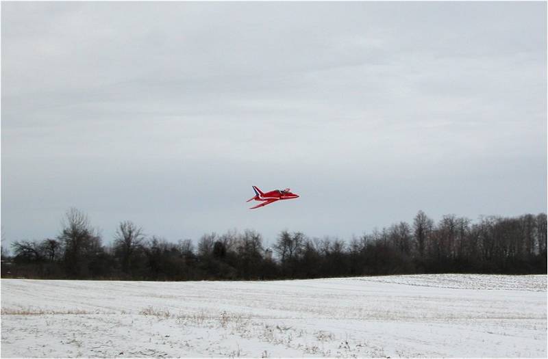

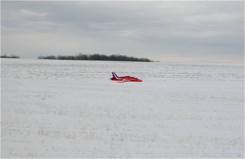

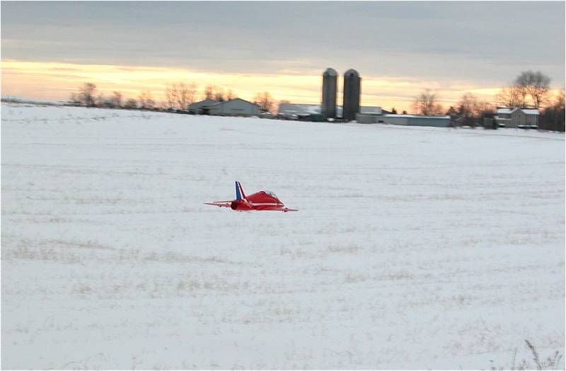

We had an opportunity to test fly the Hawk this weekend in some pretty harsh conditions. The cold winds gusted from 15-25mph but didn't seem to phase the Hawk on either a 5s or 6s LiPo pack. This plane is an impressive flyer and can easily be hand-launched. I look forward to flying it in more favorable conditions next summer.
[link=http://www.gregcovey.com/reviews/FlyFlyBAeHawk.wmv]FlyFly BAe Hawk Flight Video[/link] (13meg)

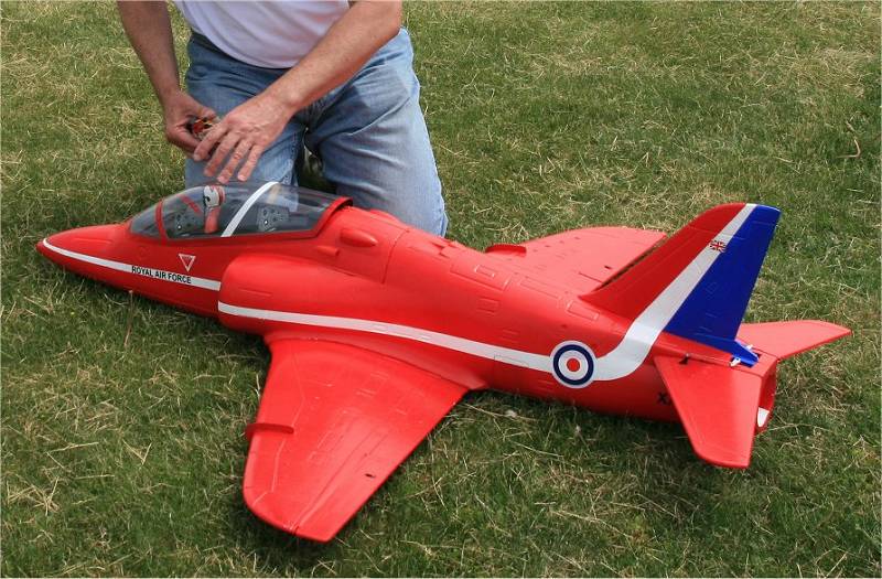

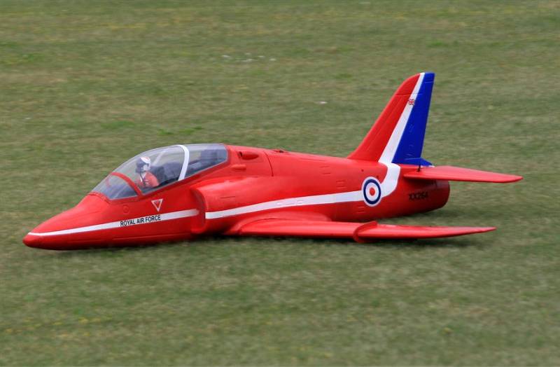

We have had plenty of fun flying my BAe Hawk this summer. The only modification I made was to replace the horizontal stabilizer connections to the fuselage with a single piece of 1/8" music wire that runs through a 5/32" brass tube mounted through the fuselage. This single wire enhancement really stiffened up the stabs and makes the Hawk fly very stable at high speeds. The great flying performance can be seen in my new video below.
[link=http://www.gregcovey.com/reviews/FlyFlyBAeHawk4.wmv]FlyFly BAe Hawk Summer Flight Video[/link] (9meg)
