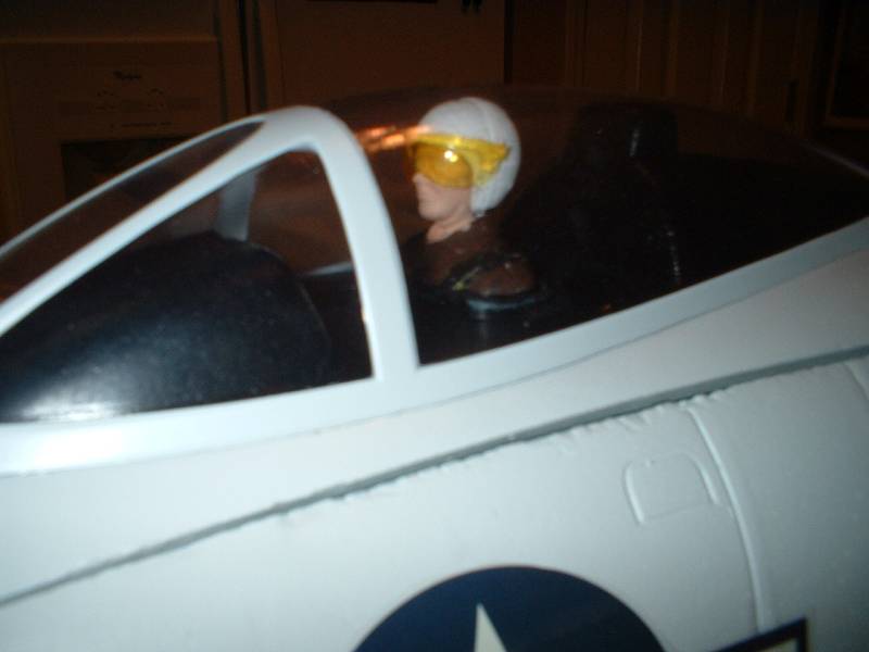

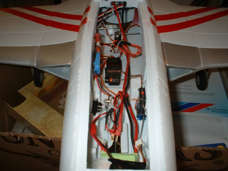

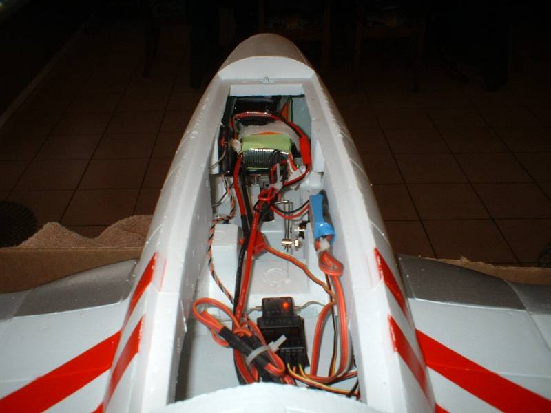

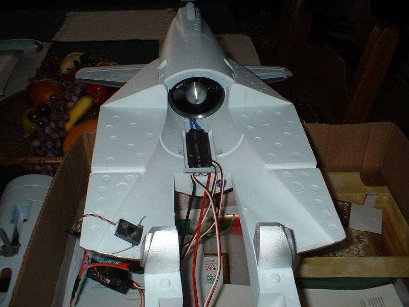

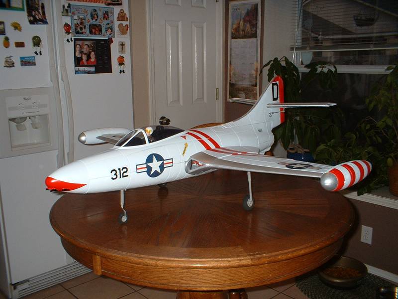

Just finished up my Panther. Test hop later in the week. It went together real smooth. Mike

Mike, Your Panther looks awesome. About how much time did the assembly take ? Also, are you going to use the BEC function of the ESC ? or a seperate receiver battery pack ? Weather has been cold and snowy up here .... I have not started assembling mine yet. Bob
Old 12-30-2008 | 11:03 AM
rcmiket's Avatar
Joined: Dec 2003
Posts: 5,278
From: El Paso, TX
Default RE: RCLander Jets
Went together pretty quick. The instructions stink but if you've been around the block once or twice its easy. Most of my time was waiting for the 5 minute epoxy to dry. I used the stock ESC but disabled the BEC and went with a separate CC BEC with a 1900MAH 2S LiPo for power to the servos. Were having some great weather here. Mornings are cols but by noon were at 50 then 60 by late afternoon.. Winds have been really light also. In El Paso we have flying weather 365 if we get snow its gone in 30 minutes so its easy to deal with it. I don't miss cold winters one bit, Mike

Thanks Mike. I have read numerous postings about people disabling the BEC function on the ESC and doing what you did. Just wondering why ? Are the BEC circuits on the ESC's not reliable when you go 4S and up ? Are those small seperate gizmos (like the one you are using from CC) more reliable ? I guess they must have a voltage regular built in to allow the use of a 2S pack ?

Seems like the ESC/BEC are just not up to the task. I went with the CC BEC and it steps down the voltage from the 7.4 volt LiPo. My main concern is mechanical retracts may bind. Drawing power from the main pack causing major problems. This would have been a bad thing in the air. I would rather be safe than sorry. The Panther is running 7 servos which I felt was a bit much for the stock unit. My F-16 only uses 5 which I was comfortable with and have not issues so far. Its a judgement call by the owner. So far I've made the right calls and am flying and having a good time with no issues. Mike
