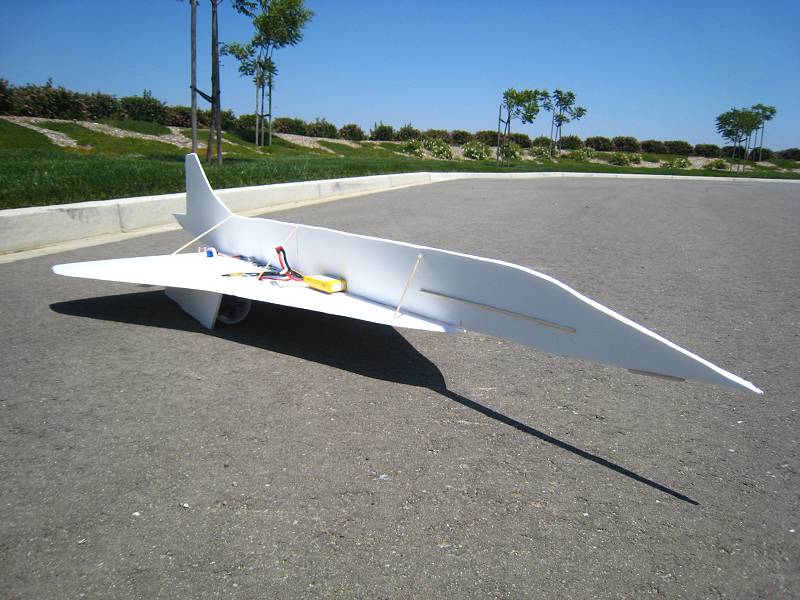

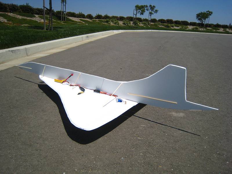

Some pics.
ID:	1206368   Click image for larger version
ID:	1206369   Click image for larger version
ID:	1206370   Click image for larger version
