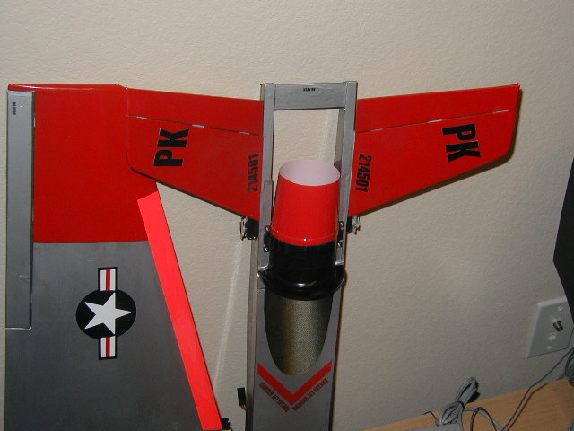

I too just got some plans for the Turbinator-E. I started cutting a few parts and am going to try a foam core wing. About your first question,
you should be able to fly that with a 4s 2000 bat. I am using a 3S, 2350mAh 25C in a HET Sniper and it gets up and goes. I bungee launch this thing and have no problems. The Sniper uses a Wemo 480 w/Walkera 3900Kv motor and an Exceed 60A ESC it draws about 36Amps. Go to rcgroups.com as they have guys who are really into E-jets. I think that some type of tail cone however short may help. Here's what I mean.
From what I've read these ducted fans need good ducting to work better than having them out in the breeze. That tail cone is just a plastic Dixie cup cut to fit and taped on. A guy had a radar gun that the field and that plane did 78 mph avg. and again with a 3s battery. I need some 4 cells to go faster. More volts faster, more capacity longer flights. Another thing, someone told me higher C rating is what you need or jets, 25C -30C.

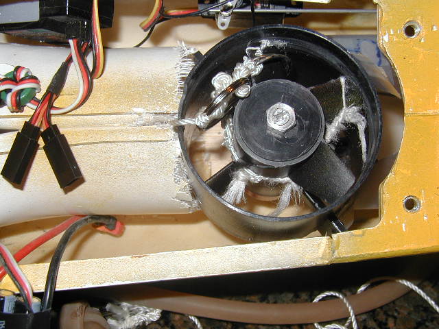

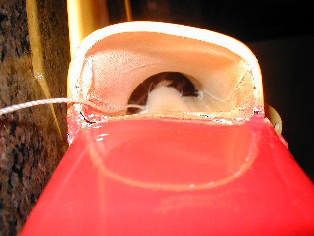

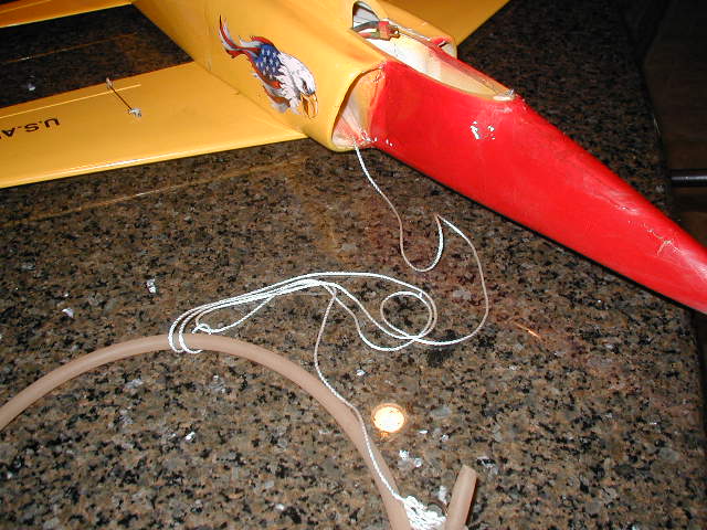

You might want to try Electric Jet Factory, I ingested part of the bungee string..long story..and destroyed the Wemo in the Sniper. I called EJF to see if they had any but they had none. The guy I talked to suggested the HET 6904, which I purchased. It came a few days later and I installed the Walkera motor and ran it today in a test mode. It was pulling the same watts and amps as before. It was actually 48 Amps & 500 Watts. EJF
also has a fan set (fan, motor & ESC) for the same price you mentioned above. I mentioned the amps & watts on rcgroups and 1 guy said I should be using at least 3000mAh and 4S with this setup I have. I know that I am abusing the batteries, they are quite warm at the end of a 4 min flight but that's all I've got for now. I hope you get problem resolved.

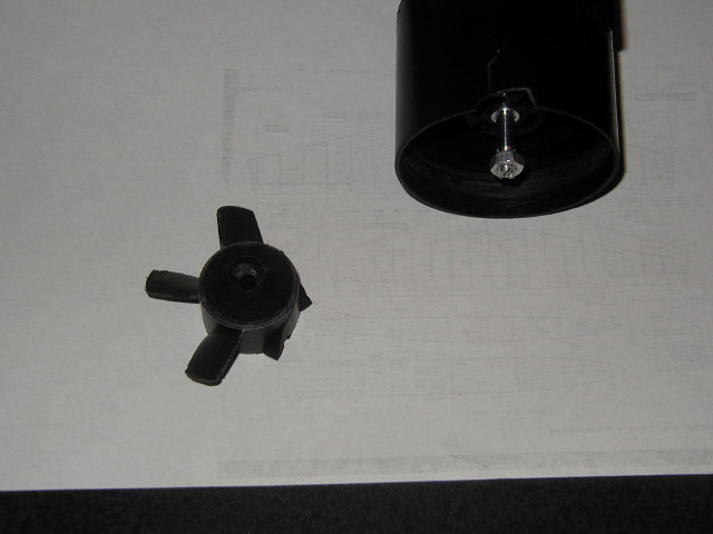

I just got my het 6904 fan and 2w-20 motor. I didnt check that the impeller was centered perfectly and sure enough, a light touch of throttle and it scraped. There isnt any amount of finegling I can do to get the motor shaft centered. Is there a trick to getting it centered? Or do I contact EJF about this? I know I have to balance the impeller and polish the fan bore.

When you get your 6904 you may have to file the motor mounting holes. I had to do that to get my motor centered. My setup (het 6904 with 2w-20) is running now on my test mount. Did some finish sanding to fix the scrap damage. With a mystery 2800ma 30c, 4 cell lipo, 60amp bp esc, I get about 48 amps peak and about 550 watts. That wasnt on a full charge, I'll try that tomorrow.

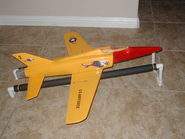

There are Turbinator posts in E-ZONE by the way. I have the Shulman arf version with stock 4S Lander fan/motor and SpringAir retracts. Weighs a whopping 66oz !! No way will this arf build out to the stated weight. The new E-Flight electric retracts will fit and save much weight and some $. I am using Hyperion and XPS 4 X 3300. 35C packs. Flies great but is admittedly heavier than most 70mm jets. Looks very smart in the air, will also look that way for longer than your foamy! Hard G turns will snap at this weight but normal aerobatics are beautiful. Landing is faster than my Lander Panther, Hunter or the Habu but is very stable and much more jet like it sticks! No problems on grass. If you want a "scale " flying jet the Turbinator is very good. If you want to hand launch and do Mach 2 you will not be happy. The Lander fan also has a much nicer turbine sound than Wemo or HET. I originally flew with fixed gear, no really noticeable speed increase with retracts but fairing in the fan and ensuring that all the intake air goes to fan face did improve, standard, the intake is very dirty. I t would be easy to make a fully faired in intake duct but on the arf model would have to cut the fuse open on the bottom not a disaster as the fuse is square in this area. All in all it is a very enjoyable model and is one you can take to field, add battery and fly.
