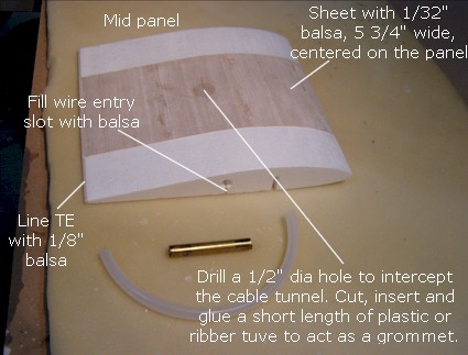

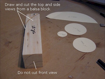

I build a new fuselage this evening. Amazing how fast things go when you are not stopping to take pictures. Besides I was able to rip out the cut plywood and reuse it, and the hatch cover was used as is because I had not balsa sheeted it before abandoning that route. Tomorrow I shall continue where we left off.

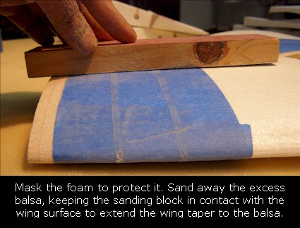

Old 06-23-2010, 11:28 AM
  #33
wowplanes
Join Date: Dec 2007
Location: Merritt Is, FL
Posts: 316
Default RE: A10 Warthog IMAA legal size from Wowplanes

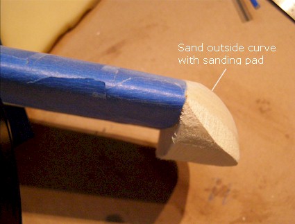

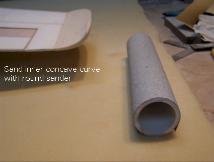

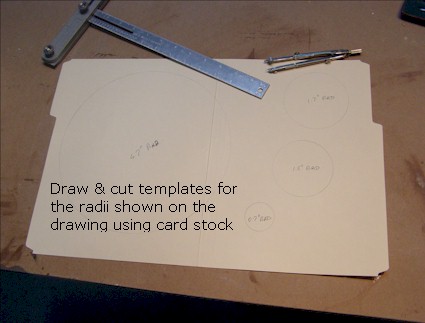

Ok I have rebooted the build after that futile attempt at balsa sheeting. Liquid Sheet makes life simpler and we can build the wing fillets now. The next step will be to sand them to shape.

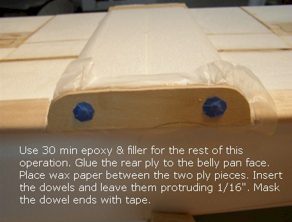

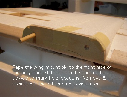

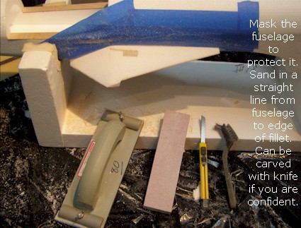

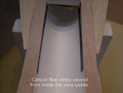

Old 06-23-2010, 05:05 PM
  #34
wowplanes
Join Date: Dec 2007
Posts: 316

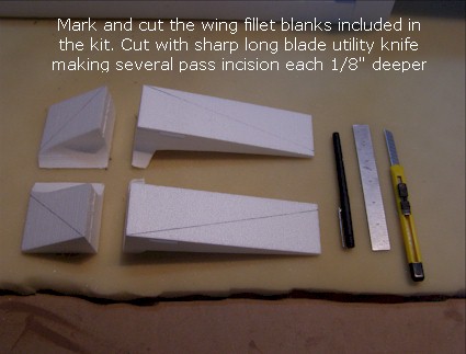

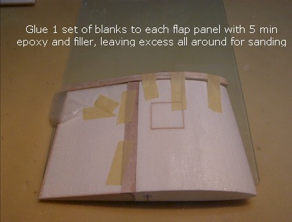

The wing fillets are done and the to carbon fiber stifferners added to the tail. I will put the fuselage aside and start on the wing next.

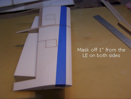

Old 06-25-2010, 01:36 PM
  #35
wowplanes
Join Date: Dec 2007
Posts: 316
I took a day off for some R&R and started on the wing this morning.

Old 06-25-2010, 04:53 PM
  #36
wowplanes
Join Date: Dec 2007
Posts: 316

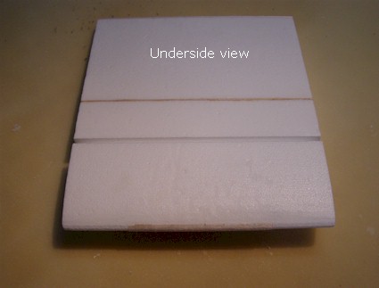

Finished the two inboard flap panels. Next I will join the 3 panels and move on to the outboard flap and aileron panels.

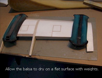

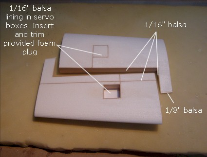

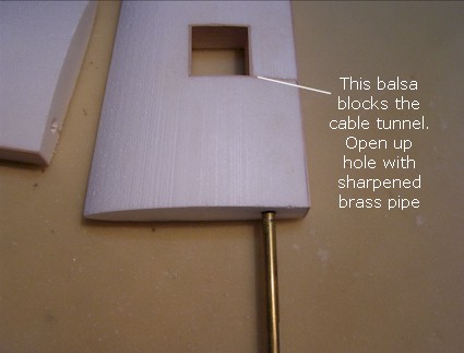

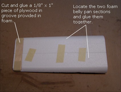

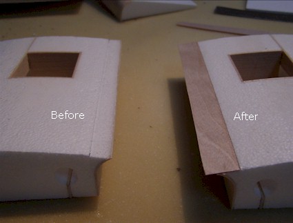

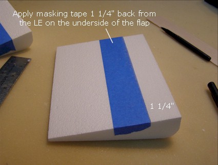

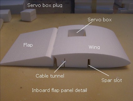

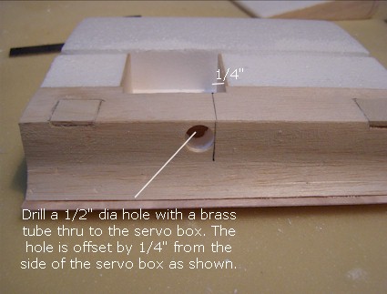

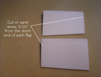

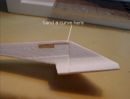

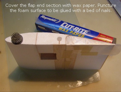

I worked on the assembling the outboard flap panels. The construction is identical to the inboard flap panels. Next I can start on the two outmost aileron panles.
Fahim
ID:	1458693   Click image for larger version
ID:	1458694   Click image for larger version

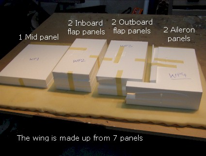

Hope you are all enjoying the build? I need to mention a couple of things at this stage.
I try to design my kits such that the novice builder can easily build them, or the expert builder can easily modify them. For example, this kit is designed with slotted flaps. It can be built for slotted flaps as shown in this build. Or if less complexity is desired desired, simply glue the flaps to the wing, fill with putty and sand the joint, and we have a flapless model. If a more complex Fowler Flap is desired, simply sand the hinge face to a Fowler profile, or add balsa and sand to create a Fowler hinge profile. In other words, this is not the only way to build my kits.
My design objective is to give you a "scale as can be" basic platform, and empower you with the freedom to suit your own skill and imagination. Trust me, you will not hurt my feelings if you don't follow my intructions to the book.
The second point is that a foam model looks kinda rough during the building stage. Be patient and don't get frustrated, when we get to the finish stage, it will look nothing like that.

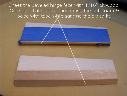

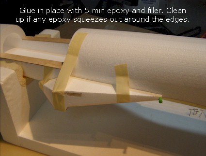

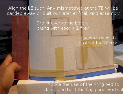

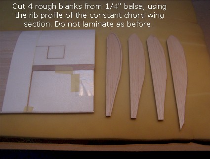

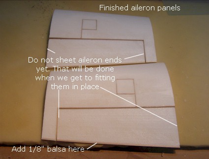

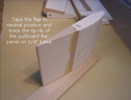

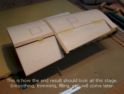

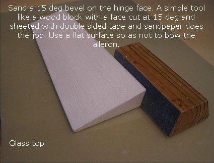

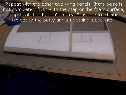

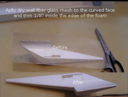

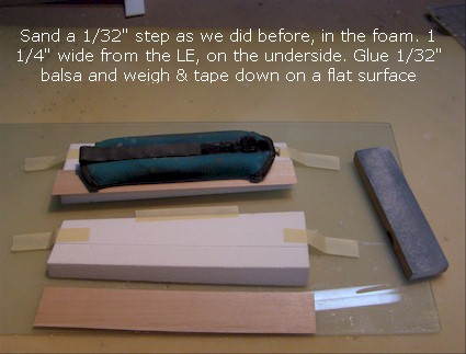

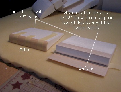

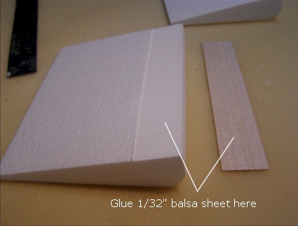

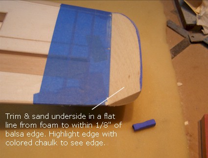

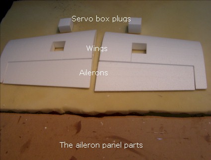

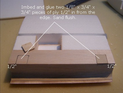

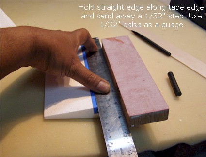

Continued with the build. I assembled the aileron wing panels next.
A side comment on the use of epoxy glue. Use is as sparingly as possible because it is one of the heaviest part of a foam model. I looked at the A & B part bottles I am using and each weighs 9oz. That's 18 oz (over a lb) of dead weight added if I end up using a whole bottle set. I waste a lot but still that's a lot for a 10 lb AUW plane!!
Now we can join the two outboard panels together with a samll fixed wing section between them as shown in the full sized picture.
Fahim

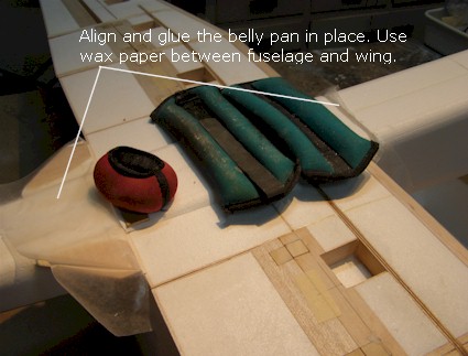

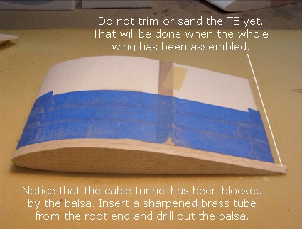

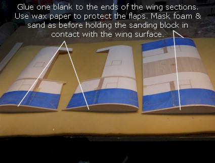

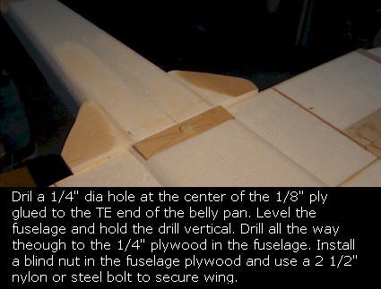

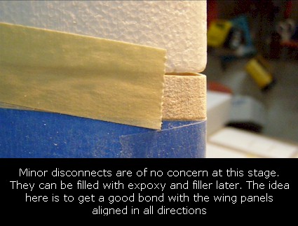

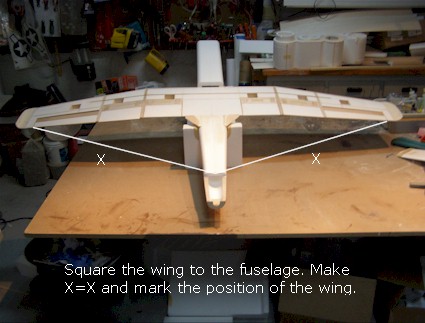

Next I joined the two outboard wing panels together with a small fixed wing section in between.
BTW, I am not sure why the size of the pictures has changed. Must be something in the RCU server.
Fahim

Now that we have the 3 wing panels, it is time to assemble the whole wing.

I worked on assembling the whole wing today.

I cleaned up the TE by temporarily taping all the control surface in their nuetral positions, and sanding in a straight line using a stick sand bar.
Then I worked on the Horner wing tips.
Fahim
Progress is a little slow because we have the grand kids visiting us and I get to teach them how to build a model. Man, the questions are driving me nuts.
Anyway, I was able to get the wing mount done today. At this point, we have a fuselage and a wing structure rough finished. I can now move on to the tail.
Fahim
