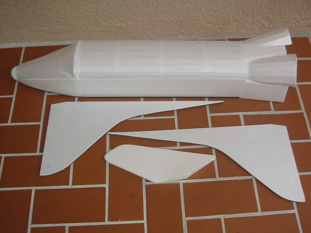

Yes, this is not your ordinary EDF JET but, it will be powered by an Electric Ducted Fan unit of 64mm and 4-Cell, Li-POLYs.
A friend "gave" this model to me and I will be enhancing it to allow for:
1. Wing Airfoil to allow for better lift and Glide Slope qualities.
2. Adjust EDF location to allow for a more forward Center-Of-Gravity.
3. Adjust the Main landing gear to allow rotation on Rise-Off-Ground (ROG).
4. Incorporate some cheater holes on each side of the FUSE (more like recessed panels going inwards) right in front of the EDF.
This model is not available by anyone and it was a (in my opinion) failed project gone bad due to the lack of communication between the designer and people he involved himself to make the airframe.
As an Aerospace Engineer working at Kennedy Space Center and who have worked on numerous Avionic systems on the Space Shuttle, I dislike many items on "As-Is" model given to me, however, in honor of the Space Shuttle and it's enormous contribution to USA and the world partner counties, I am going to "attempt" to save this model and have it fly in a manner that will honor it's name! There is another person posting his review on the "AS-IS" model and will be posting it's flight characteristics which from his accounts are very poor.
I am not looking for anyone to come here and discuss PAST HISTORY and notice that I am not naming any particular outfit or other names here so, please resist coming here to discuss any past history accounts!
Attachment 2237859

Rise-Off-The-Ground means rolling off a smooth hard surface as this model comes with landing gear. It is a EDF not a Solid Rocket model so, no....it will not be launch on a verticle pole:D
The picture I posted is a very early one and the model is already assembled and tonight, I will post the almost complete model.
It has already been glide sloped tested and it is super light and floated in very nicely after careful C-of-G adjustments.
The Flat Airfoil really stinks as you need RAW power to keep it in the air and I just don't like how it flys, if you can call it that.
Stay tuned.

guapoman2000 09-22-2010 09:06 PM
RE: Space Shuttle Depron RC Model - Scratch..
Hi Guys!
Today, I was not feeling 100% so, I stayed home and right about late in the afternoon all rested and energized I went right into the Space Shuttle Project.
First, I took out my notes from what I disucssed with Mark (co-worker, real pilot and Flight Crew Engineer Member) about the Airfoil top location, slope and other technical data about Wing Airfoil.
For a scale off of 26 inch wing span the top (highest point) should be a little more than one (1) inch but, I really did not want to create too much drag so, I decided to use no more than 3/4 of an inch as the highest point where the top wing assemblies would rest and this highest point is a few inches behind the Center of Gravity mark.
Okay, here is a few pictures showing the progress and I am happy to announce that it is looking like the Space Shuttle.

guapoman2000 09-23-2010 12:29 AM
Hi there again guys!
Could not sleep so, went back to finish the leading edge gap openings on both wings using left over 5mm foam board material.
Some 5-minute epoxy and then, a little sanding is all that was needed.
Of course, I plan to use some ORACAL 561 intermediate Adhesive Film to dress up the entire leading edge of wings.

guapoman2000 09-23-2010 06:25 AM
Well,
I finally finished the Airfoil Wing Modification on this "AS-IS" EDF Space Shuttle Model that was given to me.
Note that I used ORACAL Intermediate 651 Cell Adhesive Film for the Leading Edges to hide the imperfections that light Sanding could not take away.

Speaking of Steerng, I have completed the Nose Wheel Steering for this Space Shuttle "AS-IS" model. A few of you may know where I took it from and none other from the FMS Large EPO P-51D Mustang 57-Inch Wing Span (Foamie). I took the Tail wheel assemly out from the AirFrame ONLY version that I had lying around and dissassemble it to remove and rid of the Heavy Plastic housing and usig the Strut portion and installed a new Servo for nose Wheel Steering. I inserted the entire assembly into a custom FOAM housing as this saved me a little over 1 oz. of weight because I did not use the heavy plastic housing that comes with this tail wheel assy. I am just super pleased in how it all came in place and Made a Video of it in action. Oh, the Nose Wheel has two wheels using a T-Connector setup, I made this custom on my own!
Since I took the bottom FUSE piece out in order to install the nose Wheel steering assembly, I have gone to make a DUCT from all the way in the NOSE (Where the Reactive Control System - RCS) is located as this is a line of sight into the EDF! I am making a housing to be glued from the inside where Four small (1/2 inch each) holes where made at the frontal FUSE to be used as a collector intake (inrush) feed and one single tube being attached to this collector. An extension tube(s) will be secured with foam formers and this will make the Space Shuttle "AS-IS" Model into the close feed setup like the F-86 EDF Jet, one solid feed into the EDF will greatly enhance the efficiency!
I have also made my own Main Gear struts and used strong yet thin and light weight wire and the only wheels that I found to spin without a Whobble was some old GWS 1.5 inch diameter wheels. The supplied wheels are just too small and the red plastic insert made them whobble something Ugy! The Wire for the Main Gear was a JOKE! I threw them away in a hear beat!
I am still working so, I will upload the Video and lots of Pictures later as I do not want to slow down with the PROGRESS!
Carlos
guapoman2000 09-27-2010 01:14 AM
It has been a Marathon "Scratch Build" Session over here in Orlando, Florida! All this including detailing my car myself, fixed a few things around the house, went out to get more food etc..! I even flew Sunday morning with my Sky Bro, Gerry (Simano) who came to the House the looked over the Space Shuttle.
This model was given to me by Gerry which came with lots of Dupro Products to complete it.
Well, I would not use those Plastic Bullet style Hinges as this "is" a foam model and I have used Computer Floppy disk material with great success in the past and no dfferent now!
http://i733.photobucket.com/albums/w...0/IMG_4586.jpg
Now, while the hinge material cured, I wasted no time and make he necessary cutting into the Foam to install some E-Flite 60 Servos I had lying around!
http://i733.photobucket.com/albums/w...0/IMG_4579.jpg
http://i733.photobucket.com/albums/w...0/IMG_4581.jpg
Using 3M Double Sticky Tape made things very easy!
http://i733.photobucket.com/albums/w...0/IMG_4583.jpg
Finish Prduct, No messy Push Rods inside the FUSE etc...etc...
http://i733.photobucket.com/albums/w...0/IMG_4584.jpg
guapoman2000 09-27-2010 01:33 AM
Guys,
Other Dupro hardware that came with this model was some really small yet very light Control Surface "HORNS" and these just go in with glue. I am use to control horns that come wtih screws and back plates! Those tinny tiny plastic control horns went quickly to the Garbage!
I took my Control horn hardware from a "used" StarMax F5-E EDF Jet:
http://i733.photobucket.com/albums/w...0/IMG_4597.jpg
Here is the final Product, I just love back plates and metal screws, it is worth the weight for piece of mind!
http://i733.photobucket.com/albums/w...0/IMG_4596.jpg
guapoman2000 09-27-2010 01:46 AM
Okay, now for the creative stuff!
Since I had decided to make a "Duct" for this model to make it as close as possible to "other" EDF Jets such as the F-86 and others then, I really had to pay the Tax man and go at it like I really mean it and I did!
Since I had removed the Lower Frontal Section of this model for the Steerable nose Wheel then, I went to create formers / bulk heads to force (Direct) the Air Flow into the FUSE and in order to do this was by creating directional bulk heads with this Crew Cabin!
http://i733.photobucket.com/albums/w...0/IMG_4587.jpg
Closeup of Directional "Air" Bulk Heads Showing it all complete with the Extension for the Nose Wheel Steering servo:
http://i733.photobucket.com/albums/w...0/IMG_4590.jpg
guapoman2000 09-27-2010 01:58 AM
Speaking of Nose Wheel Steering, here is two pictures of the complete assembly!
http://i733.photobucket.com/albums/w...0/IMG_4612.jpg
http://i733.photobucket.com/albums/w...0/IMG_4611.jpg
Another problem I had was the tiny rectangle base for the Main Fixed Landing Gear, that Black Foam will rip in a Heart Beat should you come in a little hard "or" at the first hard landing so, I cut out some 1/32nd quality Light Plywood rectangle from Mid-West products. Oh, you can see the final Elevon Setup as well !
http://i733.photobucket.com/albums/w...0/IMG_4613.jpg
Final Main Landing Gear Setup, notice my custom wire and wheels from GWS (1.5 inch diameter)
http://i733.photobucket.com/albums/w...0/IMG_4616.jpg
