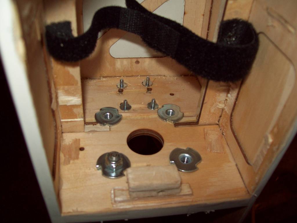

one question buzz. Do you run it with the BEC or do you use a seperate pack for your reciever? Also i have seen other guys on the forums do this conversion and i was wondering if you know where I can find an adjustable motor mount for the motor you recommended?
Old 08-27-2011 | 07:09 PM
Joined: Jun 2002
Posts: 3,717
From: high deserts, CA
Default RE: Batteries
Well, I use the BEC that is in the ESC. I am running 4 servos, and when I have it in glider tug setup it is 5 servos and have not had an issue so far.
I just used stand offs, threaded rod, blind nuts and nylok nuts to mount my motor. I used "PEX" tubing from Lowes. It is something like 5 feet long and is about $5.00

Buzz, you have been more help than I could have possibly asked for. Could you do me a huuuuuge favor and give me the specs on all that hardware you used to make you motor mount? I really appreciate all the help you have cleard up a lot of the muddy water. I'm currently overseas with my unit(I'm in the Army) and as soon as i get back I'm going to get started working on this project. Thanks again man.
Also how do you center the electric motors? I'm a little fuzzy on this got any advice?
Old 08-28-2011 | 08:38 PM
Joined: Jun 2002
Posts: 3,717
Well, you being over seas has been more help to me then I could ever give you in return!!!! Thank you for being there for all of us.
I used (4) 10-32 threaded rod 12 inches long. Blind nuts are (4) 10-32, (4) #10 fender washers, (8) 10-32 nylok nuts.
I needed for of the threaded rod because mine were just over 6 inches, so I could not get 2 out of each piece.
In the picture, the hole is to center the fuel tank. I just used that as a reference point. You can draw a center line vertically and horizontally to fine the center of the firewall and start there.
Post any questions you have and I will answer as best as I can. If not I know some one on here has the answer.
